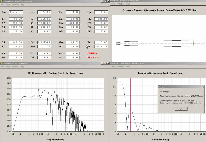

Just some food for thought: When messing around in Hornresp with the 6.5" Tang Band W6-1139SI Erik (Volvotreter) recommended (Post #1085), I noticed that a grouping of 8 makes for a very high output tapped horn of about the dimensions Ian (iand) is looking for. With the current PartsExpress price of $29.– ea. that seems almost like a reasonable thing to try.

Tapped horn simulation vs. measurement
I feel you're still missing the real point, which is that -- regardless of what realisation problems a design does or doesn't suffer from -- it can't ever do *better* than simulations (*if* these are accurate), only *worse* -- accurate simulations give an upper bound on performance.
So *if* Hornresp is correct (and I've repeatedly questioned this) neither type of box should be able to *exceed* the predictions for efficiency and maximum output, only fall short -- any losses and imperfections can only decrease SPL and increase excursion.
I've also pointed out that in spite of considerable trying I can't get results for either efficiency or excursion which agree with those in Tom's white paper on the TH-115 -- which are of course simulated, in spite of the fact you don't seem to believe in this. I'd also like to point out -- yet again! -- that he says that the tapped horn and reflex have similar efficiency when both are optimised, not that the tapped horn is higher 🙂
Hornresp parameters I'm using are:
S1=285 (3:1 CR) L=20/280/20cm (all exponential) S3=2400
-- exponential instead of conical gives less ripple because mouth area is bigger for required length, no other way to get low ripple close to measurements
-- added 1.3mH extra series inductance to match impedance with measured -- also reduces ripple

I'm absolutely *not* calling Tom a liar or doubting his measurements, Danley are by far the most honest provider of measured results that I know of -- but in that case I can only see 3 possible conclusions:
1. There's a much better tapped horn solution lurking in the same sized box (320l net) with the same driver (15TBX100) which I haven't found yet (but I'm still looking)
2. Hornresp is underestimating the efficiency of a tapped horn by up 3dB
3. Tom has some special "secret sauce" design tweaks which he's not telling about
==> Since I assume everyone here is interested in designing and building tapped horns which behave how they expect, I think it's kinda important to find out what the explanation is.
Excursion and maximum SPL
The tapped horn white paper shows a peak excursion of 6.1mm at 47Hz with 63V applied (500W/8 ohms); with the 15TBX100 mathematical Xmax of 9.5mm this means 1200W power handling (98V applied) before Xmax is exceeded. At 101.5dB/w this would give a maximum SPL of of 132.5dB, which agrees closely with the TH-115 data sheet.
Hornresp predicts a peak excursion of 14.8mm at 47Hz with 98V applied and an SPL of 130.9dB -- note that the impedance curve frequencies of maximum and minimum excursion are very similar to the TH-115, so the design can't be that far off.
This difference is even more worrying than the SPL one in many ways -- the SPL difference just means the output will be a bit higher than expected (which is good!), but the excursion difference has a radical effect on the design:
-- if Tom's figures are correct and Hornresp is wrong and you design a tapped horn using Hornresp, you'll end up using drivers with much higher Xmax than is actually needed -- this could make finding suitable drivers difficult or at the very least expensive (TC PA-5100)
-- if Tom's figures are wrong and Hornresp is correct then tapped horns don't handle as much power as you'd expect unless you use drivers with very large Xmax -- drivers with 9.5mm Xmax are easy to find, drivers with 15mm much less so.
==> Again, since I assume everyone here is interested in designing and building tapped horns which behave how they expect, I think it's kinda important to find out what the explanation is.
Why we (diyAudio people) need an explanation
Tapped horns are pretty much impossible to build via trial and error because they are much more sensitive to a larger number of design parameters than a.n.other box, and it's almost impossible to guess whether a particular driver will work well in a tapped horn or not -- again, in contrast to other designs -- and what to do if it doesn't.
So if we want to come up with decent tapped horn designs, we all need a simulation tool which can predict the performance with reasonable accuracy -- but right now it seems there are considerable differences between simulation (all simulators) and real life with regard to efficiency, excursion and maximum SPL.
I suspect the only person who can shed further light on these inconsistencies is Tom, since he certainly knows far more about this then anyone else.
Cheers
Ian
That does indeed look like a good design, though with lower efficiency (results are in 0.5*pi) and too much extension compared to my target.
If the real SPL is higher and the real excursion lower than the Hornresp simulations you could say that either:
1. this is a good thing (peak power handling would be even higher without exceeding Xmax -- if you've got a big enough amplifier), or
2. this is a bad thing because lower Xmax drivers might have given higher efficiency and therefore higher SPL for a given amplifier
Using large numbers of smaller drivers like the Tangband can be an excellent idea compared to one big driver if the cost and power handling are comparable -- it's often better to have several lower power drivers, ones rated at 1000W or so can physically handle these power levels but the resulting power compression can be higher than lower power drivers which don't get quite so hot.
If only we knew what "optimum" drivers for a tapped horn looked like for different cases (box size, cutoff, power handling) and could rely on simulation results to predict SPL and excursion, designing good tapped horns would be *much* easier... 🙂
Cheers
Ian
