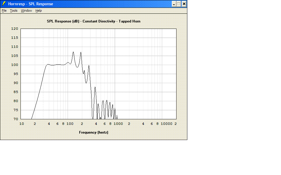

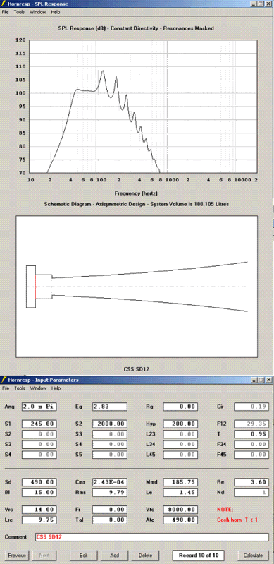

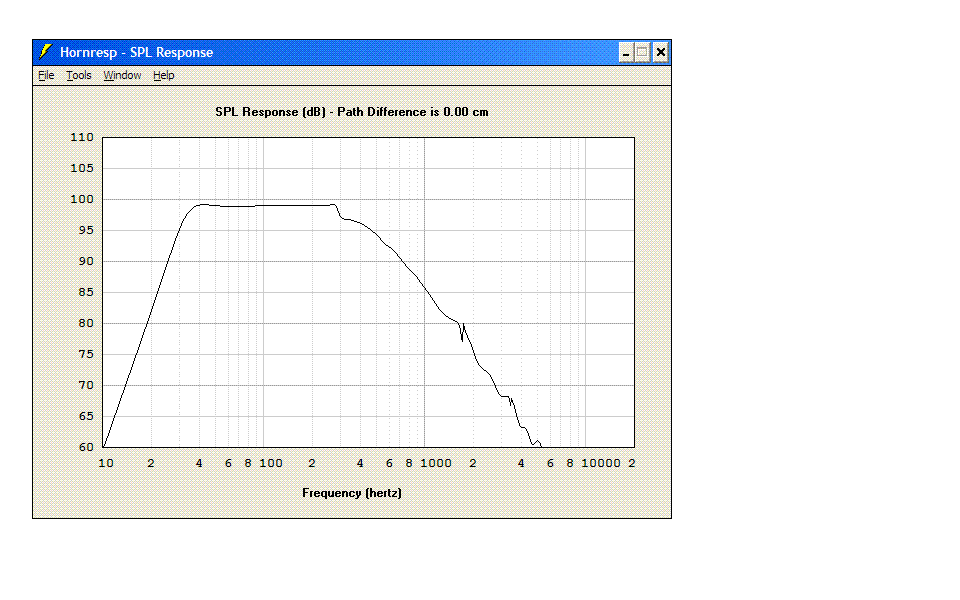

If I could find an easy way of grabbing a snapshot of the Hornresp results window and posting this to the forum I'd be glad to do so -- any advice on the best way to do this?

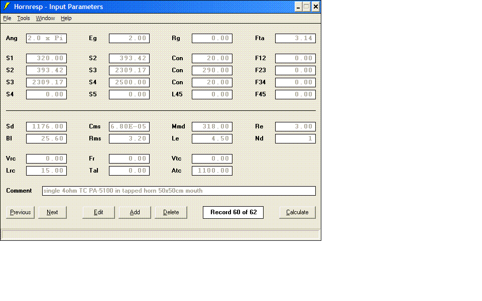

tb46 said:iand: Hi Ian, would you mind posting the Input Parameter pages for your optimized designs? This would make it easier to duplicate your line of thought. Anyway, it might help a feeble mind like mine.

iand said:That gives me a whole screen (1920x1200) -- is there an easy way of just capturing the Hornresp window?
Ian
Ahhh, you meant <ALT> <PrtScr> not <CTRL> <PrtScr> ...
Ian
Ian
Let's see if this works...
Re: TH v. Bass Reflex
Tapped horn parameters
