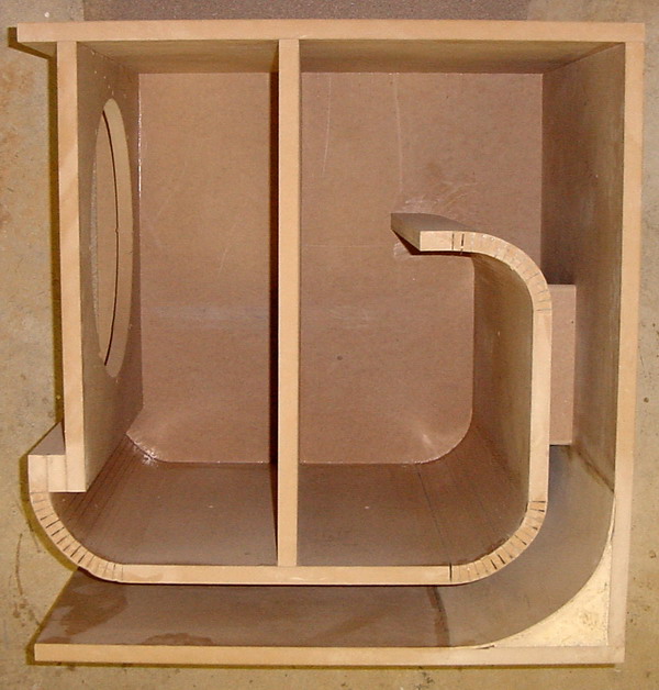

TH v. Bass Reflex
iand: Hi Ian, Thanks for the screenprints, that will give me something to look at. You may also try downloading the free Gadwin PrintScreen utility, it gives you additional capture features.
Actually, I feel that William Cowan and Tom Danley have already answered the question you posted, but, I'll see if I find anything useful to add (low probability).
djk: Thanks for helping with the screen capture.
cowanaudio: Post #1222: Now, that's a duct, nice woodworking.

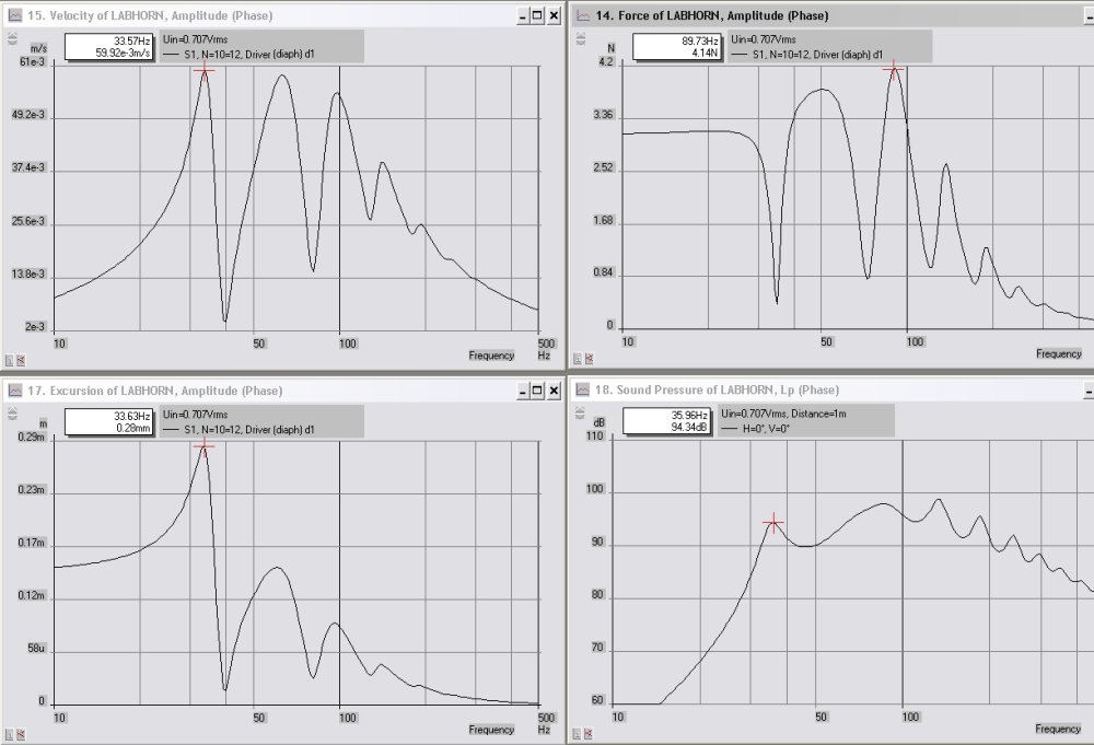

Hi William, i thought about this and searched in the lab forum archive for information. I found a post by Tom, concerning the throat distortion in the lab and bt7. First of all, just like you said, throat distortion in a basshorn seems to be no issue, even with such extreme designs as the bt7. the problem is the one you mentioned, that the driver can get torn up.
The strain on the driver and throat distortion is proportional to the driver velocity, which Tom pointed out in this post. The equation "velocity = excursion * frequency" describes the velocity. We see, that velocity rises with frequency and excursion.
One could take the labhorn as an example for what strain is acceptable. It seems to have a compression ratio of around 3 and can be used to around 100hz - judging from the response, maybe up to 200hz - but i dont know the exact numbers. With this information together with the fomula v=x*f we can get maximum compression values for horns with different xmax and cutoff. The cone stability has obviously a place in this equation, but i think one can assume that two high quality drivers with about the same cone weight will have about the same limit here.
For example, a horn with 50hz upper cutoff, which is about half of the labhorn and the same xmax as the lab could have a compression which is twice the labhorns compression. Another example which could accept the doubled compression could be, that we want the same upper cutoff of 100hz, but limit the excursion to the half, since we only want to use it in a home environment.
Following this, i would say, if we choose the right constrains, such as low cutoff or spl, we can build horns with compression ratios of greater than 3. I have simulated a TH with a peerless xxls 830842 with a compression factor of 6. The constrain could be to limit it to frequencies lower than 50hz. This design easily scales to lower cutoffs (i would really like to hear/feel a <20hz sine wave 🙂 ) by adding horn length to each horn and increasing the number of horns.

Hi William, i think i assumed a constant horn load on the driver over all frequencies, so to speak an ideal horn with a flat frequency response. As the horn unloads the driver in the low frequencies and becomes acoustically invisible, the strain will be even lower.
Lets say we have this perfect horn and a 10:1 compression ratio. Imagine you push the cone to its xmax limit with your hand and hold it there. This will not strain the driver. Now imagine making the compression ratio higher to maybe 50:1 and and doing the same. Nothing will strain the driver, as long as you push it slowly enough. This is a simulation of a near dc signal. With such a big compression ration, imagine pushing the cone in and out periodically. The strain might increase a little, which you could feel as a force, which opposes your pushing, as the frequency rises.
Here we have an example were one can see that the force on the driver rises with frequency, excursion and compression ratio. One could make a pseudo equation like "strain = excursion * frequency * compression ratio". Because frequency * excursion = velocity, we can write "strain = velocity * compression ratio". Now lets take the drivers construction into account. My assumption has to be that the drivers robustness is proportional to its cone mass. Then you can write "strain = velocity * compression ratio / mass".
Your example of two same polarity drivers works very well with my pseudo equation. The compression ratio for such an example would be very high, thus you have to keep the other factors (excursion and frequency) low, to prevent damage. If you have very robust drivers, you could increase velocity a little, as it can stand more strain.

Pressure/Force
A few ideas floating around the topic of maximum compression ratio.
The cone can fail when the unbalanced force on it becomes too large.
Two scenarios come to mind:
a) pistonic: when the limit is the strength of the weakest ring of the cone (probably fails around an arc then tears outwards (seems quite common from pictures of cone fractures)
b) modal: when an air mode (or at higher frequency a cone mode) leads to too-great shear about a nodal line (probably less common, requiring an "error" in design - but I can think of one or two ways it could be accentuated).
AkAbak can tell us the overall force (or equivalently pressure) on the cone. That should be good enough to hint at potential problems. A few (not very systematic) tests show that, in slightly different THs and looking around 30-50 Hz, the force can vary drammatically for very little change in the efficiency.
I'm not sure where to expect failure, but >>100N forces starts to get a bit scary, I guess.
That - with some experience and trusting AkAbak- should cover a). Probably b) is a relatively minor problem except in a particularly poor design (unless I'm missing some obvious case).
If I had an AkAbak Lab-sub model I'd make some comparisons, but I don't - I agree that is a good reference point.

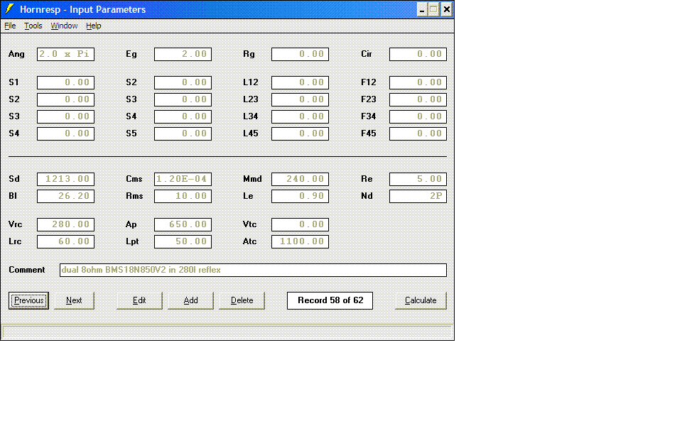

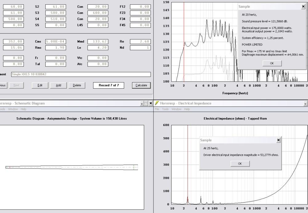

Hi William
What was the predicted port velocity in your 250l/22Hz (actually 150l + 100l port) box, and was the port flared? There's some disagreement about the allowable port velocity for low distortion/compression, the box I proposed peaks at just over 20m/s which is below most recommendations, but may still have some compression as Tom said -- I'd still like to know how he calculated those figures 🙂
I'm not surprised you could beat the 18LW1400 in a 150l 22Hz reflex with a tapped horn, it's parameters are *way* off the optimum for a box with this size and tuning (Xmax is *far* too low, Sd is too high). The Seismic 8196 I've got in a 450l 25Hz box right now is rather closer to optimum but still some way off.
The BMS18N850V2 in a 140l 32Hz box (or a pair of these) is very close to the best that is theoretically possible in a reflex (just the right balance of BL/Mmd/Xmax to be thermally and Xmax limited at 1200W) -- which is why I'm asking if *this* can be beaten by a tapped horn, not something which is nowhere near optimum.
Of course any sub will have higher output against a wall or in a corner, not just a tapped horn. But this isn't a choice you always have when playing with a band, the PA has to go where the venue allows...

Hi kstrain, I didnt think of akabak at all, so i need to investigate this. If akabak can model (a), then all my previous thoughts are rendered useless in a good way. I think (b) is not important in a TH, since we are way out of the area of cone resonances.
A model of a Labhorn wouldnt be too complicated to script. Do you have a link handy, which shows the internal diameters as a function of distance from throat? If not, i could try to calculate them from the prosoundweb labhorn documentation. Other subs could use the data as a reality check then.

Re: Pressure/Force
You don't need any complicated modelling or mathematics -- we're not operating in the mass loaded region here so the force applied to the cone by the coil through the former is just BL*I, and if the cone's not moving (or not much) due to the enclosure (whatever type) this must be balanced by pressure*area.
With 1200W/8ohms nominal drive level at the impedance minimum (resonance) the current would be something like 22A peak, which with BL=25N/A means a peak driving force force of about 55kg at the coil former, with a similar counterbalancing force spread over the whole area of the cone.
With big drivers (18") with thin cones it's hardly surprising that they rip themselves to pieces. With smaller (12") drivers with very strong cones (LAB12, Ciare12.00SW) this should be OK -- a 4" coil on a 10" cone only has 3" of cone offset outside the coil.

Re: Re: Pressure/Force
In most well damped TH models I've got (I'm working on a 20 to 60 Hz design) the two force peaks are just a bit below the corresponding zero crossings of the phase of the impedance (e.g. 18Hz and 52 Hz in one case). If I was worried about this I think I'd be more concerned about the upper peak with most music, although the peak force for a given input is just over half of the lower peak.
Since I was in any case using AkAbak (as well as Hornresp) the force calculation came free.
I'd not looked at the force very seriously (just giving it a glance from time to time) until reading this thread this weekend (I'm not going to play music loudly enough in my room to rip a cone even with "high compression", even if I actually get round to finishing a TH eventually) .
Ken

G'day again Ian
It had a Vb of 250L, not 150L. The volume occupied by the port must always be taken into consideration, especially when the port is this large. The port had a huge flare on both ends, it was a 100 or 150mm radius, from memory (see the picture posted above). Predicted port velocity was ~30M/S at 800W.

cowanaudio said:G'day again Ian

Hi all, i modeled a quick labhorn, took the data from this page:
http://www.geocities.com/hulkss/LABsub3.html
(used the labv2 data, which is like the original, as the guy says.)
Script is this:
Def_Driver 'Lab12'
Sd=507cm2
fs=22.1Hz
Qes=0.39
Qms=13.32
Vas=125L
Re=4.29ohm
Le=1.48mH
system 'S1'
Driver 'd1' Def='Lab12' Node=1=0=10=12
Driver 'd2' Def='Lab12' Node=1=0=11=12
Enclosure 'E1' Node=10 Vb=17L
Enclosure 'E2' Node=11 Vb=17L
Waveguide 'H1' Node=12=13 STh=540cm2 SMo=700cm2 Vf=20.6L Len=20cm Conical
Waveguide 'H2' Node=13=14 STh=700cm2 SMo=769cm2 Len=30cm T=1
Waveguide 'H3' Node=14=15 STh=769cm2 SMo=2580cm2 Len=150cm T=1
Horn 'H4' Node=15=16 STh=2580cm2 SMo=5800cm2 Len=79cm T=1
Results are attached. Now i only need to gain the knowledge on how to interprete them correctly, and maybe i should make a simulation with full excursion, but i was too lazy right now.
