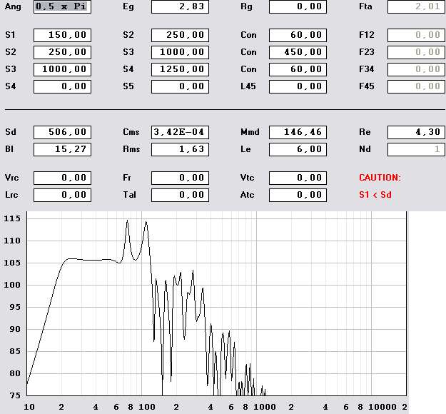

Hi William, as usual, your comments help me alot 🙂
Using 1/4WL resonators in a TH is something i would not have thought of. Same goes for using an inductor, as i have no clue about passive components.
With the new wisdom, i made an attempt to simulate the DTS20 under the assumption, that the driver is a lab12. It looks like one and with Tom being the inventor or the dts20 and labhorn, this assumption lies close. The simulation is attached. The volume of the enclosure seems to fit the size of the dts20. The fact that my simulation has two big peaks and the dts20 has two resonators is indicating some similarity between simulation and real speaker.
And if its not the dts20, its at least a nice 20-60, maybe 100, hz labsub TH 🙂

Hi MaVo: Looks like you added the series inductance to the Le field in the Hornresp input screen, and that is what helped smoothen the response. To be correct you may have to add the resistance of the series inductor to the Rg field.
Maybe David McBean can comment as to whether or not that approach works with his model?
Yes, i thought that i needed to add resistance, since William also spoke of it, but i dont know how much. As i said, no clue about passive components. Can you give me an equation for this? With added resistance, the horn also needs to be changed. I hope the influence wont be serious 🙂

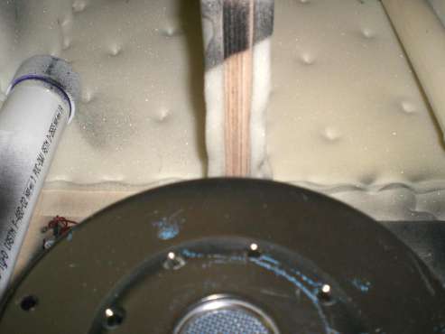

To filter out-of-band resonances, one can use a compression chamber as a high-pass filter, both on the rear and front of the driver. (I'm tinkering on an AkAbak script for that.) Also, those 1/4WL resonators seem te be connected to the front baffle of the driver, rather than separate tubes. This makes me think they could be bass-reflex-like tubes. (Another thing for later, as a short tryout seemd to be promising.)
They are not BR tubes, since they are closed on one end. Ill add a picture which shows that. The open end seems to be right besides the front membrane of the driver.

As far as Hornresp is concerned, increasing the values of Le and Rg (and/or Re) is the same as placing an inductor and resistor in series between the amplifier constant voltage source and the driver.
Kind regards,
David
