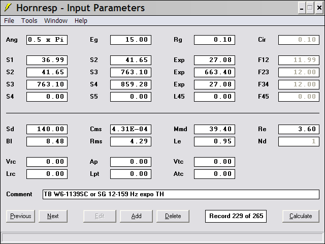

Chris8sirhC said:
Do you think that typical room gain would flatten out the response of this design to 20hz or so? If so, could you post dimensions for this design? Also, what drive is that?
I've only measured one room with the near ideal gain required to completely flatten this one, but even if it only adds the ~4 dB of my room that's still almost 120 dB/m once EQ'd flat with plenty of dynamic headroom in the mid-bass for bass guitars, drums, organs, etc., so no need to be greedy. 😉 Of course two and double power gets you another 3 dB.
15 V to 12.29 mm/18 Hz, so ~56 W.

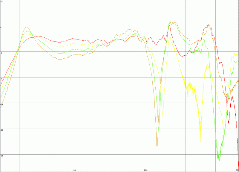

G'day kstrain
I think you touched on the truth in your post. Almost everybody here is showing graphs of modeled responses. The measured responses are usually smoother, most likely to do with the unmodeled losses you mentioned. Have a look at the red trace in this plot. It is the real measured unsmoothed response of a tapped horn. It shows out of band response peaks, but of a much lower magnitude than some of these models would suggest. BTW the plot is 6dB/div. so the 1st and second peak are about 3dB high.
Just do the tapped horn and don't procrastinate. If the design is sound, you'll love the results.

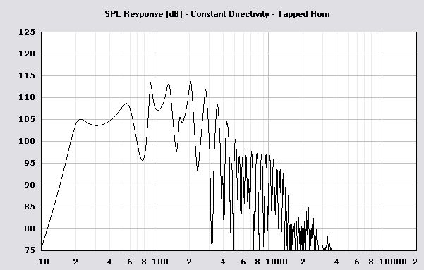

Would this sound good up to 200 or even 300hz? The response seems to be very smooth. Is there a reason, not to use it up to its upper acoustic cutoff?
Re is 5, i accidently cut it off. The driver is 18 Sound 15LW1401.
Partly answering my own question...
There could be a resonance due to the long unfolded straight horn paths. Will the resonance occur at pathlength = wavelength/2 (for example 1 meter of straight horn has a resonance at 344m/s / 2m = 172hz) ?
I am inquiring this, because im currently searching for a woofer, that can cross at least at 130hz, i wouldnt mind 200hz and goes as low as possible.
Tapped horns with rather big mouths and an exponential flare, such as the TH115, seem to be really well damped and usable for higher frequencies.
Parameters of woofers that work in those things are:
qes around 0,3
fs 40-45hz
vas depends on woofer size, around 50 for 12" , around 100 for 15"
qms doesnt matter much
The Beyma 12P1000ND and 15P1200ND are such woofers.
(thanks to cowanaudio for throwing in those woofers and to GM for modelling all those THs, both of it got me thinking about this)
