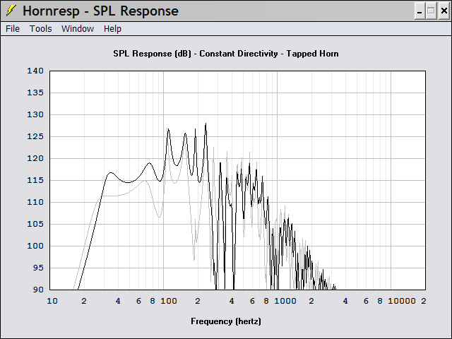

This is the design:
This is the theoretical SPL at 20V where Xmax (11.5mm !) will be reached.

This is the design:

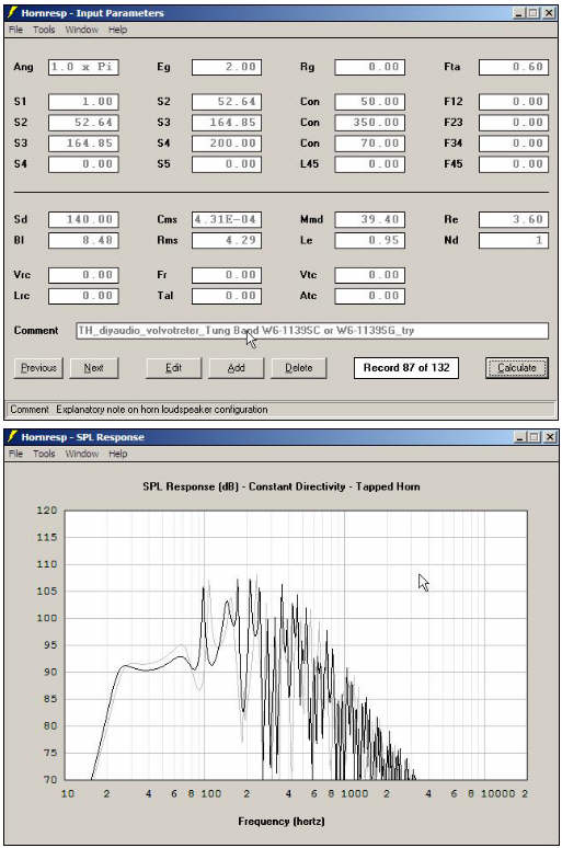

Hmm, the larger the horn/mouth the more balanced the damping is on both sides of the driver, though one side is under high pressure while the other is damped by a high acoustic mass, so I see no reason why a small mouth horn sim would be more accurate than a large mouth one.
GM

Actually only ~47 L, making the tiny 77.4 L conic TH ML's math calc'd seem huge by comparison, though of course it has more gain BW:
GM

FWIW, I didn't bother to research any differences between these, but inputted differing specs for the SC,SG,SI models including some measured specs and they all superimposed so close in one of my sims that I had a hard time seeing any difference, so are all interchangeable AFAIK.
GM

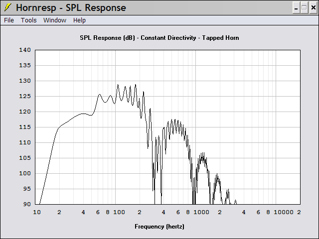

TangBand WQ8-1071
Hi everyone.
I tried to simulate in HornResp but i don,t get it..
Could anyone give it a try? and se how large the box would be?
This is for the TB W8Q-1071 driver. 🙂
http://www.tb-speaker.com/detail/1208_03/w8q-1071d.htm
Thanx
/JZ
