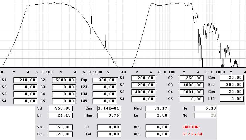

I am wondering, in which kind of implementation the tapped horn has the biggest advantage in comparison to a similar sized frontloaded horn. for example, i modeled a 40-300hz horn of both kinds, both use the same driver, have the same +-1db frequency response, the same volume, maxspl etc. here, using a TH has no benefit. can you show me cases where a TH is better (lower cutoff or more max spl or more linear response etc.) per volume than a normal frontloaded horn?
The attached picture shows both.

tb46 said:
Hi MaVo: I think Tom Danley pointed out, that the main benefit for the tapped horn is size reduction. Bye the way, what is the speaker you are modelling?
This speaker was just a test, nothing i would build. I am still researching what kind of subwoofer will be the best for my listening preferences.
Yes, Danley said that, but as my example showed, the size reduction is not allways there. There have to be some paramter combinations, where the TH benefit over a normal horn is maximised and i want to know which that are.

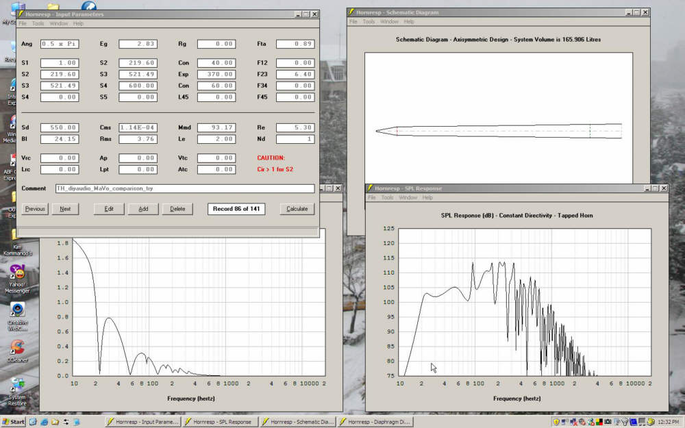

tb46 said:
Here is a quick re-model.🙂
Thats not really comparable, as i used 2 drivers and you one. But your example shows, that one is sacrificing the midbass smoothness for a smaller cabinet. Perhaps this is the direction in which the optimum performance of THs lies, as narrow bandwidth (2 octaves) low frequency transducers. The more you approach the normal frontloaded horn geometry / size, the more bandwidth you gain and the smaller is the difference between TH and normal horn.

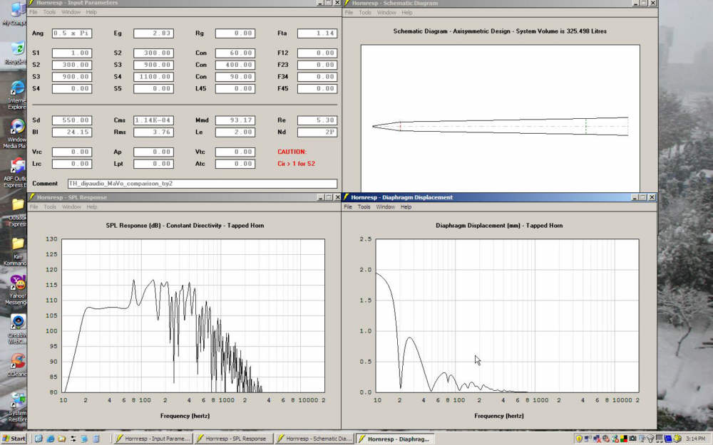

Hi MaVo: I agree it is obviously a subwoofer. Sorry for overlooking the dual drivers. Here is an example with 2 drivers, and with some more work the size can probably be decreased a little more, but this is already quite "small".
Thanks for the participation tb46, it seems - as you pointed out, that the interesting thing in THs is the ability to make the compromise of having a smaller bandwidth and getting the bonus, that a smaller volume can reproduce it with good response, all in comparison to a normal horn.

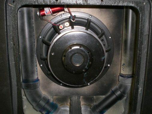

G'day MaVo
They are resonators tuned to the same frequency as the first few response peaks. You'd probably find that each branch is 1/4 WL of each peak in question. The ~5mH series inductor flattens the response and removes some of the higher frequency stuff (It's DCR doesn't hurt in many cases, too).
Cheers
William Cowan
