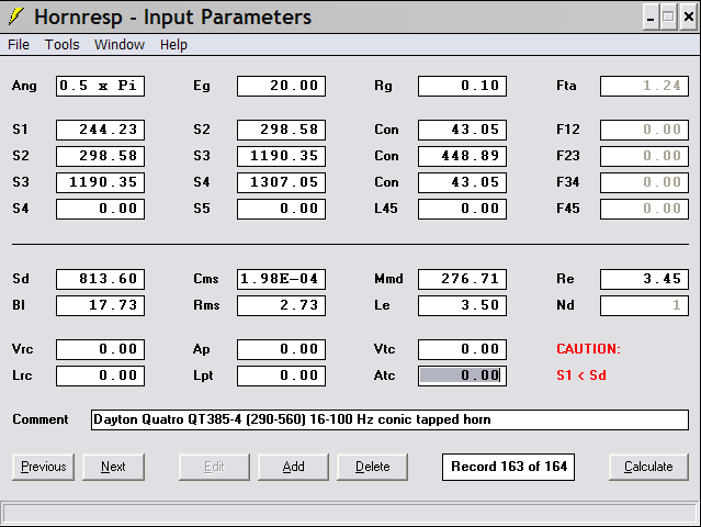

OK, using my interpretation of ML's math and pipe horn design, I get a bit different gain BW/larger 377.394L with your axial length. Regardless, there's nothing wrong with your design if you plan to XO it down around 70 Hz, though many folks have worse dips in their rooms than this TH and don't mind it, so you may can XO it much higher if you prefer. Only one way to know for sure.
Note that since it's a 15" driver the minimum distance to the throat and mouth is 19.21 cm, not 15 cm and you need to put at least 0.1 ohms of series resistance in the 'Rg' field since it affects the sim. Also, PE's measured specs are somewhat different to the published ones, so I recommend trying them in your design before cutting any wood.
WRT finding power required to reach Xmax, either double click on the 'Eg' field to input watts/nominal load and re-calculate to see how it affects excursion or just input a voltage to see what it takes to reach Xmax at whatever cut-off frequency you choose, then calc watts required: W = E^2/R
With my sim it takes 20 V/100 W to reach the 10 mm Xmax at ~16 Hz, so with your lower tuning, though smaller TH, it's probably about the same.
GM

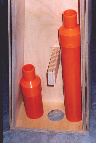

Helmholtz Resonators
Cordraconis: I'll try to attach some .jpg's that show some applications of Helmholtz resonators in loudspeakers, and a link to the E. Jakulis paper.
Back to work.
ah, now I get it. Thanks for the JPG's. I'll have a look at the paper later.

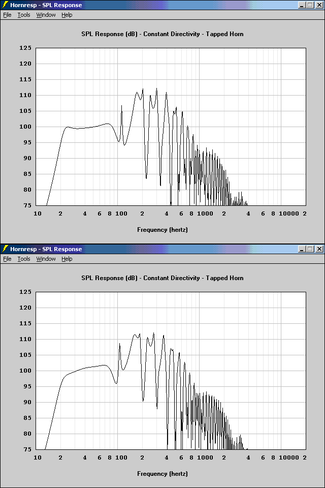

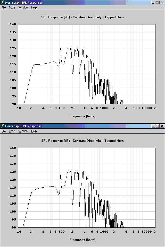

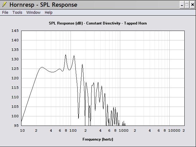

Here are some sims I have beenplaying around with. I have some for the Dayton Quatro 8".
Dayton Quatro 8" in TH ranging in volume from 100 - 150L. Is there any preference for hometheater? I have 2 more sims to come of the same driver. The sims are in order of smallest volume to largest.

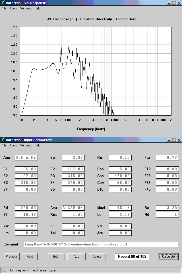

Tang Band Comments
I tried changing the Qes from .3 to .4 on the 8" subwoofer and in the sims using Hornresp it starts looking pretty good. Would it be possible to adjust the Ques by varying the amplifier impedance as stated in this article:
http://sound.westhost.com/articles/cscaling.htm
If so then this driver may look something like this in a 117L TH:

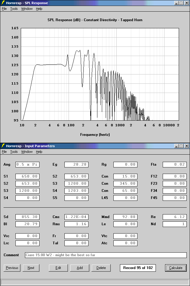

Ciare 15 W2 TH
I'm going crazy with all of these nice looking results. Would this be relatively easy to x-over?
I forgot to change the Rg = 0.10 but I didn't notice much difference in my other sims when I made the change so maybe this is still valid.
