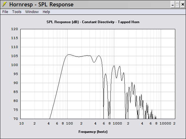

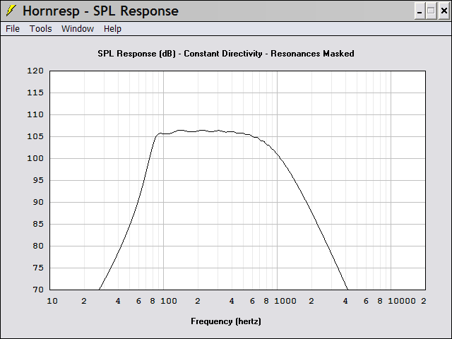

midbass folded FLH v TH
GM,
Rather than max BW or bottom end (I'll use a sub below) the aim is minimal distortion and colorations
> You can fold a FLH too.
Very good point - over the same broadly midbass 90 - 360 Hz range (with the PHL) how would a folded FLH be likely to compare with a TH??
I also need to have construction KISS, which is what attracted me to THs . .
Thank you
GM,
Thank you

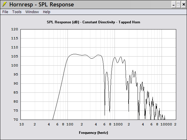

GM
Greets!
You're welcome!
Oooh! I've worked/suffered through such heat and it can literally be a killer, so keep yourself well hydrated, protect skin, etc..
Correct. Apparently, the wider BW's smaller throat to a smaller mouth damped it enough to negate the electrically added damping alignment.
On a TH, 'Fh' sets the driver's location along its length.
OK, a good plan considering we're not sure if we want the extra HF output a smooth bend implies. I know in simple pipe horns we keep the bends 'crude' and sometimes even add damping in the bend(s) to tone down its HF output and if I ever get to build any TH's, I'll be experimenting with damping to smooth less than optimum alignments.

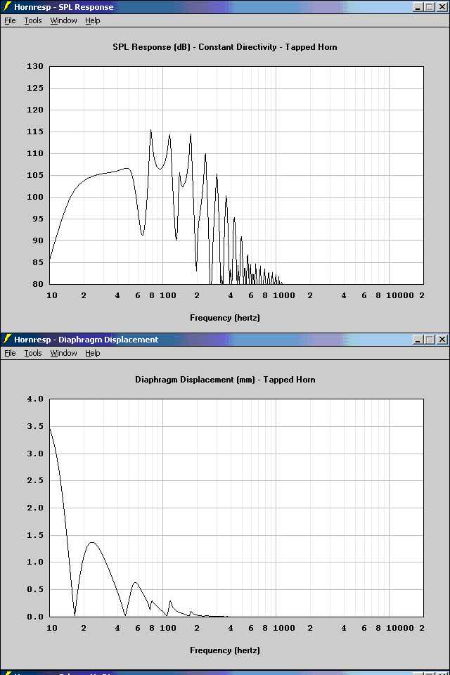

XJ-15 tapped horn similation
Hello GM:
I really appreaciated you taking the time to run some sims on my sub. I am still trying to get my head around the s1 - s4 thing. I read Buzzy's post and the replies and I think I got it. Once I figure out how to post an image I will send you what I think it looks like. Thanks agiain.
Hello GM:
Fh is a setting within hornresp? (I should be able to get hornresp going on the weekend)

All the TH sims have a ton of artifacts up high, as you would expect from something summing the front an rear waves of the same driver's radiation within an enclosure. Good at long wavelengths.otto88 said:Posted by Brett
Even if you want a lowest useable F of an octave below that, a simple conical will likely have less artifacts from the horn. See Adrian Mack's A6 conical for example.
I wanted something that won’t take too long to build. That’s what attracted me to the TH. I’d expect a straight conical to be cleaner, but by how much; and a TH vs a folded FLH . .
But let's be realistic; how is a conical flare any more difficult to make than a TH?

Greets, part deux!
You're welcome!
Probably no comparison. As I noted at the beginning, I wouldn't use a TH in this BW based on what little I currently know about them. I'd have to be desperate for a compact system to even consider it and have plenty of digital EQ available to tame it if I couldn't do it with internal damping without a major loss of efficiency.
That said, an 'ideal' T/S max flat BP alignment yields the best performance AFAIK, but the driver has to have the 'right' specs for the desired gain BW and it will be huge since the only thing controlling its performance is the sheer mass of air 'trapped' in the horn.
For example, changing the Focal's Fs, Qes to an 'ideal' driver for a 56.56 - 320 Hz alignment with loading to 80 Hz requires 365.625 L net according to Hornresp, but you get what you 'pay' for:
GM
If you optimize Fs, Qes for the 80-320 Hz BW, which yields even better performance due to a smaller gain BW, it jumps up to a whopping 528.141 L, but its electro-mechanical damping is equally impressive compared to the others, though don't have a clue how audible the differences are other than its increased peak power handling:
Now, using the 'ideal' Fs, Qes driver that requires 365.625 L net in a TH and letting Hornresp auto calc an 80 - 320 Hz FLH, it's 275.111 L net, 129.49 cm long terminating into a 7,356.94 cm^2 mouth. Not exactly small, but on paper it outperforms the 578+L TH in every simmed way enough to make it the 'no-brainer' choice of the bunch IMO:

GM,
Thank you very much for your sims and graphs!!
As you’ve also made clear, I was looking to save size, but the compomnises are much greater than I thought. As you say - you get what you 'pay' for
How did you determine the 'ideal' Fs & Qes, and what were they?
Thank you

Sims
Hello GM:
Over the weekend I ran a Dayton Quatro 15" from parts express through Hornresp. Can you tell me if these look good. I'm not sure that I am under standing the x-max in the displacement diagram correctly. I remember someone mentioning that you are supposed to be able to determine what the max excursion will be at what power. Volvoteer mentioned this in one of his posts, but I didn't see how he determined this. Thanks.
BTW, I also ran the Dayton Quatro 10" and it also looks good. I ran the LAB12 too, and got similar results as posted below.
