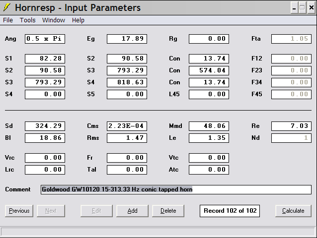

tapped horns
Hi GM
Thanks for concidering this request.
Goldwood GW10120 10" like this to be HT sub.
Thanks again

Re: tapped horns
Greets!
You're welcome!
OK, found a little more info which lists a lower Xmax, so I split the difference in the sim:

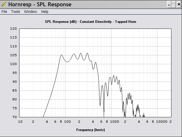

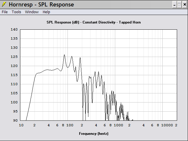

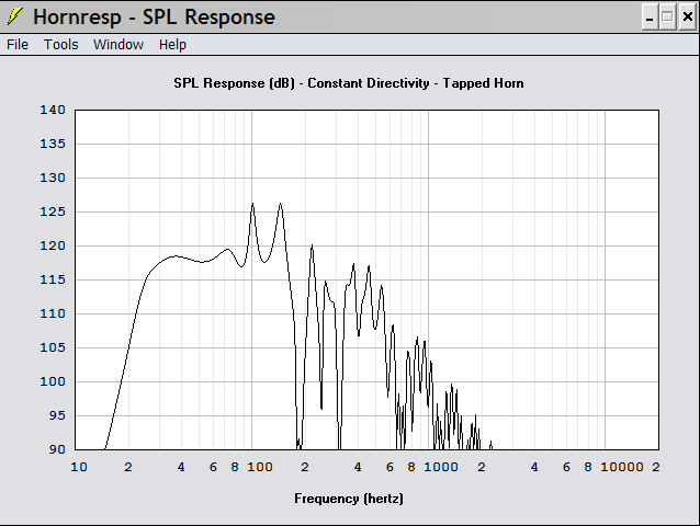

Focal Basshorn
So.... I have been looking for a new home for this baby (Focal VX33 13") for a long time:
... and thanks to the great efforts of the DIY forum folks, ive come up with something worthy, I think.
Simulated a 4m Horn (outer dimensions are ~ [2 x 0.3 x 0.4]m as follows:
Inputs (Quarter Space, Concial Flare):
1W Response:
Xmax linear limit, coincidentally ~100W:
thanks again to the efforts of all here!! its very good to see an excellent though being realized "in the flesh" by many different people!
hope to be there within a month or so.
Mike

Re: Focal Basshorn
You're welcome! That's one serious driver, looking forward to a review!
GM

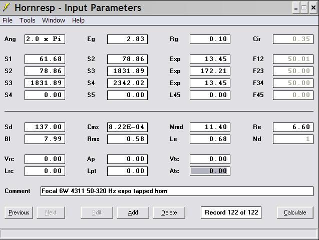

Greets!
With today's digital TD capability it may be doable, but this is moving up into our acute hearing BW, so perceived SQ may be poor. Only one way to know for sure. Anyway, I tried several different alignments for just such a TH yesterday and while I could get a nice flat response I could only do so with an optimized expo flare, so was pretty big for a 6.5" driver and its low Xmax limited it to ~105 dB, so didn't bother to save it. In theory you'll have to make it with smooth bends, proper radiused corners though, not the 'stepped' designs you can get away with in (sub) bass-horns.
Fh = Fs*Qes/2 says the Focal won't go high enough and the PHL way too high, though adding series resistance to lower its 'Fh' can in theory be used to smooth it out, but haven't simmed either one yet, so not sure this is even relevant in a TH. Note too that with expo flare you'll need a Fl*0.707 to load all the way to 80 Hz = ~56.56 Hz flare frequency.
Hmm, should be around 8 dB/W/m/2 pi space gain on average in it ~flat passband.
GM

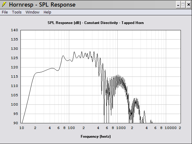

otto88 said:Mmm, the Qes of the PHL is much lower than the 10W400![]()
Greets!
Well, look at the formula I screwed up, it all depends on the ratio of Fs:Qes as to which has the widest BW potential.
Anyway, I simmed the PHL using ML's math for both a 56.56 - 615.38 Hz and 56.56 - 320 Hz with/without series R compensation and while it smoothed the 320 Hz TH, all it did was lower the 615.38 Hz TH's efficiency.
Bottom line, the wider BW alignment was the better damped, just as efficient and considerably smaller than the 320 Hz alignment, so not a good plan IMO to 'short change' a TH's HF BW.
The Focal OTOH had to be tuned to Fs to get it to 80 Hz, though at a lower efficiency with more 'ripple' and it didn't matter whether I used a 250 or 320 Hz Fh. Not surprisingly, it's smaller.
GM
