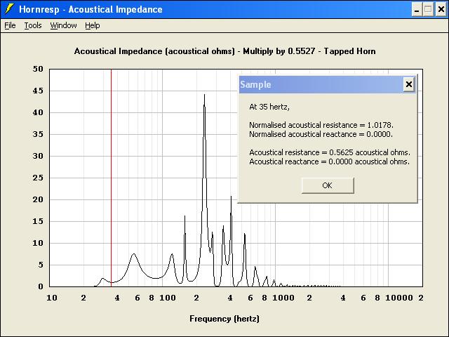

Circlomanen said:I dont think hornresp gives the right efficiancy but i do think it will be awsome considering the small size of driver and box.
Hi Johannes,
I have carried out a “sanity check” on the example you quoted, and everything appears to be in order. I am very interested - what makes you think that the efficiency figure may be incorrect?
The attached screenprint shows the efficiency vs frequency chart for your tapped horn example (disregard references to acoustical impedance). You can see that the efficiency is relatively low across the frequency range of interest, while varying significantly across the full band - peaking at just under 45 percent. Any horn having a slow flare rate and relatively small mouth will exhibit such “peakiness”. The y-axis shows percentage. The “normalised acoustical resistance” at 35 hertz is actually the percentage efficiency (displayed as 1,0178 percent, which rounds to your calculated figure of 1,02 percent).
Kind regards,
David
SANITY CHECK - VALUES USED
Velocity of sound = 344 metres per second
Density of air = 1,205 kilograms per cubic metre
Reference sound pressure = 2 * 10 ^ -5 newton per square metre (20 micropascals)
Ang = 0,5 x Pi (eighth space)
Eg = 8 volts
Sample results at 35 hertz
Sound pressure level = 111,0948 dB
Electrical input power = 19,1631 watts
Acoustical output power = 0,1950 watts
System efficiency = 1,02 percent
Driver electrical input impedance magnitude = 3,3390 ohms
ELECTRICAL INPUT POWER
If we assume that the driver electrical input impedance is purely resistive at 35 hertz (it is very close)
Electrical input power = Eg ^ 2 / Impedance watts
Electrical input power = 8 ^ 2 / 3,339 watts
Electrical input power = 19,1674 watts
This is almost the same as the Sample result of 19,1631 watts. The slight discrepancy is due to the actual input impedance having a small reactive component at 35 hertz in addition to a dominant resistive component.
Thank you very much for checking.
I just dont seem to get that spl when playing on my horns in my home.
My large tapped horn with a Beyma 12LX60 doesnt do 102 dB with one watt. I havent measured, but its not 10 dB more efficient than my BR-box with two 10 inch drivers in. (88 dB/w/m) I have to adjust the sensitivitysetting on my amp about 8 dB. That would make it about 96 dB/w/m efficient.
Johannes.

G'day Circlomanen
There is a very good chance that your 12LX60 Tapped Horn has 102dB/W/M sensitivity - when 1/4 space loaded. On the same note, I'd guess your dual 10" BR box is doing better than 88dB/W/M when also 1/4 space loaded.
Interestingly enough, a domestic room is a really poor representation of 1/4 space (or 1/8th space if in a corner) loading. The room is much more constrained that 1/8th space would predict, but then the walls are much more lossy too. You get what you get and you basically have to live with that.
Cheers
William Cowan

Hi Johannes,
Thanks for the additional information. I have no explanation for the difference in levels you are seeing - assuming that the input to the loudspeaker is actually 1 watt and not 2,83 volts (1 watt into a nominal 8 ohms).
User feedback would suggest that Hornresp SPL predictions at bass frequencies can be surprisingly close to measured results, provided that the test conditions accurately reflect assumptions made in the simulation model.
The comments by GM, William and Eva are relevant.
It's a minor point I know, but technically I think that we are now probably talking about sensitivity, rather than efficiency 🙂.
Kind regards,
David
