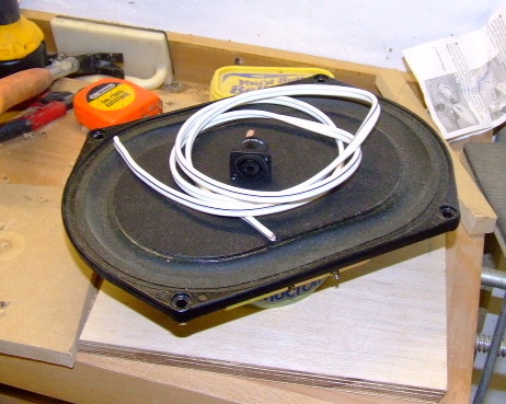

And the glue up! Time for lunch. 😉
pinkmouse said:
How can I not comply with that request? 😉
Overall pipe length is 152", with the tap at 21.3", pipe C/S area is 54.6 square inches, and the driver is the Kef B139.
Al,
Thank you for the information. Aha, the Kef is not a circular woofer! That explains the truncated hole cutout which I had actually thought was there for acoustical LP filter purposes.
Care to share cabinet OD dimensions, distance between dividers? Sorry for so many questions. Pretend I am trying to make a construction diagram to copy your fine work for myself and am looking for any info that I would need to do so to mimic your effort accurately. For example, giving me simply cross sectional area of the pipe does not define either side dimension.
I even have a router which will shoot sparks when I attempt to use it to copy your work. Is that getting close enough? 😉
Oh, BTW, you did remember to install the driver and a wire to it before you closed it all up tight. 😀 😀 😀 :smash:

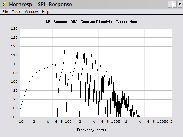

I don't have the aversion to an access panel that you apparently do, but if you consider a rising response an acceptable trade-off (I do since it's better damped, but this thread seems to be 'max flat' centric) you can shift the driver position to the extreme end for easy access through the mouth, making the layout:
L12 = ~92.39 cm
L23 = ~342.42 cm
L34 = ~15.24 cm
GM

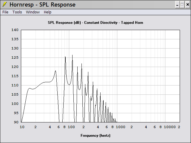

Well, when all else fails, a TL will usually get the job done, though to keep the size semi-reasonable with this driver means it has to be Isobaric. Assuming a 200" long square tube just big enough to mount a driver (~12.5" square) = ~13.92 ft^3 or < 4 ft^2 before factoring in all the divider thicknesses and the extension to house the clamshelled driver. 1 W shown and with Isobaric you have 2x the excursion, so should pound pretty good and once the ripple is XO'd down will have a very good transient response:
GM
