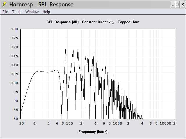

I'm experimenting with what works best in a tapped horn. For instance, I've posted a design that shows what happens when you use series resistance to raise the QES of a tapped horn. Here's my tapped horn project.

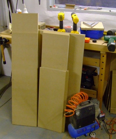

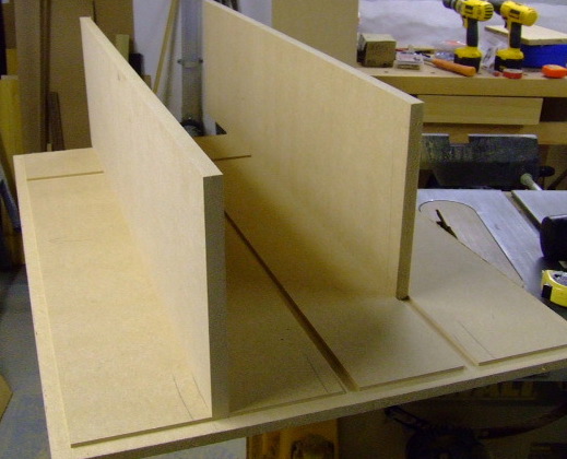

Well, not quite a review yet, but I've just got in from the timber merchant. Time to fire up the table saw! 😉

FWIW, I got to looking a little harder at what's going on in a tapped pipe and if you haven't cut any wood yet, then I'd like you to use a 349 cm^2 area pipe with the 322.9 cm dim increased to 344.42 cm. I doubt there's any audible difference, especially in-room, but it just seems more technically correct when I sim it as a BP:

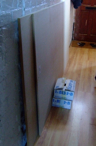

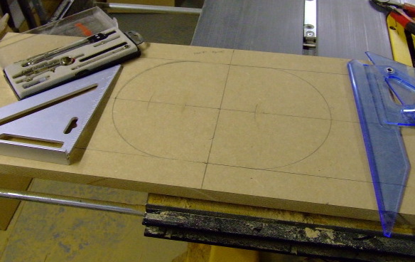

Rats. Done the maths, and I can't now get a box out of one sheet of MDF with the new dimensions. Need to think about folding...

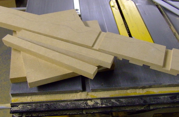

Well I have a pile of wood cut to size. Time to set up the dado blade for some rebates.
Thanks to advanced topological theories and lots of work with a pencil, paper and calculator, I managed with one sheet of mdf, but the line is 2cm shorter than the ideal. I think I can cope with that. 😉

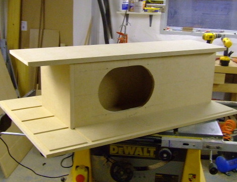

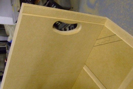

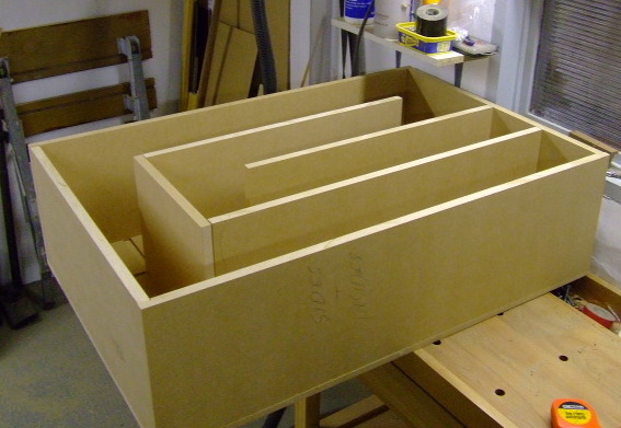

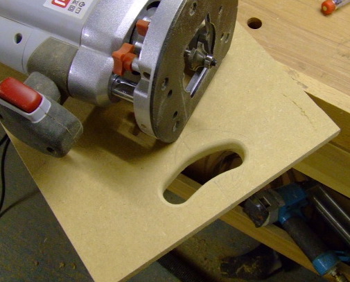

Rebates cut, nice and tight. Definitely no going back now!
