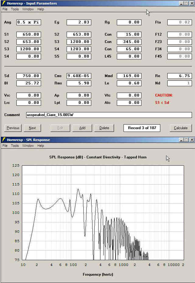

Killjoy: The link to the Ciare 15" you modelled does not seems to work, and going on usspeaker.com the only Ciare 15" that is listed - Model 15.00SW - has considerabley different parameters. Must be a different model.

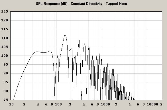

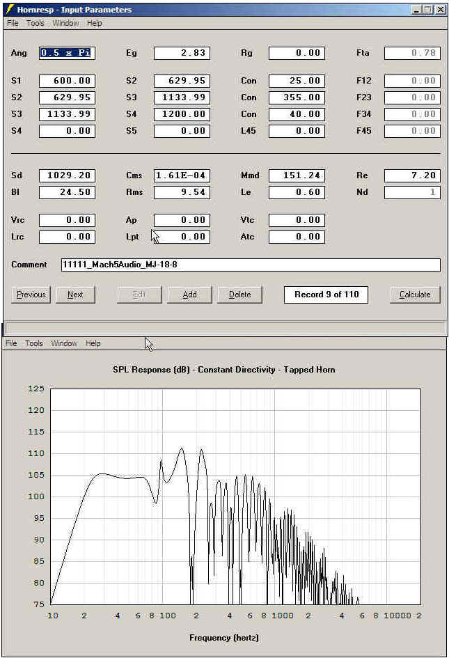

Anyhow, enclosed is the hornresp input and SPL for that speaker in your box dimensions. Obviously,it does not look smooth, but seems to be a good example to point out some of the tuning that may apply to the tapped horn in general:
1. Active high pass filter to prevent excessive cone deflection below the passband, and to control any low peaking (e.g.: in this case @ 21Hz),
2. Series passive filter element (L) to control the peaking @60Hz and to modify the speaker parameters. (As an aside, the Jensen Transflex paper recommended a 45hz 2nd order passive cross-over network.)
3. Tuned resonators to reduce the first few resonant peaks, maybe @ 94Hz, 150Hz, 235Hz, 330Hz.
4. Lining of parts of the horn walls to reduce the higher frequency hash.
I feel, that even if one does (obviously) a better job of speaker selection and box tuning, all of the above will apply to just about any tapped horn. Which, if nothing else, makes this quite a project to get right. This is really interesting.

I dont think the peaks and nulls above the passband is such a big problem as Hornresp simulates. I cant hear any of the peaks as any kind of distortion when playing loud with my small tapped horn. If I realy had 10 dB higher efficiancy around the second and third harmonics of the bass coming out of the horn, it would sound terrible, but it dont. The bass is much cleaner and purer than any closed box/BR/BP i have ever heard. (of comparabel size)

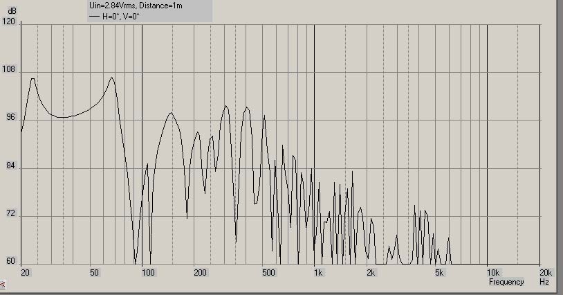

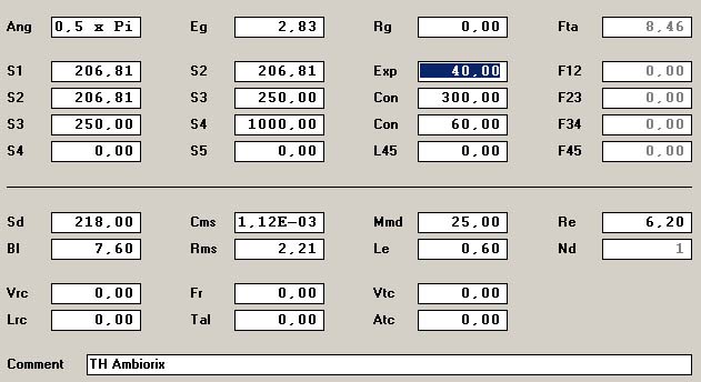

@tb46: I have finally read the paper and it looks interesting, but for the moment I'll refrain from trying to model it in AkAbak. Since a TH Sub is mostly for a rather limited bandwidth I don't consider resonators an issue for extending the response.
I removed the "radiator" elements from my script above, as the only part that connects to the outside air is the mouth of the horn. (Why didn't I think of that earlier?)
The SPL plot is now what I would expect from a TH. The upper and lower knees of the passband are now clearly defined and the average sensitivity is as predicted in Hornresp.
However ... there is a broad dip over the passband that I don't have in the equivalent TH in hornresp. Since I'm using Hornresp as my reference, I'm wondering if this could be because of a difference in horn theory between AkAbak and Hornresp? Maybe someone can explain this?
for reference: here is my equivalent script in AkAbak:

With the SPL plot attached:

Circlomanen: Thanks, that is very useful information, especially the comparison to other subs of similar size. Just like GM said:"...the 'ripple' isn't as bad as predicted...".
Cordraconis: I hope you had some fun with the Jakulis paper. In your script you have a number of area values as e.g.: STh=0,206m2 is that how AkAbak denotes cm^2? I think normally 206cm^2 would be 0,0206m^2, right? Anyway, you'll get me into AkAbak yet, as soon as the oil price falls and we're getting back to a sane work schedule around here (Texas).
DOH! :shutup:
Thanks tb46!
After correcting this (me and mathematics don't mix :headbash: ), the SPL plot looked even stranger, whith a huge and broad dip around 80Hz.
After looking for 1meter resonances in the system, I finally stumbled upon the Reflector element that simulates corner loading. Changing the distances to 0,5meter finally gave me the SPL plot Hornresp produces!
Some quick observations from my simulations:
- the cross sectional area of the 80Hz resonator can be made smaller at no penalty, (unless you need the HF cutoff to be broader.) --> less cabinet volume!
- a front compression chamber and/or any compression rate <1 (but same throat and mouth of conical segment!) gives a little more on the very low end, but reduces the lower knee. Omitting this gives less cabinet volume.
- a back compression chamber gives more output at the Higher knee. Usefull to make a gentle rising slope for room gain.
- the exit of the back compresssion chamber can be made quite small without penalty for the LF response. A Unity/Synergy Horn also has these small holes. (More backpressure = more cone control? = higher freq output on front of driver)
- the efficiency rises as you put the mouth more into the corner. I wonder how far you can go with that.
