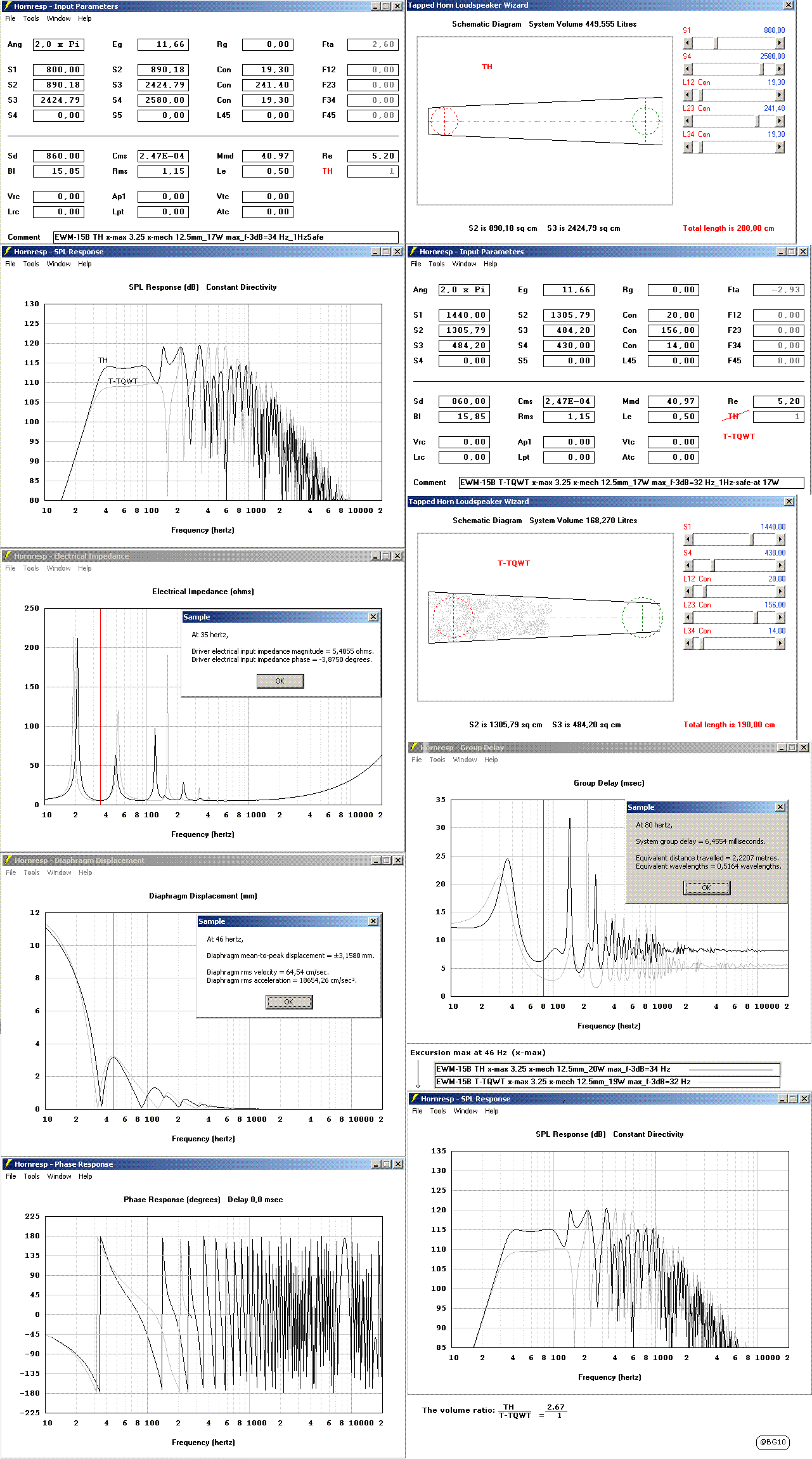

..What can be done with this driver?..
Hi Highef,
Maybe a T-TQWT? 🙂
b
Looks good. I 'ran the numbers' through Prof. Leach's math for the T-TQWT and got a ~50% bigger design with a little higher SPL to a little lower F3, but I admit I don't bother with really low peak output designs unless specifically called for.

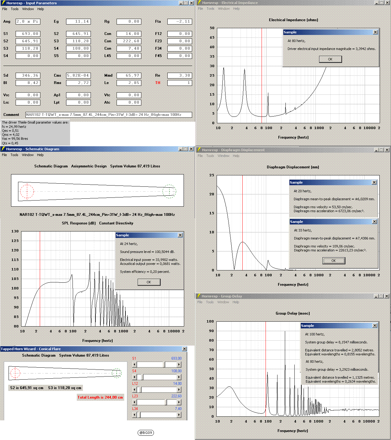

Hi to all,
I would like to hear your opinions about this project
It is supposed to be a small subwoofer for a small room, 2ch music only.
The driver displacement is 7mm linear and 11mm before damage.
I intend to filter below 30Hz for safety and 95-100db is enough for my needs.
Are the sections and lengths well placed in the last picture?
I would appreciate any comment.

Hi Highef,
Your TH looks possible, but I would prefer a stuffed T-TQWT for size, no need for equalisation and of most importance: the SQ reasons.

That should work. Your drawing seems to match up well with what you simulated.
Due to the corners, your actual length may be a bit longer than your path line indicates, but the differences should not be enough to worry about. The critical dimensions are L12 and L34, those are straight lines so there is not much chance for errors there.

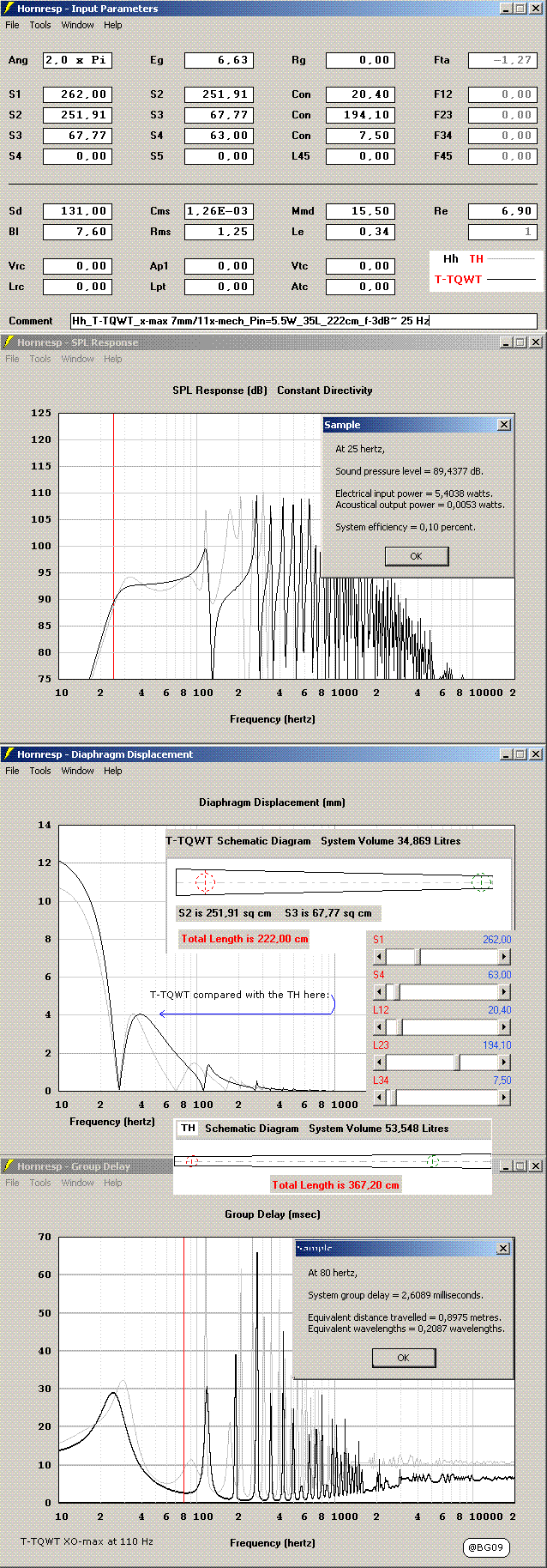

Hi mwinger,
See the picture: IMO, Both the TH and T-TQWT should work well in a home venue without signal delaying the main speakers.
Search: EVM-15B-Pro-lineEDS.pdf for TS data,I tried the data from The Thiele-Small Loudspeaker Database. You might have other measured data to enter in HR?
