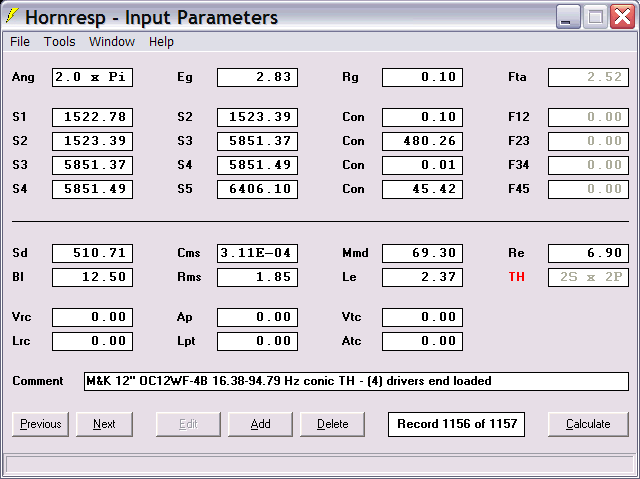

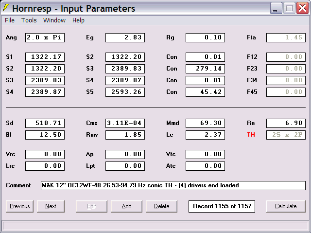

doug20 said:The model I believe is the OC12WF-4B
OK, thanks, but are they published or measured specs?

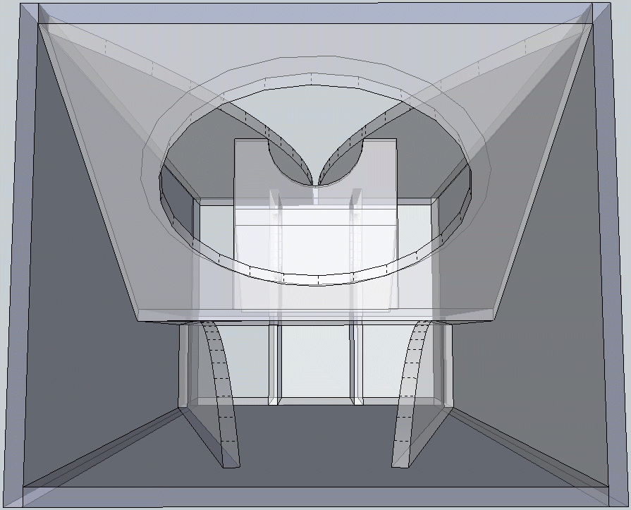

Here's the design I referenced:
GM
doug20 said:Even a 30Hz to 100hz solution would be cool if possible.
Tuning to around Fs creates a fairly under-damped alignment due to its high Qes, but stuffing will flatten it same as with a TL and it's 'only' ~624 L net, though at a ~3 dB lower efficiency than the much larger, lower tuned one.
Anyway, now you have several alignments to play with the TH Wizard to potentially find an acceptable trade-off between BW/size/peak SPL.

doug20 said:so 4 require 4x the size?
If you want the same response except with more efficiency. Maybe easier to visualize if you designed a nice maximally flat sealed or vented alignment and then reduced its Vb to only 1/4. You'd be left with a 'one note' boom-box.

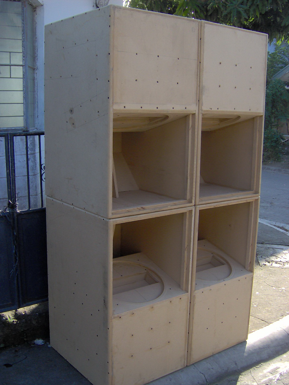

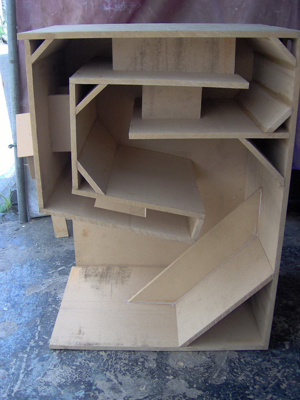

Hi to all,
I just like to share my TH project...here are some pics.
and wow...first time with no simulation...This is FUN.

Nice looking box JoJo, but why whould you go to so much effort without running a few sims first?

hi to all...
yes sir it did sound very impressive, for the fact that it was not SIM'd.
why not SIM'd?...too exited and intrigue...and got only 1 week spare to build quickly.
Anyway, if it did not go well...will just charge it to experience...hehehe.
But, its just amazing...thanks to the stepped horn guy, forgot his name sorry sir...
thank you to this forum, collaborating in this wonderful project.
please take note that my th is not Sim'd and falter in some ways.
here we go to LISTENING comparison...(HP dv9408 fail again...sorry no smaart)
WSX vs THproject: using cd samples only. circuit: parallel box with mechanical time alignment.
@100hz---WSX approx. 3bd louder.
@80hz----Same as above
@60hz----now its getting fun...same space and time...its a rumble!
@40hz----TH winning
@20hz----just flapping cones...hehehe
this was done at 1 wavelength per box config...4box per config.
it was in 2007, test was done on location before the gig start.
i know i have those pics somewhere in my drives...will just post it when found...
2009 now we are still modeling this, whenever we got time.
i believe that this TappedHorn box configuration will be great.

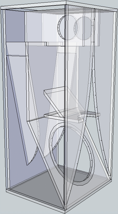

You might find my own ideas along those same lines to be of interest???
Sized for my Sigma 18. Warning: This plan hasn't been built, nor simmed,
nor tested in any way. ...Yet...
