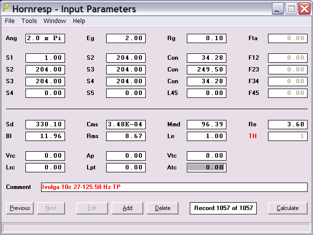

Well, it would be only ~5.62" if square, but it's a ~10" driver so will need to be a rectangular slot, ergo will have to have a custom bulge around the backside of the driver near the mouth. This is one of those sims where it's obvious I just 'ran the numbers' and moved on without giving any thought to any layout considerations since they typically don't get built, so not willing to invest hardly any time in them.
Yes, it's a tapped straight pipe and with a simple bi-fold the driver would be mounted to the divider board with the area between the center-line of the driver tapered down to a point at the closed end.
HR sims an end loaded mouth, but a side exit only affects its extreme HF response well above the XO point, so not an issue.
WRT a > 1:1 CR in a TP (this one is 330.1/204 = ~1.618:1), I've only done it with high Qts driver TLs to lower its effective Qts via increased acoustic damping, but the B@$3 Wave Cannon uses 2:1, so see no reason why it wouldn't be fine in a TP as long as the driver's specs called for it.

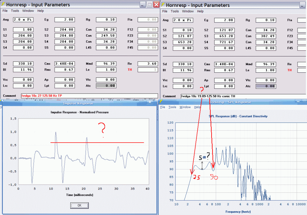

Thank you for your advice.
But questions are not answered on linearity FR, pulse characteristics.
Currently, the DIN has played in the design ported, 28 Hz at-3db.
And I want to revamp the design of TP in order to improve the quality of bass.
P.S. Sorry for the language I use a translator

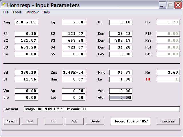

Makc said:Under TP, I mean the Tapped horn, the translator changes the TH to TP 🙁
You are welcome! Sorry I missed your posts.
'DIN'? Do you mean the Ivolga 10c driver?
You can add some inductance to smooth out the response, but it hurts the impulse response. You can end load it at the throat and/or make it longer and/or use a different flare factor, but what will make the most difference is proper damping, same as a TL or simple pipe horn.

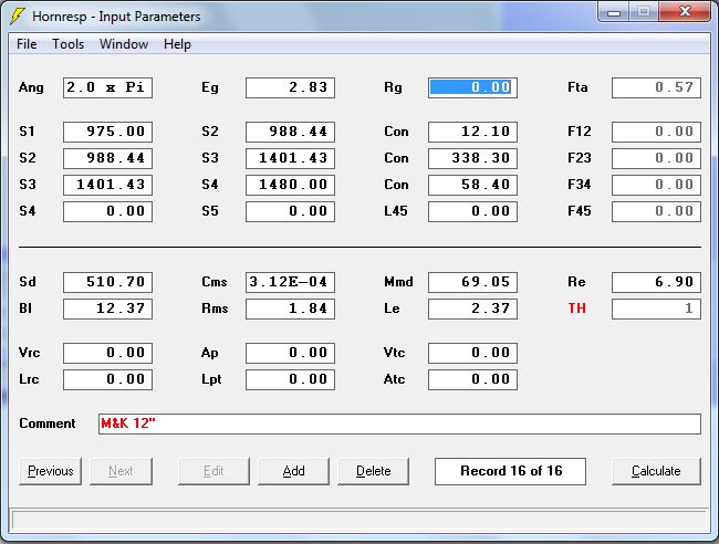

I have 4 M&K 12" woofer from an online surplus store ($60 woofers).
I haven't figured out what I want to do with them but now I would like to know if they would work in a Tapped Horn design?
I have never built one but I have built sealed subs, ported subs and IB subs. Its time to learn and build a TH sub.
Will 4 of these work in one tapped horn box?
Yes, but it looks like ~2k L is what it will take due to the high Qts, though of course you could make isobaric pairs to drop it to 'only' ~1k L. Better IMO to make some T-TQWTs unless sheer SPL is the primary goal.

What are your goals with the TH? I assume your looking for 20hz for home theatre - this needs a BIG box for a TH...
I've attached a quick sim for a box with 1 driver - it's already 500L internal. You can go smaller or larger to taste but bigger = more sensitivity. This is with 1 watt / 8 ohm (Eg = 2.83)
Download hornresp and have a go - check the displacement graph for your intended spl - I couldn't see Xmax or Xmech on that spec sheet. Here's a link to some other large TH so you know what to expect. http://www.cowanaudio.com/th.html
GM posted while I was writing - I think by reducing S4 with respect to S2 you move to the T-TQWT GM mentioned. Try the tapped horn wizard in hornresp.
