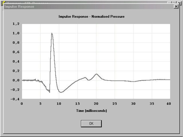

A fronthorn should look more like this.
-One large peak and a delayed small one.

tb46 said:Hi electroaudio,
I posted an actual FLH example with build reference in Post #3340.
That looks normal.
I have to say that i really liked the words you used in post 3355 , but i just had to comment that the FLH was too odd to be called typical.
-I would have guessed bandpass.

Hi electroaudio,
Good guess. 🙂
You are correct, the FLH in Post #3355 is not quite typical, the limit in box size was just too severe, and the impulse looks a bit like some bandpass models.
On the other hand the excess overshoot, and the ringing, are quite typical for an over-shortened horn with a mouth that is too small. The initial delay and sharp first impulse peak are typical for a FLH though.
