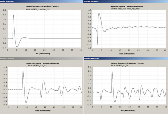

Re: Impulse Response
Thanks tb46. The article speaks of measured impulse responses which can reveal where the speaker differs from the ideal model. Yet, i asked about a simulated impulse response, where all the artefacts that this article refers to wont be in.
To my knowledge, every impulse response shows a rise and fall before and after the spike, which are there because the speaker is allways a bandpass system. Then you have the small irregularities which can be identified with frequency response bumps. Basically, one can translate from one to the other, only that the frequency response shows the data in a more usefull manner.
Or did i miss something?

Impulse Response
Hi MaVo,
It is my understanding, that in a frequency response plot you are looking at two curves: 1. magnitude, and 2.phase.
The impulse response displays the reaction of a system to a stimulus against time, and the aspects of the frequency response can be derived from this reaction. The impulse response shows the relative magnitude and arrival times of the pressure wave(s) as well as the reflections and ringing produced by chambers, ducts and horns in the time domain, something I don't think you can get from the SPL and phase response bode plots.
I'm more than willing to confess, that the math involved is well out of my range, and thus I have to refer you to the reams of information on the net. Just chasing down some of the references in the wikipedia article has my head hurting. 🙂 Basically, I look at it as one more wrench in the tool box.
I'll attach a number of Hornresp impulse response curves for the MCM 55-241 in 1 cubic foot enclosures: closed, bass-reflex, front-loaded horn and tapped horn. I cannot get the same information from frequency response curves, and am trying to understand what it means in reference to subwoofers and particularly tapped horns.
Hi MaVo,
The closed box gives best response.
The reflex is less good and out of phase.
The tapped horn is the worst.
Why all the ripples and delayed decay from the font loaded horn?
Am I reading the displays correctly?tb46 said:The impulse response displays the reaction of a system to a stimulus against time, ,
