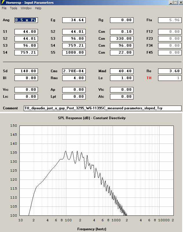

Hi just_a_guy, I'm not sure this is the right place for a tapped horn either, but, I just used your general parameters, and came up with this:
116.8dB @ 25Hz - 125.8dB @ 50Hz - 135.4dB @ 100Hz.
That's more like 10dB per octave, but below 80 liters. Try these values as a starting point, and move S3 around to change the slope.

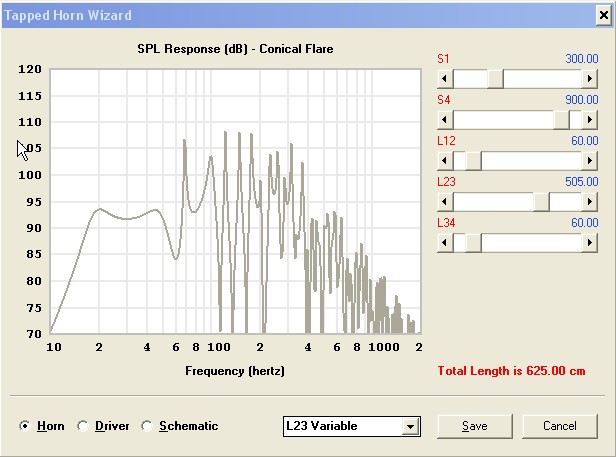

That is interesting (although with 300w your model is way past xmax). Not sure why I wasn't able to come up with something like that, probably because I was limiting mouth size to 625 cm (10x10 inch mouth).
Anyway, in order to compare, I changed a couple of things around to get the same tuning, same slope, same size, etc. Black line = FLH, 325w. Grey line = TH, 250w. Both at xmax.
Given the same power, they are very similar, but hornresp says the FLH can use a bunch more power than the TH before it hits xmax. Whether the driver can handle it thermally is questionable though.

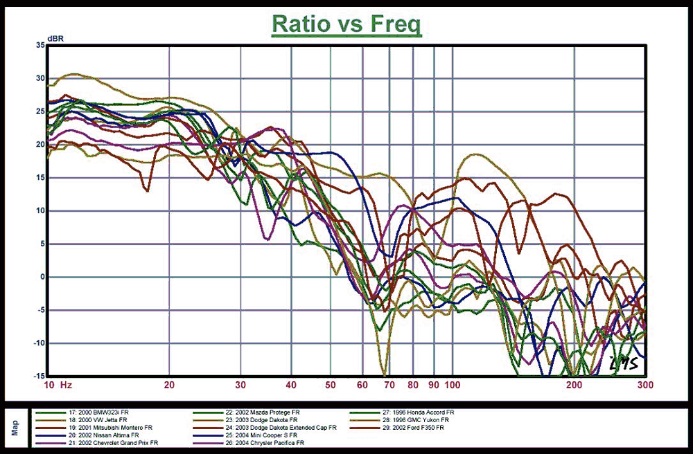

Hello Just a guy
For your car application the low end will get up to 20db boost around 20 hz from cabin gain. So if you have the length of horn to support the low end you will get it! I have used this little trick for years to great effect.
Second thought is that the best way to compare the horn response is not at the power maximums but where we will actually be using them. That is around 3 to 12 watts. If you find it hard to believe try putting a volt meter on the terminals of your horn and listen at the levels you like. Then do the math to convert the voltage to watts and find out for yourself.

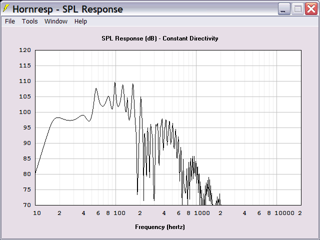

Interesting idea building a TH with rising response...
I'm tempted to try something similar, right now in my car I'm running an Autotuba which is a FLH, and while it sounds good and has a rising response, it's rather large and there is no more room in my boot (trunk) for anything but the speaker... 😀
I'm tempted to see if I can achieve a similar response from a TH but in a smaller box, I need to get to grips with ARTA and maybe try it out in the car to see how the Autotuba performs first.

Great graph, thanks for posting it. 🙂 I think my car look pretty similar to a Mini Cooper as it's a hatchback, but it's smaller than the Mini. I've attached a pic, the wheels are 15" so you can see it's a small car even by euro standards! 😀 Am I right in assuming the smaller the cabin the more cabin gain you get?
The mini looks to have a amount of gain below 50Hz tho, so maybe I could just have it so the horn is tuned for 50Hz and above which means I may be able to use quite a small box...

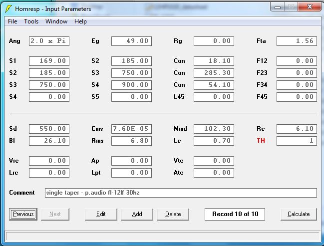

P.Audio FL-12LF 30hz:
(Still investigating the folding/ single vs. dual taper issue)
It slightly exceeds linear xmax, but according to this http://www.diyaudio.com/forums/showthread.php?postid=1797488#post1797488 still within acceptable limits.

If the T-S parameters are correct it looks like the FL12LF is even better for a TH than the Faital Pro 12HP1020 that Tom currently favours (used in the TH-212 and TH-812), which would make it probably the best 12" TH driver around -- and hopefully not too expensive. Does anyone know the rough price?
But having compared the parameters to the other drivers in the FL range with the same magnet structure I'm not convinced that they're correct -- it wouldn't be the first time that P.audio have had wrong T-S parameters in their data sheets.
I don't suppose anyone has measured one to see if this is the case or not?

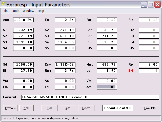

GM said:You're welcome!
Don't know what sort of 'raw', undamped response you're looking for, but FWIW this LMS one works for me:
GM
Well that looks a bit better than what I had going for the LMS 18. What are the parameters on that? Here's the best I had. Admittedly I don't know what I'm doing yet.
