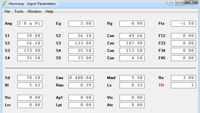

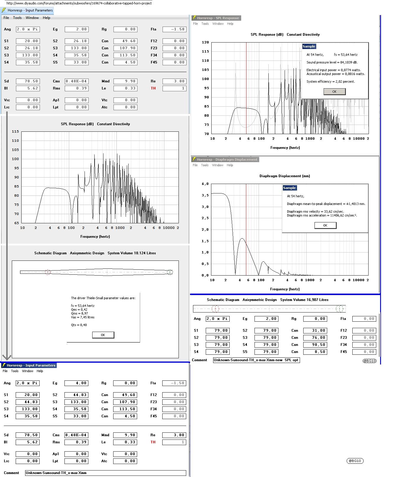

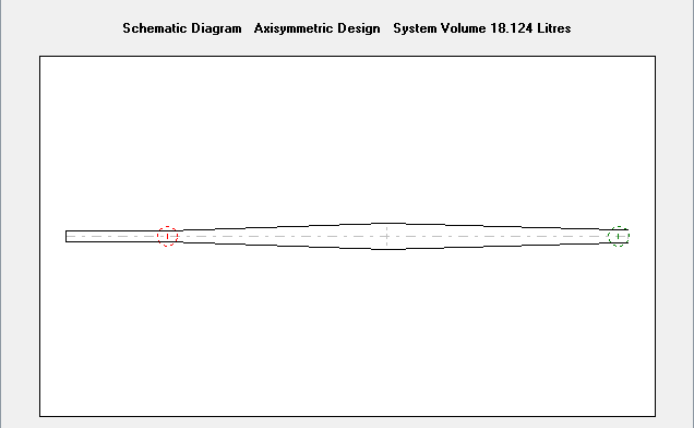

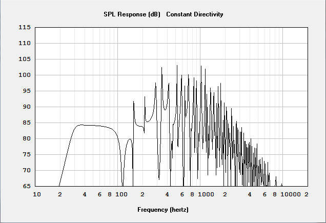

Hey all just wondering if anyone has successfully built and evaluated something like this?
The impulse response looks a little weird but I'm assuming that has more to do with all of the eratic HF gain.
I'm not sure what this would be considered a T-TQWD? or a TH.
I don't know how well this thing would require additional HF damping above and beyond a good low pass filter. I'm sure if the speaker is over driven the resulting harmonics would be accentuated heavily.
Coupling the drive to this thing is going to be problematic. I've done a few iterations of this thing between hornresp and akabak.
But I still have to envision and model what the driver coupling to the horn/tube/whatever is and model it in akabak. Perhaps I can get akabak to predict for damping also.
I know for ducting one can change the air viscosity but I don't know if that can be applied to waveguide or if air viscosity is ~ damping (wadding).

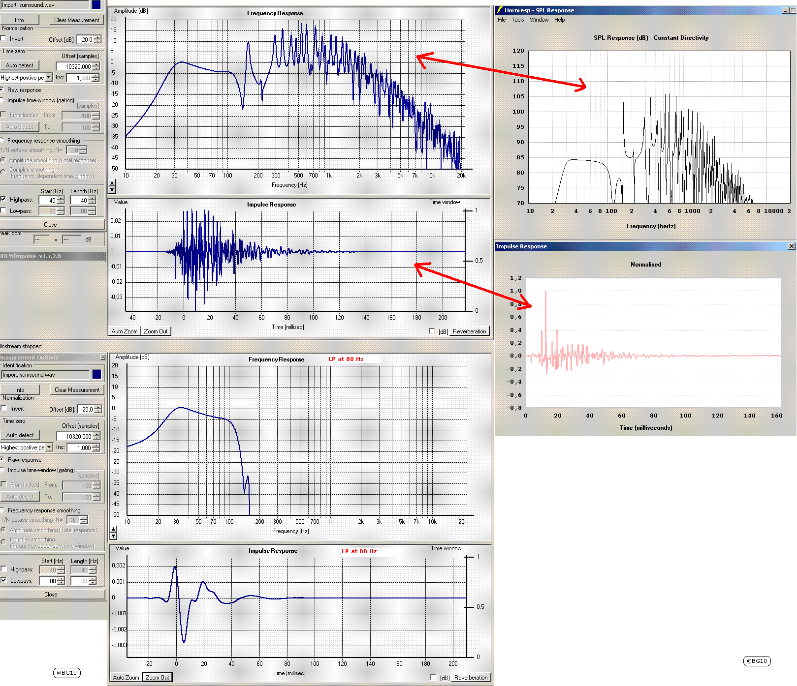

The spikes looks to be way to high in Q to be a problem in real life. I guess they should not be more then a few dB above bass region. Especially with the small opening. If at that.
Lowpass the IR in HOLMImpulse to see the real bass IR. HF garbage often shows the wrong picture.
You could probably insert a short duct every dm or so to mimic damping.
Would be hard to guess what's real though.
Or use ducts that are stepped in size. Lots of work though ether way.

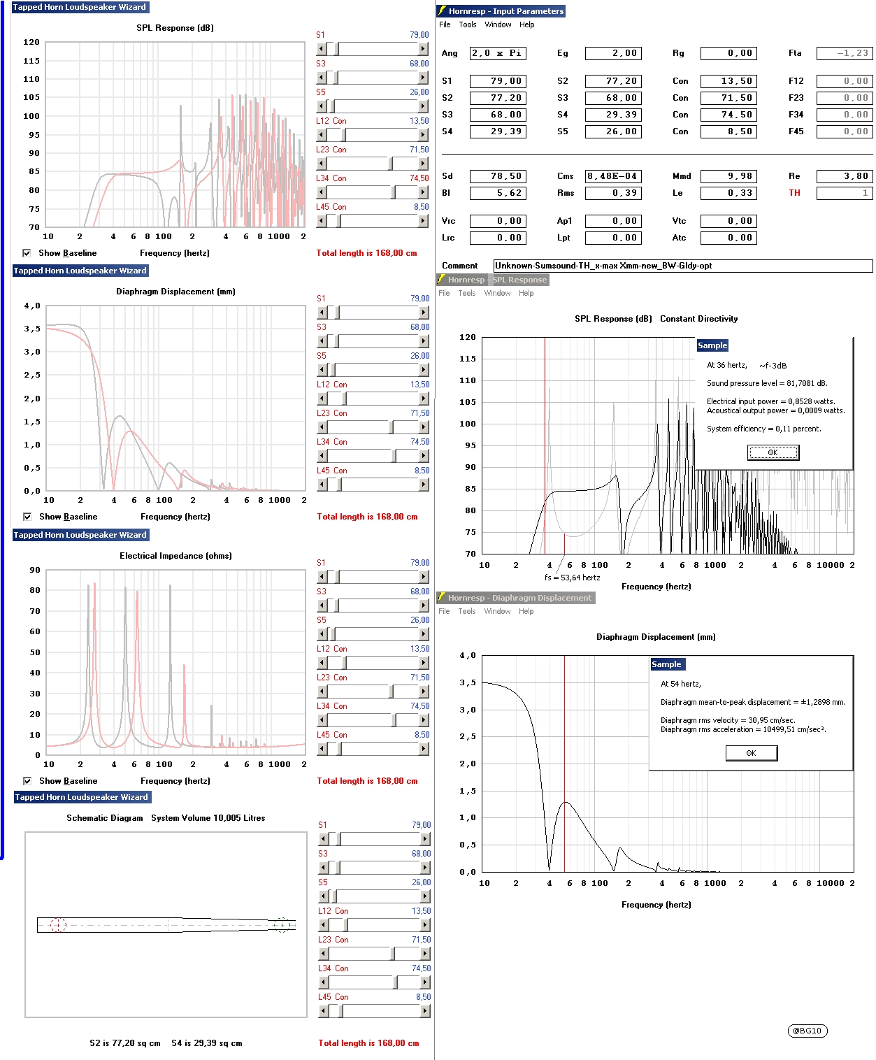

Hi sumsound,
I have built a similar enclosure using a very stiff aluminium coned driver.
Normally muffler look-alike enclosures (exhaust silencers) are a more acoustically lossy than Straight T-QWP: s, T-TQWT’s or TH: s so if possible I recommend you to try one of those instead. See picture # 1,2,3.
You're right, 🙂 the HR impulse response is IMO less usable if not further processed.
You should also stuff this ‘muffler design' enclosure like a TL or T-TQWT and of course use a LP filter when setting the upper BW boundary when integrating your main speakers.
This operation changes the impulse response of the sub if, measured separately, to something quite different but the resulting impulse response would be interpretable: See picture # 4 for an example.
