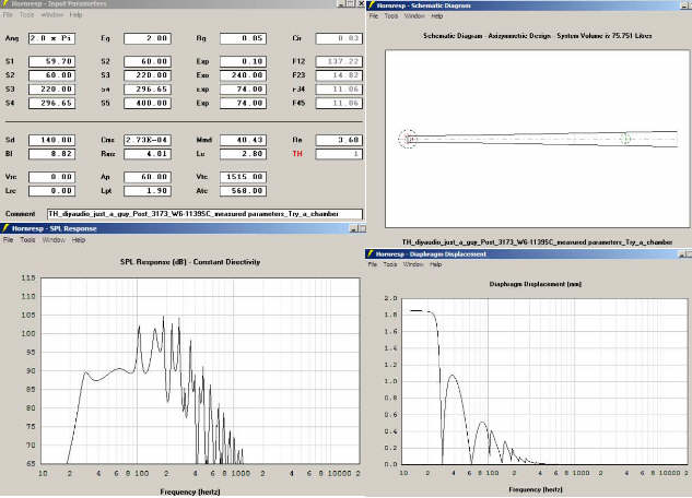

just_a_guy W6-1139
Hi just_a_guy,
Here is another attempt at modelling the W6-1139 with your parameters. This time I added a front chamber with a small port.
The overall volume is a little higher than yours and the SPL is a hair smoother, but still basically the same. I added a small (1mH/.05Ohm) inductor just to have it in the model. This smoothens the small bump after the first dip, but does not do much at this value.
Hi just_a_guy,
Re: just_a_guy W6-1139
Thanks for the suggestions, all comments are appreciated and suggestions will be studied and considered. But it's going to be at least a couple of weeks before I work my way up to that point - and probably more like a couple of months. Before I even think about a revised edition I am going to test the first one thoroughly to validate or disprove the assumptions I made when designing it.
First, a quick note about size. The box is somewhere near 65L internally, initially the size was chosen somewhat arbitrarily as a best guess as I have no verifiably accurate method of choosing an appropriate Vb. Later on however, it struck me that the BIB calculator would probably yeild a fairly appropriate Vb (and tuning frequency) for any given driver so I tried my driver parameters in the BIB calculator and it says 67L with a tuning about an octave below driver fs which seems reasonable to me (especially since it's basically the same as what I built) but ymmv. So the size is not going to change unless I find an incredibly compelling reason to do so and I haven't found it yet.
1st test - finding it's limits. This test is well underway. The only 4 ohm amp I have is a car stereo amp so I "installed" (and I use the term very loosely) a stereo in my car. As you may suspect it needed a bit of frequency response tailoring to sound right in a car. First impressions are incredibly positive. For a 6.5 inch driver with 23 hz tuning this thing is LOUD. I could go on but I don't have an spl meter to back up my impressions so I won't bother.
2nd test - more accurate groundplane measurements. The ones I did were done as fast as possible on mushy ground on a cold and windy day just to get an idea. I intend to do better on a nice calm spring day, possibly even on a large concrete parking lot late at night. We still haven't had a single really nice day yet.
3rd test - possibly most important - listening tests in a regular room. I've got active xo and parametric eq so I'm not worried about frequency response in the least, just need to know if I like how it sounds.
Only after I collect this information will I look at what needs to change and how best to accomplish those changes, so it's probably not going to happen anytime soon. I can guarantee I won't be using inductors though, they are just too expensive.
tb46 said:Hi just_a_guy,

Hey Oliver, here's a good example of why I don't want to rush things and why it's hard to tell what a measurement is actually saying unless great care is taken to extract the best results (IOW what you want to see).
Below is an example of a groundplane measurement I snagged today. I had to get it in quick because the weather channel says it's going to start raining this afternoon and last til the end of forever. This measurement was done in my hard packed but wet gravel driveway (the last measurement I posted was on the lawn) with a different amp and this time the box is standing up (last time it was lying flat on the ground). Also, mic distance was closer this time, 2m, since I was only able to get about 5m away from the car and 10m away from the house. Additionally the mouth was well stuffed with fibreglass insulation this time. The measurement looks better but it sounds muffled so the stuffing will need adjustment.
Anyway, this is a lot closer to what I was originally expecting to see - other than the nasty gash at 80 hz which doesn't want to go away - and why it's best not to rush things before a full analysis is complete.

Hi Just a guy
You might argue that the dip around 80 hz is actually in your favor. It's a good point to begin the x-over point.
Mark

It's a 3rd harmonic dip intrinsic to typical TL, pipe horn loading, so without going to a radically different alignment you won't get rid of it.
GM

I'm pretty sure I can fix it by playing with flare rate and driver tap positions - and it needs to be tuned a bit higher I think - but I haven't even listened to it in a decent environment yet so I'm not really in any hurry. As always though, suggestions are welcome.
Yes, by fiddling with the sliders you can deal with it, but it won't be anything like what your stated design goals are. Regardless, like Mark, I just view it as a good place to put an XO, especially since a typical ~8 ft high ceiling will broaden the notch down into the 70s.

I'm aware there is only one best design for any given driver but I'm doing the best I can with my limited skillset and I'm really trying hard to do a good job. The only tools I have to work with are this thread, pictures of measurements (and there's only precious few so far), and sliders. I have no math skills as you know, and only a general understanding of horns.
WRT my stated design goals, they are pretty general. Large enough to hopefully get close to reactance annulled (by pure luck - but that's all that I have), tuned about 1 octave below fs, fairly flat response up to and including at least the first of the two "problem" peaks, and as loud as possible all things considered.
Any other issues I may have mentioned here or elsewhere don't seem to matter much at all so far.
I should probably take this opportunity to take a few weeks to study some more to try again to figure all this out before proceedingwith the sliders.
Anyways, thanks for your comments, always appreciated.
