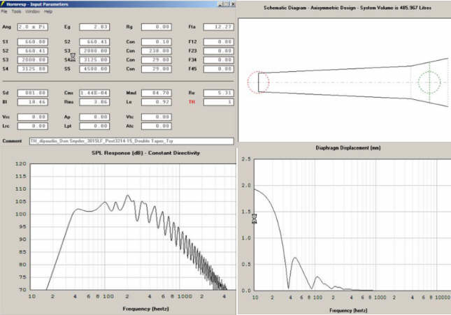

Don Snyder_Single_v_Double Taper
Hi Don,
Thanks for the Single/Double example. One of the reasons I like the double taper horn flare is, that it makes it easier for me to model a horn with the driver in the middle of the mouth flare section (see: LIVE SOUND Specific Tapped Horn thread, Post #349 and #350 - not an isobaric arrangement, in #349 I'm just showing the different speaker directions, #350 shows how to use two boxes together - or one big dual (quad) box,etc.). I find that particular lay-out very adaptable to different length, cross-sections and numbers of speakers. Attached one more 3015LF/double flare/486 liter model.

I had a quick experiment with dual taper also, it does appear to give you a few extra DB's at the expense of a small amount of low end extension. A worthwhile tradeoff if you ask me.
Dual taper is black, grey is single taper:
Single taper (248L)
Dual taper (248L)

Looks like you're loosing 3 Hz to gain 2dB. Iand's suggestion to:
"...use some of the volume saved by the dual taper to make the first section of the horn slightly longer, this will then give the
same LF cutoff as the single taper but still have higher efficiency."
If we reduce the height at the center, then use the saved height to increase the mouth, we don't have any saved height left to
lengthen the horn.
Sorry guys, you can't have it both ways.
~Don
That's true Don...
given a design if you wanted some extra bass it becomes easy to decide which method to choose though. To increase the length of the first half of the horn will add less bulk than to increase the size of the mouth. I think that was perhaps the the direction that the idea was going. Either way the box has to get larger so as you said no free lunch.
What about Tom Danley's trick of using the nonlinearity of air to make using a smaller mouth work to your advantage as in the B-deap design? Just a thought. I don't understand the math so I can't comment but it looks interesting.

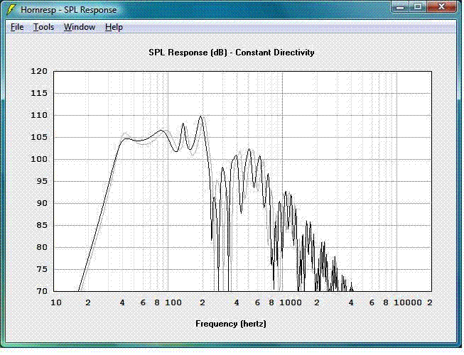

Using MikeHunt's HornResp input parameters, I compared the straight version to a modified bent version, changing:
L23 add 10
L34 add 10
S4 cut 176
S5 cut 295
Now F3 matches between the two versions, and the volume is reported at 248, but the SPL is less than one dB different.
Did we gain anything?
~Don
P.S. grey line is single taper, black is dual taper lengthened.

Thanks for the info guys, this dual taper definitely has benefits with a little experimentation. 🙂
iand said:
You can use some of the volume saved by the dual taper to make the first section of the horn slightly longer, this will then give the same LF cutoff as the single taper but still have higher efficiency.
Ian
Yep I've found extending the path has benefits, I've done a little tweaking, throat, length and many things have changed (box volume is almost the same tho).
New dual taper parameters:
Grey = single taper (248L), Black = dual taper (246L).
I'm shooting for 40Hz extension, so you would think the single taper would beat the dual taper and it does but this isn't that much of an issue because...:
Again, Grey = single taper (248L), Black = dual taper (246L).
The exursion plots are very similar, and because there so little cone displacement at 40Hz, the dual taper box actually has no problem giving out plenty of 40Hz as it's not longer xmax limited and instead power limited. I'm guessing the longer path length of the dual taper allows the low excursion part to go lower the the first peak in the SPL graph maybe?
I've found with a driver like the Definimax 4012 you're xmax limited a lot of the time. Even the Ciare 12SW with 11.5mm of xmax can run out when running higher power... In theory with the dual taper design I can just just as much output at 40Hz as I can at 50Hz with a little EQ and a little extra power from the amp.

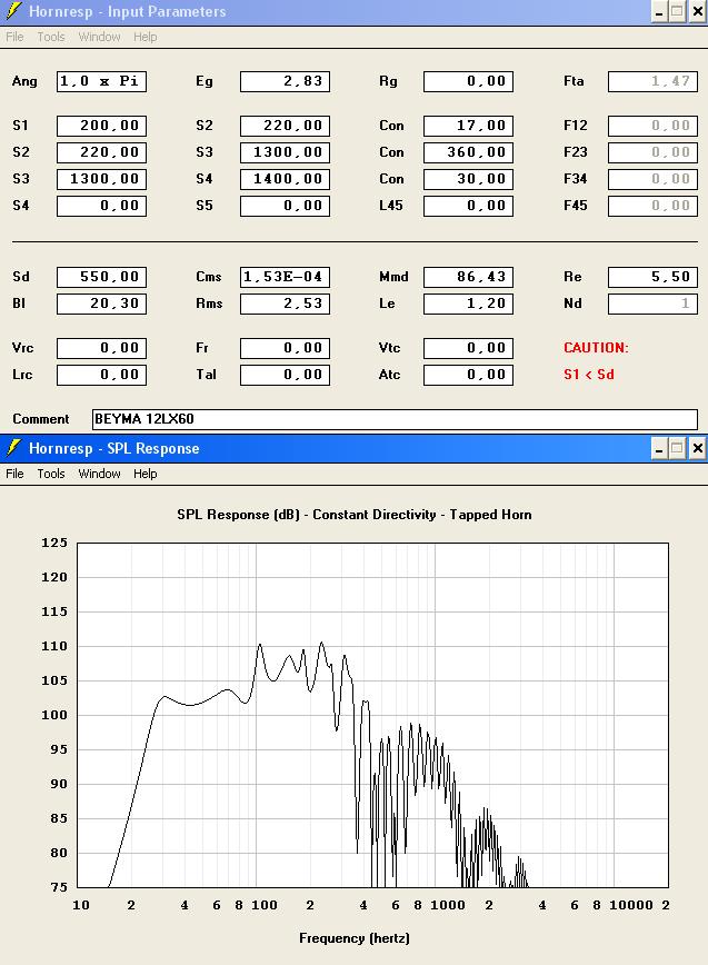

Hi MikeHunt,
I'm long on geometry, but short on intuition. Tom Danley knows how much you can fudge, and he cranked out the fold on the
LabSub in a week. Thats 10x harder than a double taper tapped horn like yours. The LabSub is an 8 taper horn.
If you like, I'll take a crack at your latest this week.
~Don
P.S. take a look at the Beyma 12LX60. Some guys in Germany are using it.
