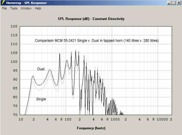

Hi Mark,
Here is a comparison of the MCM 55-2421 as a single and a dual in a tapped horn. Single driven w/ 2V, dual (series connected) w/ 2.83V. Only change in enclosure is that the dual cross-sectional areas are doubled over the single.

Re: Post #3141
tb46 said:
Hi Mark,
you haven't built this, have you?
That's a pretty big dip. Despite owning that driver, I could never get it model right in a reasonably sized TH.

AndrewT said:
how are you doubling the power delivered to the drivers?
Simply paralleling a pair of 8ohm drivers and expecting an 8ohm amplifier to double it's maximum power output will never happen.
Neither a 4ohm amplifier nor a 2ohm amplifier can double it's output going from an 8ohm load to a 4ohm load.
The amp modules I plan to use offer 300W into 8 ohms and 600W into 4 ohms.
How much bigger does a tapped horn get for 2 drivers relative to 1 driver? That might be what I'm missing (avoiding).
