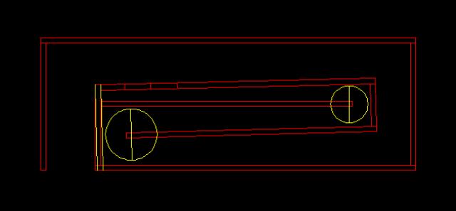

Post #3130
Hi just_a_guy,
I looked at your cad drawing a little bit closer, and noticed that the last section of the horn leading up to the mouth does not expand like the rest, also the distance of the center boards at the 180 degree turns does not allow for even expansion around the bends. I doubt that any of that makes a big difference, but you may take a note for your next prototype. Thanks for the information, keep it coming. 🙂
Hi just_a_guy,
The cad man ended up using volvotreter's folding method, I wanted as little as possible to do with the folding so I wasn't really watching what he was doing but during the physical panel layout I did take the time to make sure that it was constantly expanding through all the bends. The bends might not be perfect but I'm pretty sure they are good enough.
WRT the last bend and the non expansion near the end, see the attached drawing, in particular the panel I added in red (it's supposed to be 5/8, same as the rest of the material). This step was part of the design to perserve the final expansion but in the end I didn't bother with it as I can't imagine it having any practical effect.
If you can figure out the best way to model this send me the hornresp inputs. I wasn't really going to bother but since you're doing the work anyway...

Ok, thanks, that's actually surprisingly close to what I guessed so I guess my translation from design to wood isn't as inaccurate as I thought. The difference between modelled and measured then, is probably due to construction error resulting in the throat being just a bit bigger than planned. (1 mil deviation from the plans is pretty significant in the throat area.)
BTW, if you want to do an accurate model that you can correlate to the frequency response measurements I posted you have to use my measured parameters. Using the factory specs is a recipe for disaster. My measured fs is way higher than factory spec and my vas is way lower, even after being broken in. It's different enough to be pretty significant.
I had a quick look at your proposed changes. That's not exactly the way I'd do it but it's certainly moving in the right direction. Regardless, the overall size and shape is going to remain the same, this is going to be a matching set of 4.
