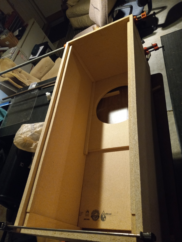

The test cabs are getting close. Ready for the slot port and bracing. I did the crosscuts and rips, and my buddy has been knocking out the precision cuts and glue up! Glenn.

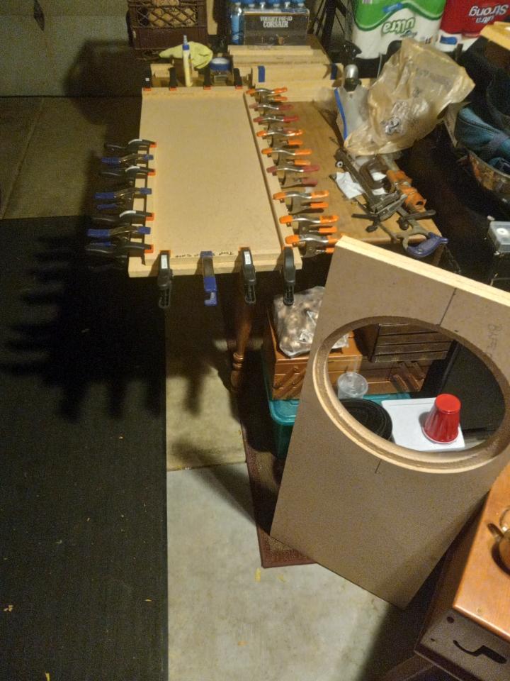

#gotclamps? 🙂
Looks good Glenn! When you've built them and set them up, could you share a sound demo of them on YouTube (or similar)? It doesn't have to be with a high-precision mic...camera and phone mics can tell us quite a bit about the character of the speakers (like this video from Joseph Crowe, for example).
Yes, sir. I'll borrow Jay's Zoom to record some. It has stereo capsule mics and should give an idea. I'll run a db meter too. Any particular tracks that you like? It may still take a bit to get to that point due to schedule, but I want to get them up and running as soon as I can because I'm dying to hear them jam, myself. Glenn.

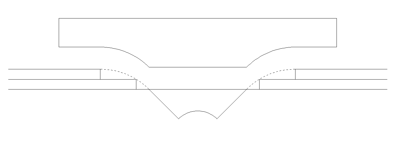

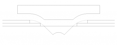

Does it usually take much woodwork to create a roundover that large?
There are so many ways to do this, I've drawn an example of one. Cut yourself a trowel out of thin plywood. Laminate some pieces onto the baffle. Backfill them with filler/plaster and rotate the trowel to shape it.
Fantastic Allen, thanks! For some reason I was thinking that the round-over extended around to the back of the flare (like a Le Cleac'h horn), but I see the concept now - rounding out to the baffle to smooth the transition. Much simpler than what I was thinking! 🙄
