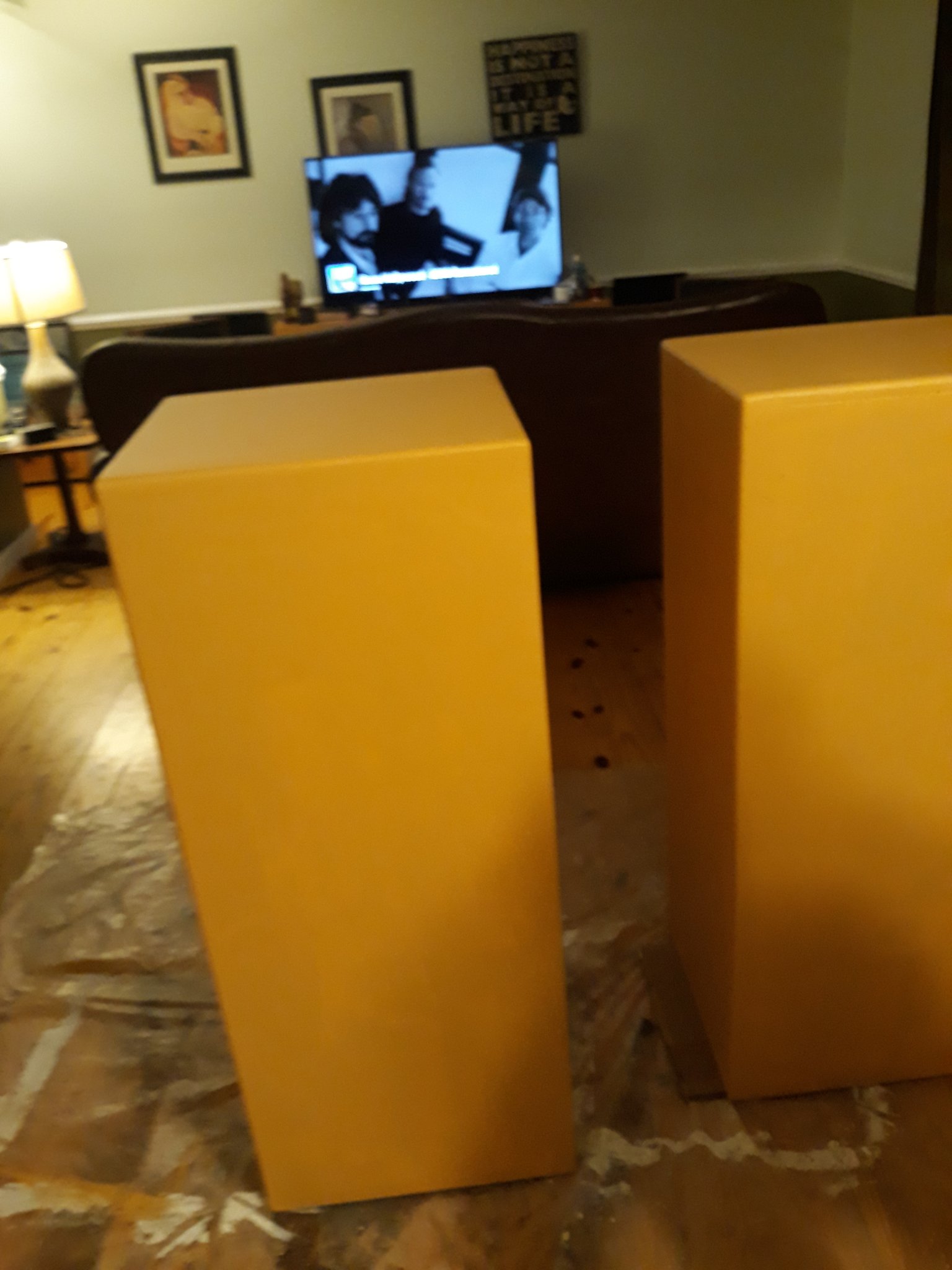

I am slow as molasses, but I finally have gotten around to the finish on the cabinets. I had to steel wool and thinner the first finish off, then re sand and start over. This version is three coats of oil based primer, then three coats of harvest gold semi gloss latex, followed by oil based walnut gel stain faux finish. They became a big art project. I have them drying so that I can finish them with either semi gloss poly, or shellac. Getting closer. Glenn.
