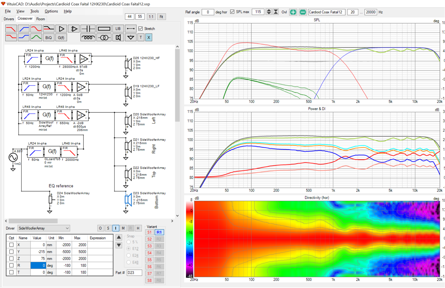

Why the waveguide? Is it to hold pattern control lower?
If so, there is an easier way - cardioid
Say you have a 12" coax driver. Put a 12" woofer inverted polarity on the back of the cabinet directly behind the front. Feed it with about 1.3 ms delay and about -9db SPL/gain relative to the front. You can do an active cardioid and model it that way in Vituix, which is all I've done, or build a passive cardioid. An array of small side woofers also work and control directivity to a higher frequency.
Have you seen the MrSticha thread? He is doing the coax in a waveguide thing.
I should show an example. Here is a Vituix screenshot of a 12" coax surrounded by an array of 4 2.5" IIRC small woofers on each side to get cardioid response with extended H & V pattern control.

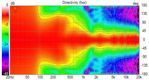

The rear woofer version wasn't nearly as impressive but did give good rejection to the rear for less effort
attachment.php
The directivity model I used for the coax was crude but I think it serves to show the potential of this approach

Actually, I liked the idea of Danley SM80 - and the width would match the stack below it. Cardioid looks like an elegant solution, experimenting with active cardioid is also somewhere on my list, but maybe even lower🙂 The 12XA30 is really good and I would like to have it in a usable box, the current ones have flaws.
If I see correctly in the pictures, Danley just bolts the waveguides to the baffle behind them through the horn flare. Magnets could work, good idea.
Edit: The simulations above look very interesting!
