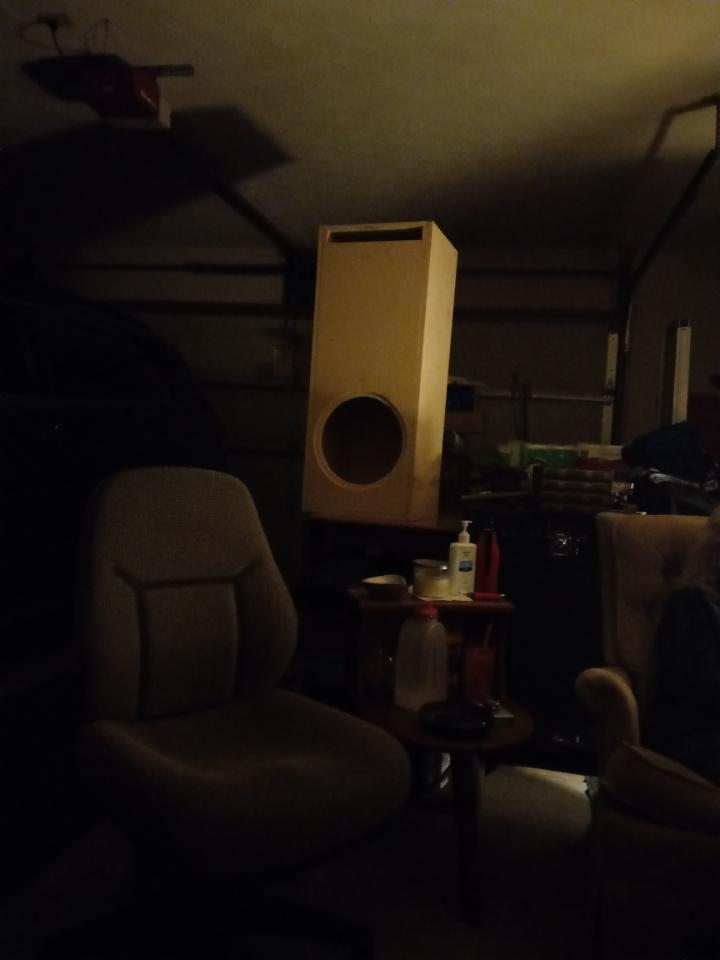

How are the cabinets going, Glenn? I saw that the Vortex-12 kits are now sold out too, so these things are starting to become a rarity 🙂
Left headphone channel ready for lift off, captain! Heehee!
