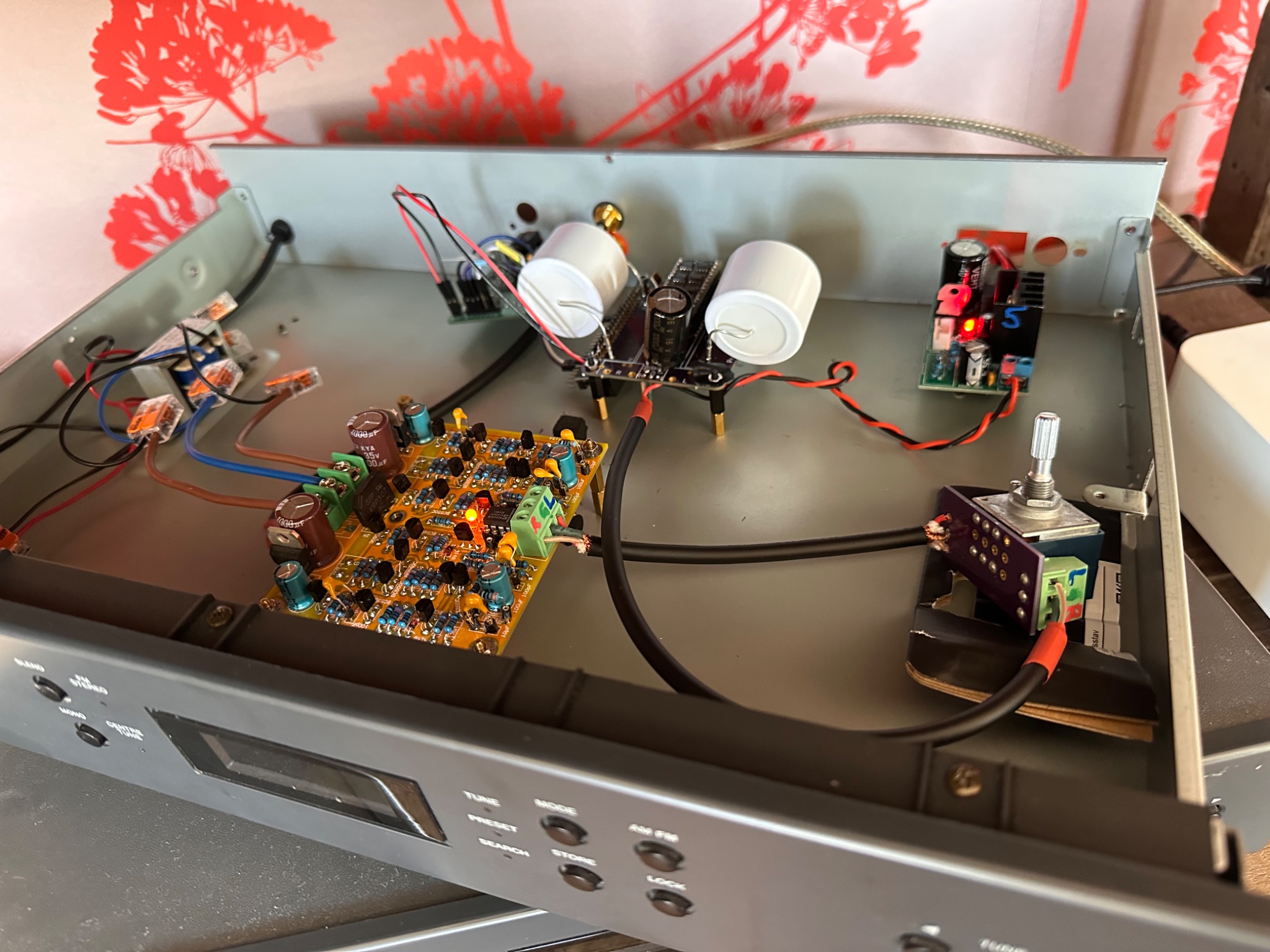

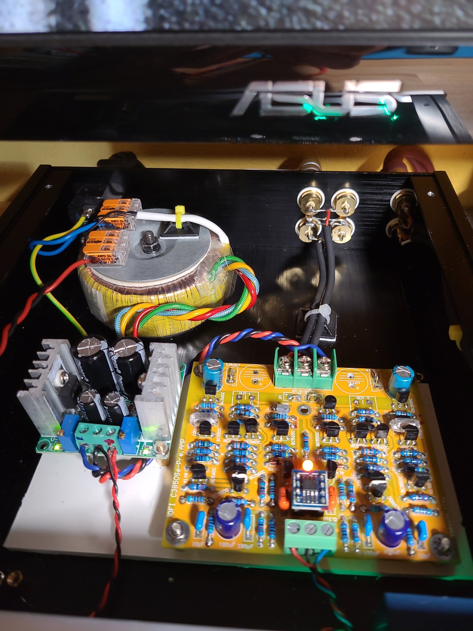

Hello again, after a long time...too many projects...
My very little voltage regulater board had arrived a few days ago from China. The voltage regulators are not isolated to the heatsink and there is no thermal paste. Done two changes, isolated and used a bit thermal paste for better cooling.
Took out the LM7815/7615, big capacitors and the rectifier and made little new connections on the mofi board.
I bulit a mistake in by soldering the new connections. Ground and - were shorted...stupid..searched for half an hour to find this connection. 🙄
I am using a OPA1612 now (like it very much). I had to solder on a small pcb adapter.
With the OPA 1612 i get a wonderful (heavy, dark) bass, better than every Opa i used before. I like the OPA1612 more than LM49720/LM462.
The best news is..the white noise, i had before on my speakers, is gone now. Deadly silence.😀
Perhaps one of the original voltage regulators was a bit faulty. I got different rail voltages, not much, 14,97 volts to 15,02 volts. That could not be the reason.
No matter now it sounds very good. The C3850 can easyliy drive a headphone, like my DT990, with 250 Ohms.
Happy now with this little preamp...🙂
Greets
Peter
