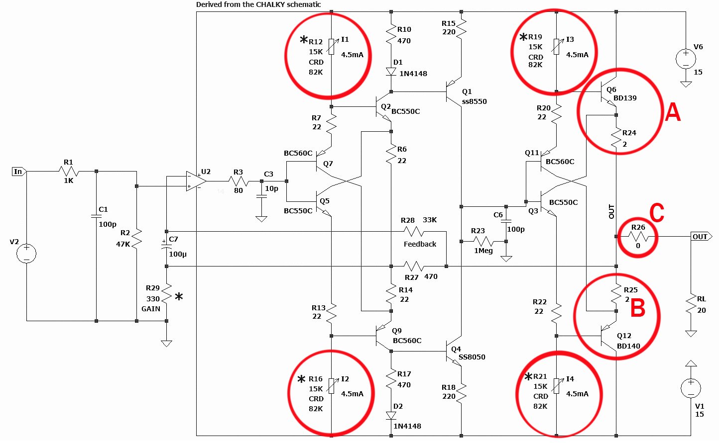

Any modifications to transform the yellow PCB into a headphone amplifier?
Changes like A,B & C would be mandatory to drive the smaller load impedance. The other changes for Class A current and a bit more heat.
Download LT Spice from Analog Devices and use the Chalky schematic and tinker around with it. You can use TIP outputs or OnSemi MJEs etc.
You got to drop those emitter resistors to a smaller value and the series output resistor should go. I'm not sure that series output resistor was ever needed. But that can be said about the entire design. It seems to present as redundant and superfluous in structure. The most obvious question: what is the purpose of the opamp? Flavor? Something to tinker with? It sure ain't no balance line convertor like you might expect it to be...
Driving lower impedances, like 20 ohms headphones, incurs heat and current. Those need to be looked after and embraced for such modifications. Bigger power on the emitter resistors? Heatsinks on the output devices? Does the power supply need to be beefed up?

It seems to be there to...
  • match source output impedance to the correct low output impedance (out of that IC) required to drive Q5/Q7 properly
  • it is part of the negative feedback loop, providing DC offset correction, and the gain setting while ensuring stability through phase compensation
  • it also isolates the influence of power supply ripple from directly affecting the Q5/Q7 (poor-ish CMRR due to simple R12/R16 current control...); the IC at the input takes care of power supply noise rejection, by means of pseudo-balanced input (actual input at NON INV + feedback "input" at INV) and IC's high CMRR figure.
... clever.
Thank you for taking the time Extreme_Boky. I am exploring the idea of using this preamp as a make up stage for summing - does it seem reasonable to sum into the opamp somehow? It would be a non-inverting summing configuration i assume. The sources in this case are identical (two phono preamps).
