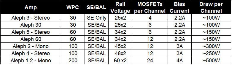

Here you go. I made a spreadsheet of "Aleph Differences" when I set out on this project with all the different resistor values, etc. Here's the big data points I think you're looking for.

Only the xformers are missing (and the case), so before I order, I wanted to clarify the required power. Am I right - based on the sheet above -, that a 300va xformer per channel will do the job? I planned with 400va, but they have the issue with the high inrush current which requires a limiter. So, will 300va go? And if so, what would be the value for the snubber resistor?
Many thanks in advance.
Stupid me... Is the NTC the dedicated inrush current limiter? If so, there is no problem...
The CL60 on the CL60/AC-Cap board is the inrush current limiter.
The other CL60 to ground is the hum buster.
If you're using the CL60/AC-Cap board, you're covered.

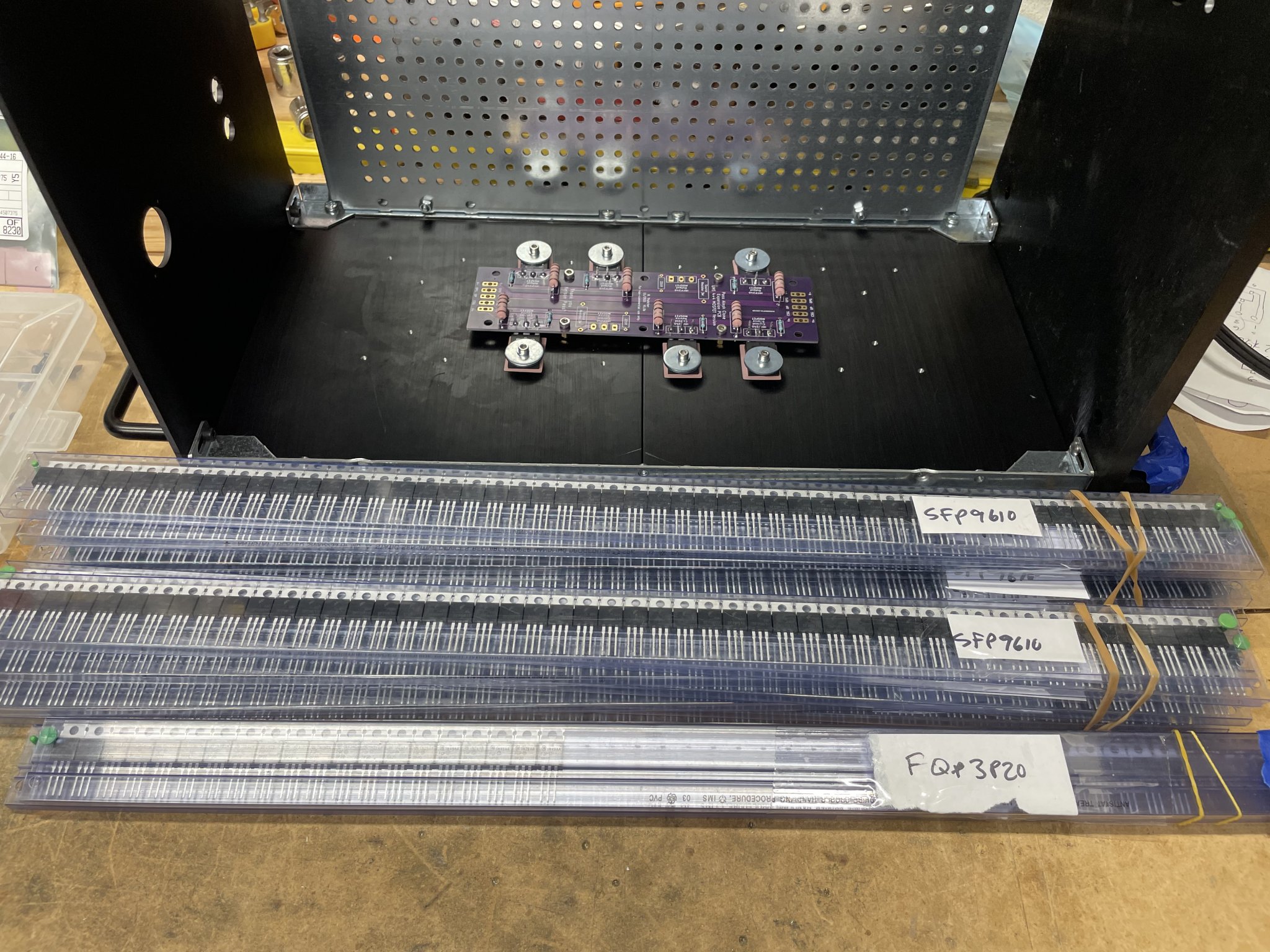

If I am unable to procure the 2SJ313 matched pairs, but am able to buy a bunch of FQP3P20’s (which appear to be plentiful) and given the current source (CS) being 20-22mA in the Aleph 60 input stage (5V across resistor R11: 220R), would I match the FQP3P20’s for 10mA so they can equally share the current from the CS as closely as possible?

I’ve got you covered if you don’t feel like matching. These are already matched.
