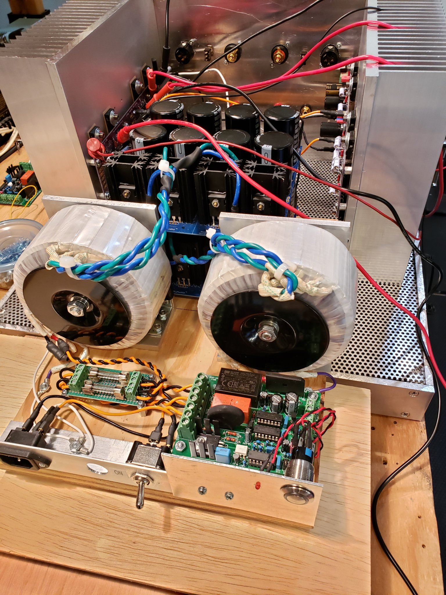

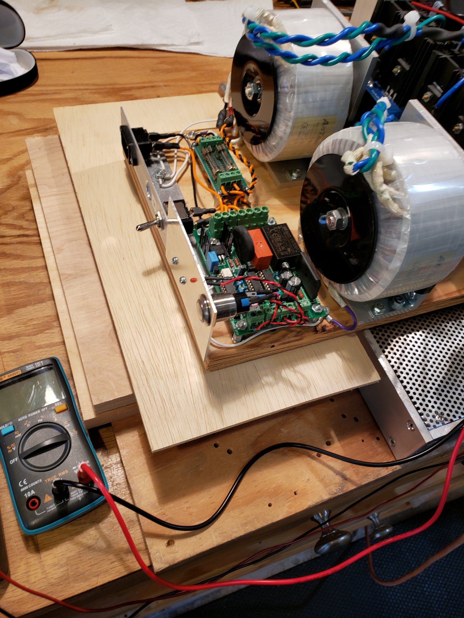

I didn't test my PSU in stages, just built it up & powered it on without hooking it up to any amp boards. I have an incandescent light bulb in series thing use to power it on the first time, and I watch for the filament to go from bright to dark as a sign that things are working as they should. I'll frequently use the light bulb when the PSU is powering up amp boards for the first time too.

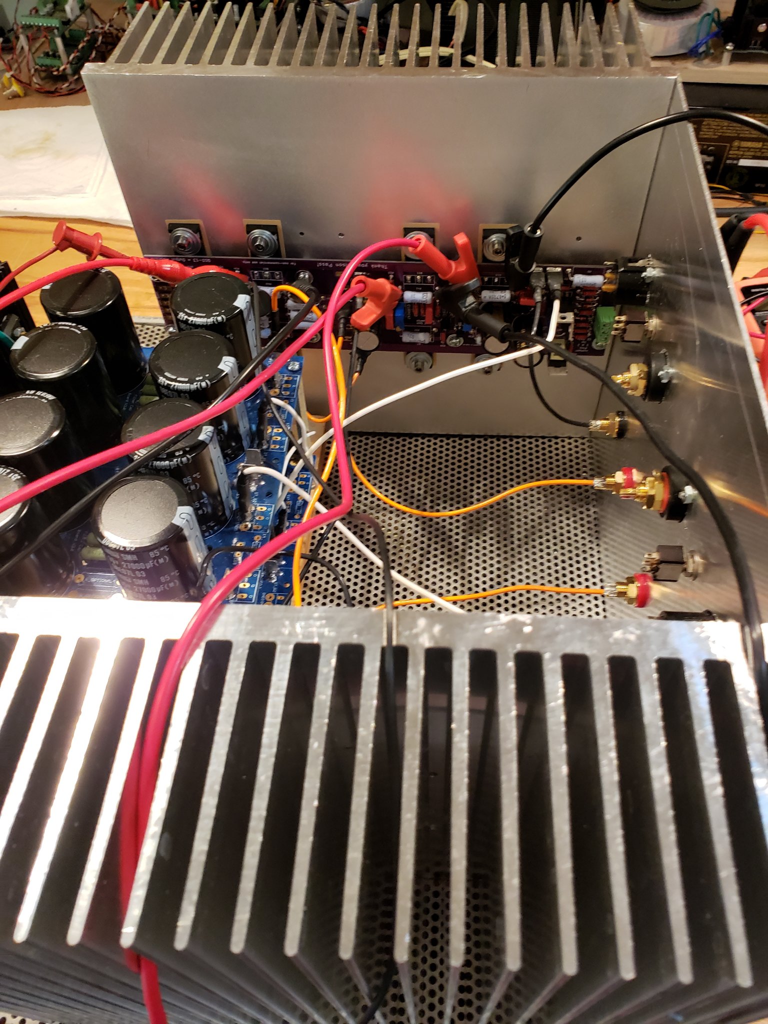

I have filled the fourth pair in my set of boards as you were thinking of doing. I really don't think you can call it an Aleph 40 because I think that there were differences in component values and voltage as well. I used two Antek 3220 transformers in dual mono configuration with 216,000 mf per channel. That configuration provided 29.3V unloaded and 25.8V loaded. In my test configuration I biased each device for around 0.7A, which gave me about 2.8A per channel. I found the 240s so well matched that little adjustment was required for the bias and offset. I will wait until the amp is in its final case before adjusting the AC gain.
I did a quick listening test to compare it with my Aleph J and found the base was better and it sounded slightly darker. I didn't play it for very long as it was under heatsinked even with the babysitter I was using, so it was more a proof of concept than a reasonable comparison. I plan to install it in a deluxe 5U 400 and see how much bias I can get out of it. It is going to be the top end for my LX Mini speakers with a pair of F5 Turbo V3 monoblocks in 5U 400 cases for the bottom end. As the impedance is 4 ohms for these speakers, I need all the bias current I can get.

@rpafenberg - that's not enough heatsink!?!! How hot was it getting?

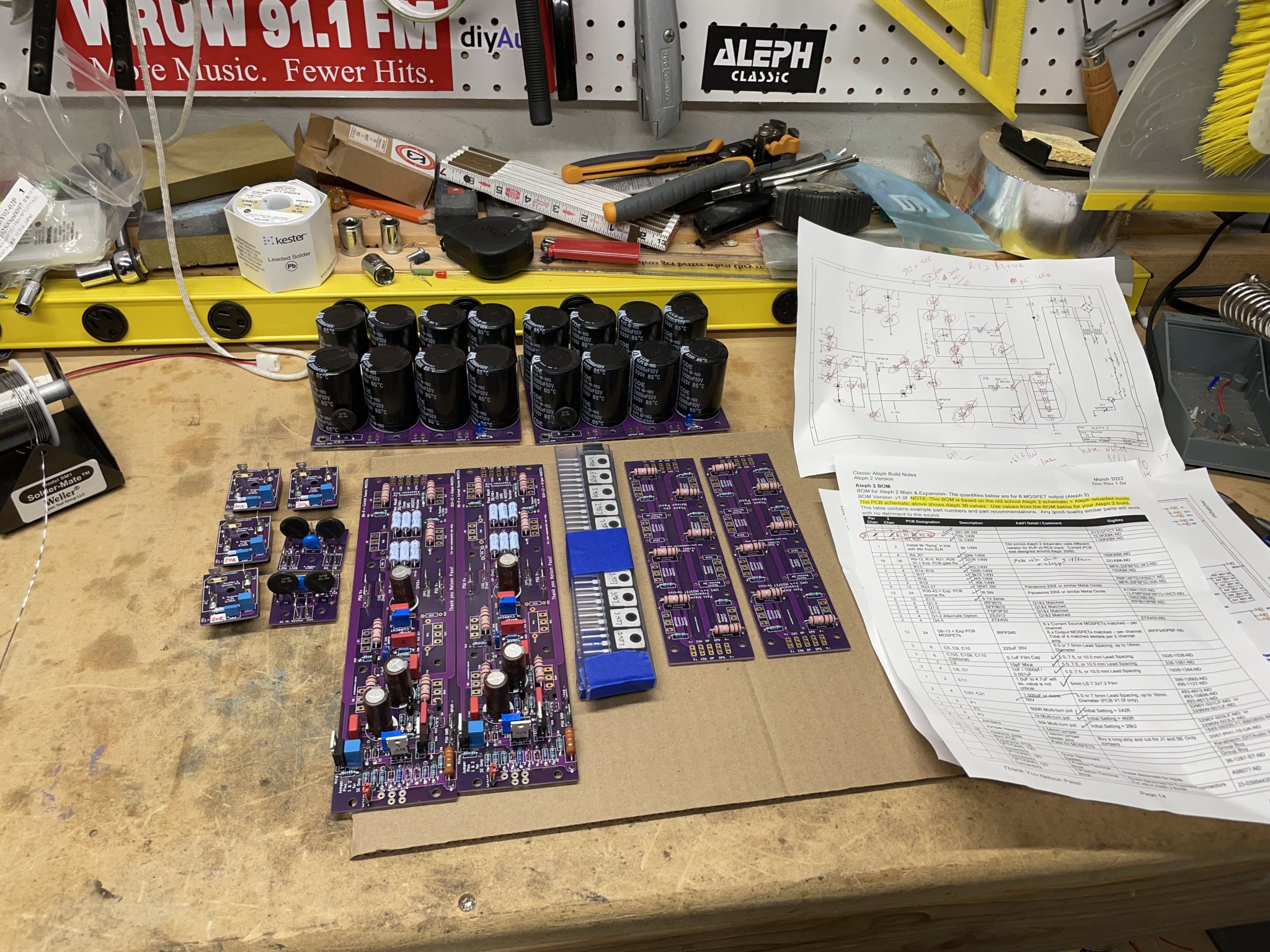

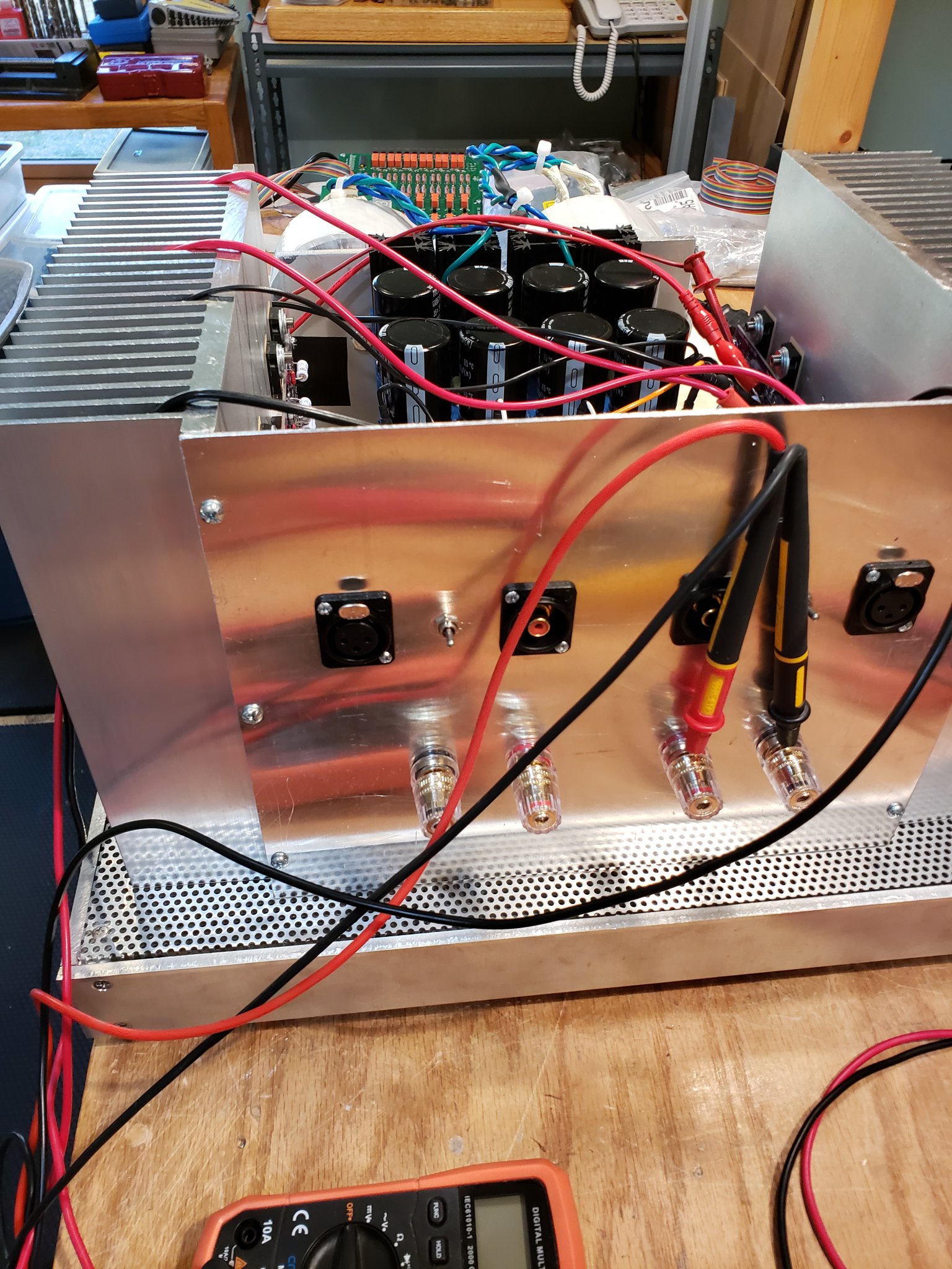

For the fearless Aleph 2 builders, I have all boards and 2 5U chassis ready to go for a pair of 2’s. Next up is assembly, wiring, test/cooking. My household is getting over a mild case of Covid-19, and I’m back to work at my day job on Monday. There will be plenty of catching up to do. I’ll see where I can get bench time in over the next 1-2 weeks.
I did a copy / paste job to the Aleph 60 build notes for a new Aleph 2 document. I’m building based on my draft document. Once the first mono amp is up and running I’ll publish the updated document.

Glad you are on the mend. Work woke me up in the middle of the night and I couldn't go back to sleep. I was staring at the picture in the middle of the night trying to figure what the difference was between the Aleph 60s you built and this Aleph 2. Looking again this morning it seems like in the Aleph 2 the 1st and 4th mosfet positions have fets up and down while the 2nd and 3rd position has one up and then one down, where the Aleph 60s had 6 matched pairs up and down using 3 of the 4 positions. Looking at an old Aleph 2 schematic compared to the schematic in the UMS Aleph 30/60 they look very similar. So, what am I missing?
Also, if memory serves me well you have some very efficient horn based speakers at home. What do notice going from the initial Aleph 30 build to the Aleph 60s monoblock in an efficient speaker?

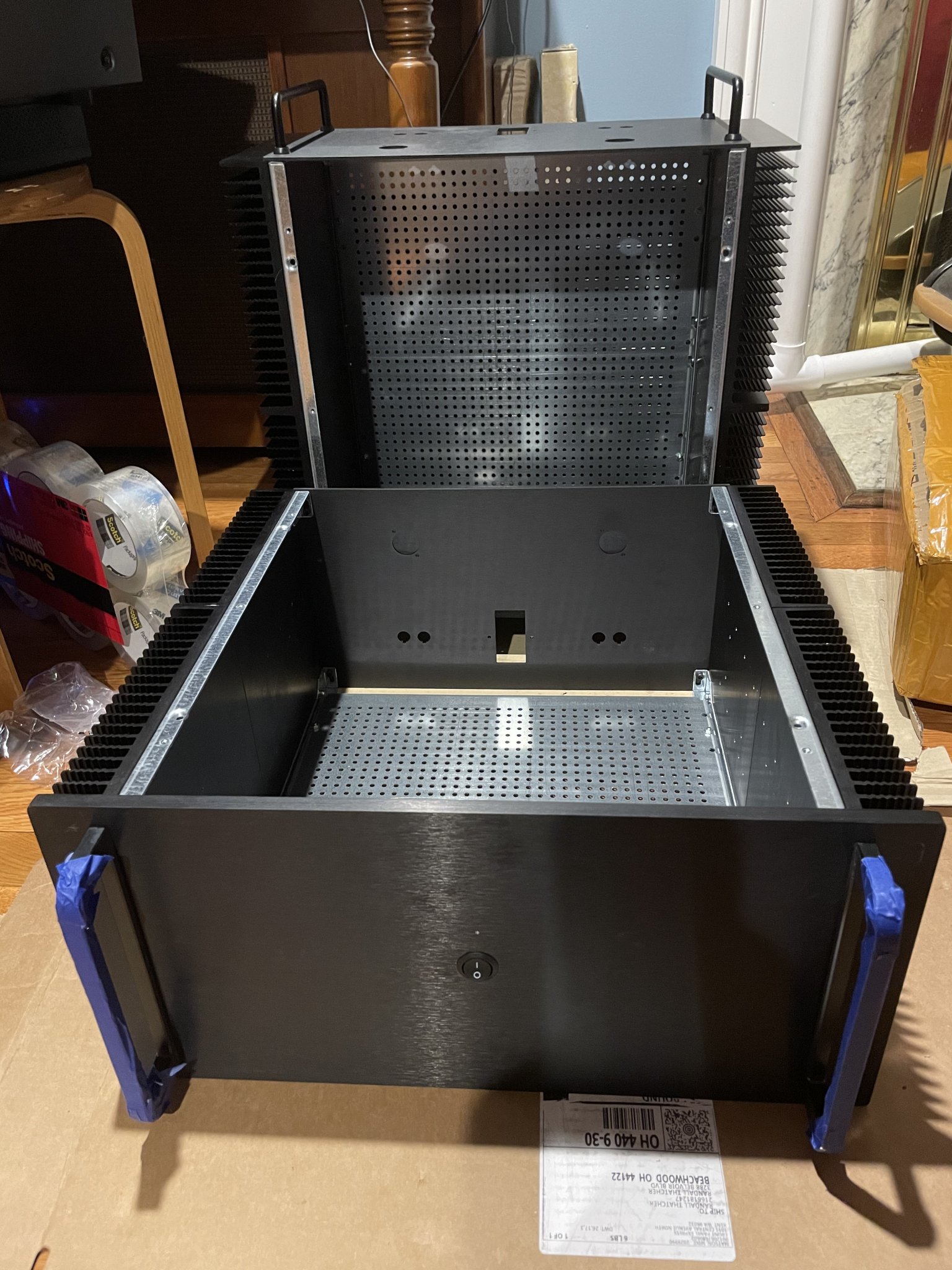

Aleph 2 has bigger chassis (more heat sinks!), higher rail voltage (different donuts, higher rating on psu caps), and some values change on the boards. MOSFET count is the same.
There are 4 heat sinks on the 5U deluxe psu, so my strategy is to put 3 MOSFETs per heatsink. Therefore this time I’m very deliberate in how I space them out. That’s a note I’ll be making in the build document.
Regarding differences, I think the sonic signature is consistent.

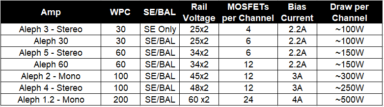

What’s the rail voltage on the Aleph 2? Overall Bias? And by knowing that, the overall dissipation per channel would be?
Is this is a 5U/500 or 5U/400?
I haven’t ordered my donut, chassis or capacitors yet, so this may be an option ;-)
That being said, I would like to use the 4U/500 which may or may not suit depending on the overall dissipation. More of a mental exercise since the increase in power is immaterial in my system, given that my mains are 96dB sensitive.

The only 2 MOSFETS that matter for spacing are Q6 & Q10, they must be populated. From there they can be in any position. Mix and match. Just make sure the total number in the "up" positions (current source) is the same as the total in the "down" positions (outputs). I wanted this to be a flexible / swiss army knife setup. Good for Aleph mini, 3, 30, 5, 60, 2, 4, 1.2, and beyond.
If you wanted to make an Aleph MINI with 1 set of MOSFETS, use positions Q6 & Q10 and leave the rest empty.
Bigger than a Mini? Mix and match with main + expansion board(s) to distribute around the heatsinks.
I haven't done any THD measurements or spectra on these, funny enough. I build, warm up, twist the pots, cook more, and do final test / adjust. Then it's off the bench and time to listen. They have the "Classic Aleph" sound I love.
I think the “Swiss army knife” approach is brilliant. Start with an Aleph 30, not enough juice for your speakers add the expansion boards and boost rails to Aleph 60. Still haven’t got your AC/DC up to 11, bigger donuts, bigger rails and bigger bias/chassis gets you there.
@CoGT3
Referring back to your question. Although I haven’t measured the THD yet, I would imagine, given that it is a Pass design, that higher bias will lower THD at the 1 watt level down to a certain point. That being said 2.2A is already quite a bit of bias. I also imagine that the THD will be lower at certain power levels when you compare one amp to the other. For example, when the Aleph 3 is clipping at 30 watts (and THD is >1%), the Aleph 2 is just loafing along. So differences may be heard at much higher power levels.
It’s important to find a set of sensitive speakers you love since it can be cheaper in the long run. Alas, we are FAB’s and these amps won’t be our last ;-)
Thanks for the table Randy, answers everything!
