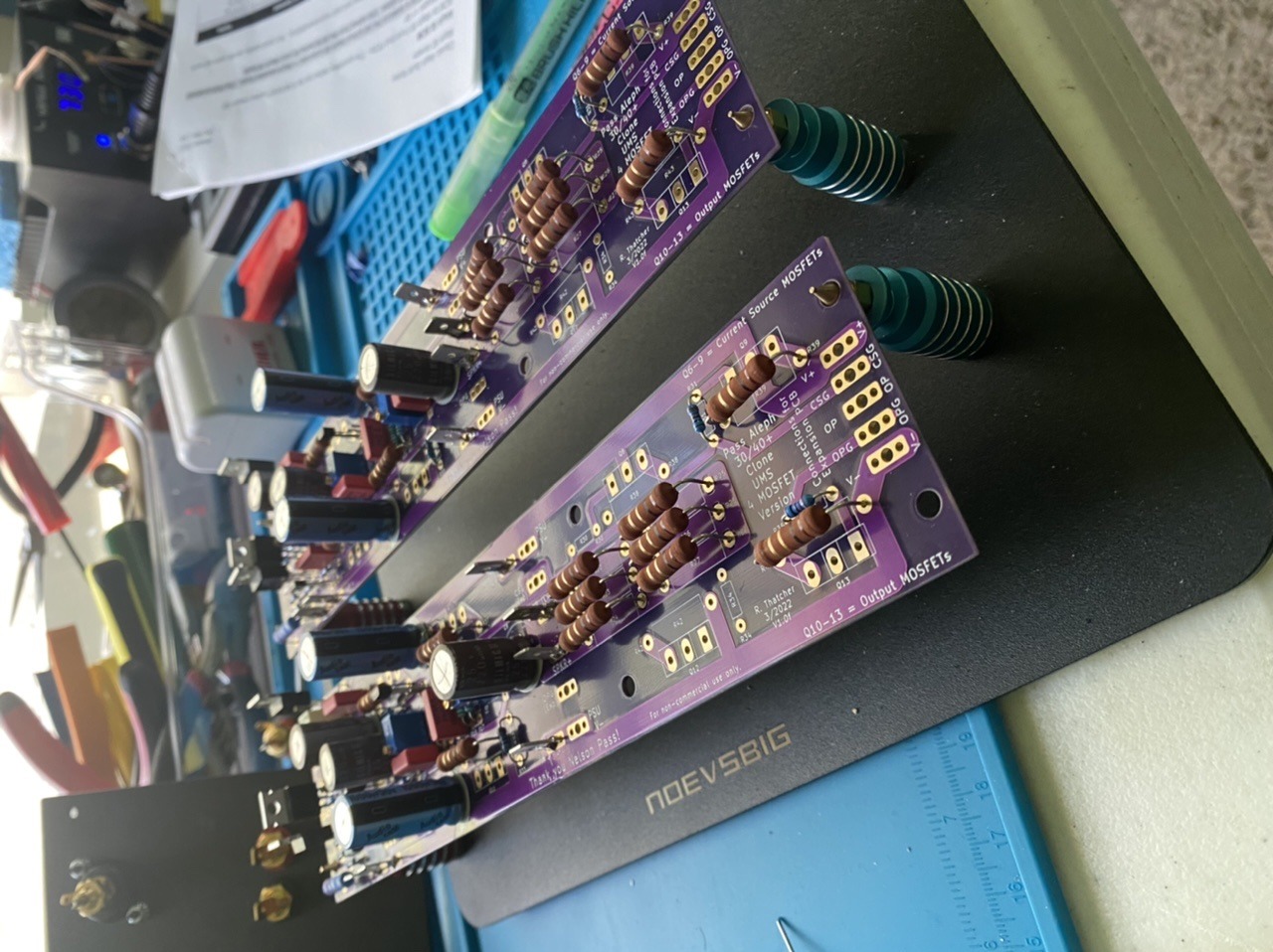

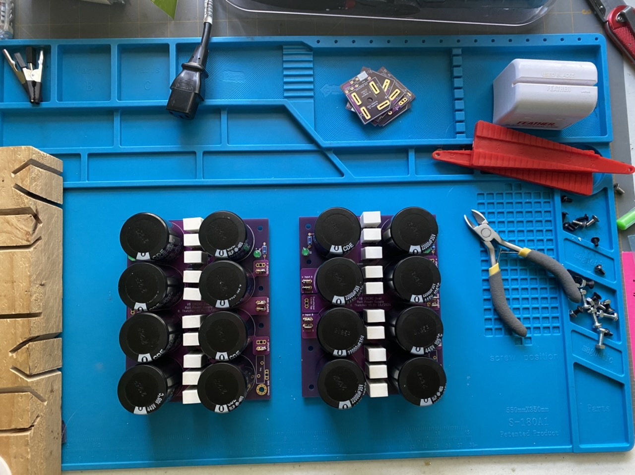

Getting started on my build.
Last week I finished the F4, so being an apparently Foolish Amp Builder, I'm turning my attention to the serious project, the Aleph 60. What's that? It's Fearless Amp Builder? Oh, my bad.
This will be done in monoblocks with the new modushop chassis, front end board on one side of sinks, and the extension board on the other. I'm also intending to put in a balanced or single-ended input selector switch, and have the outputs to two pair of binding posts for bi-wiring.
I spent some time yesterday and today stuffing the PSU board, the extension board, and am starting in on the amp boards.

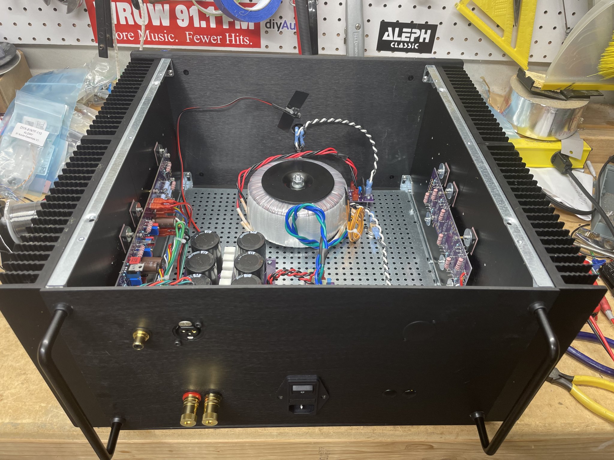

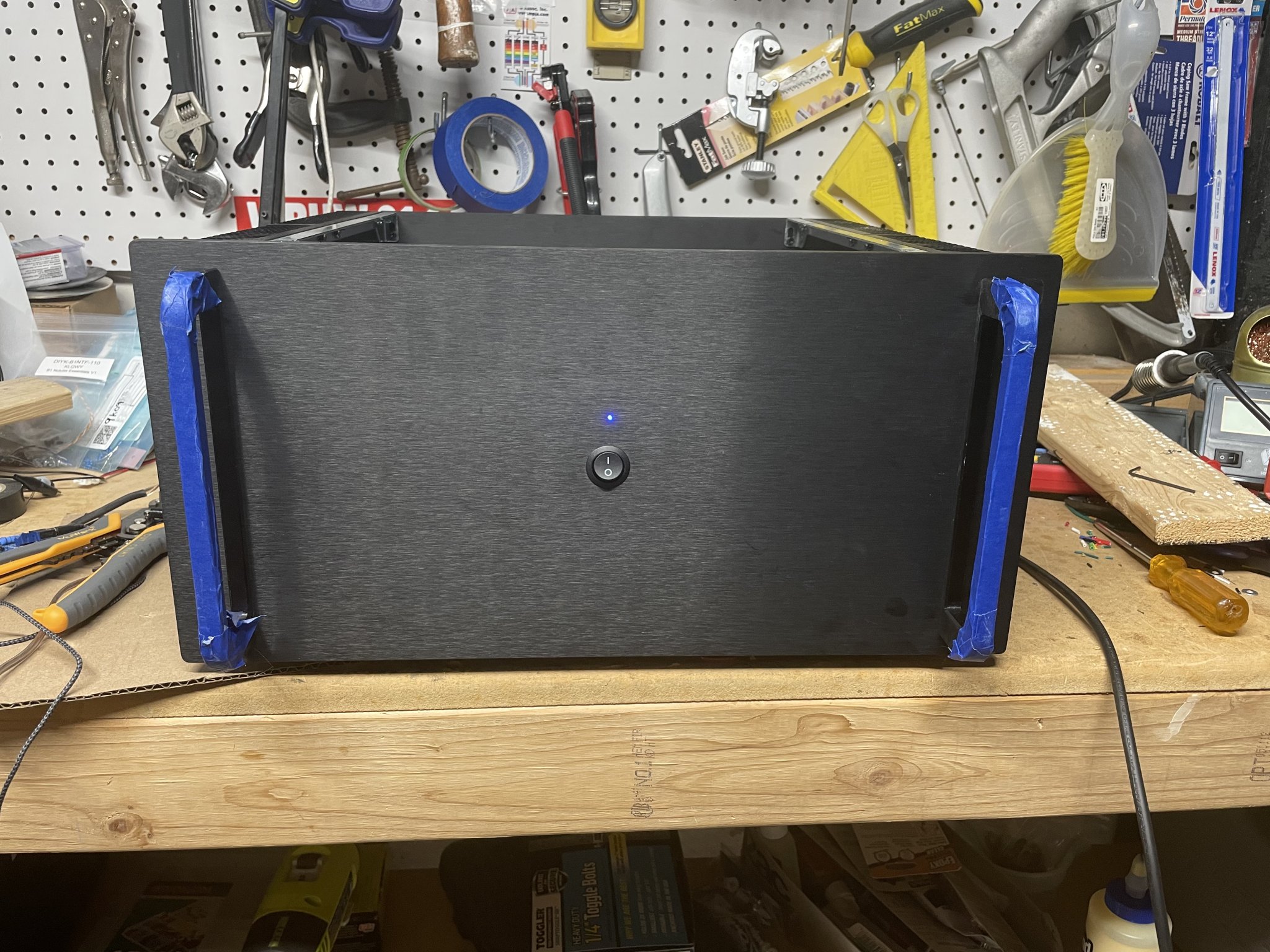

I have one Aleph 2 mono built and I fired it up tonight.
3.0A bias
<10mV DC Offset
44.6V rails using antek 35+35 600VA Donut.
It’s in a 5U deluxe chassis which was running at ~52c after about 30 mins of playing music on the bench and testing / making adjustments. I need to do a final bit of wire dressing and do the final donut spin and tightening. Then I’ll put the covers on and let it cook a while to get a temp measurement at equilibrium. It will be a hot one.
I’ll publish the build doc tomorrow and post pix.
I also plan to post pix of doing P2 AC gain setup, too.

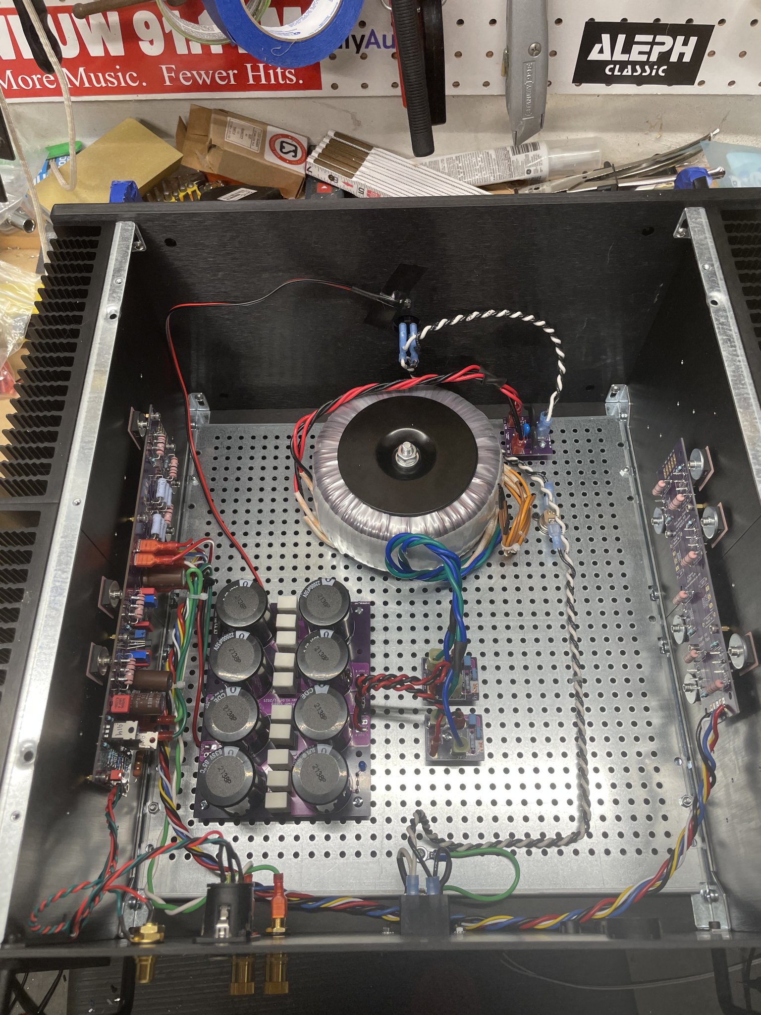

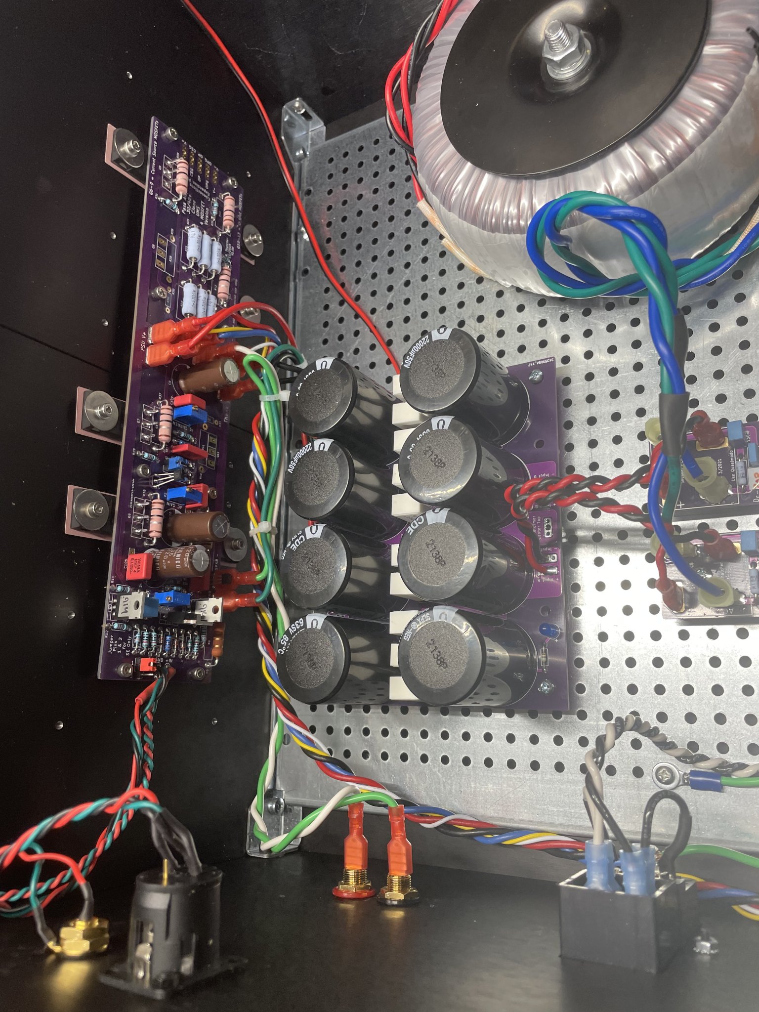

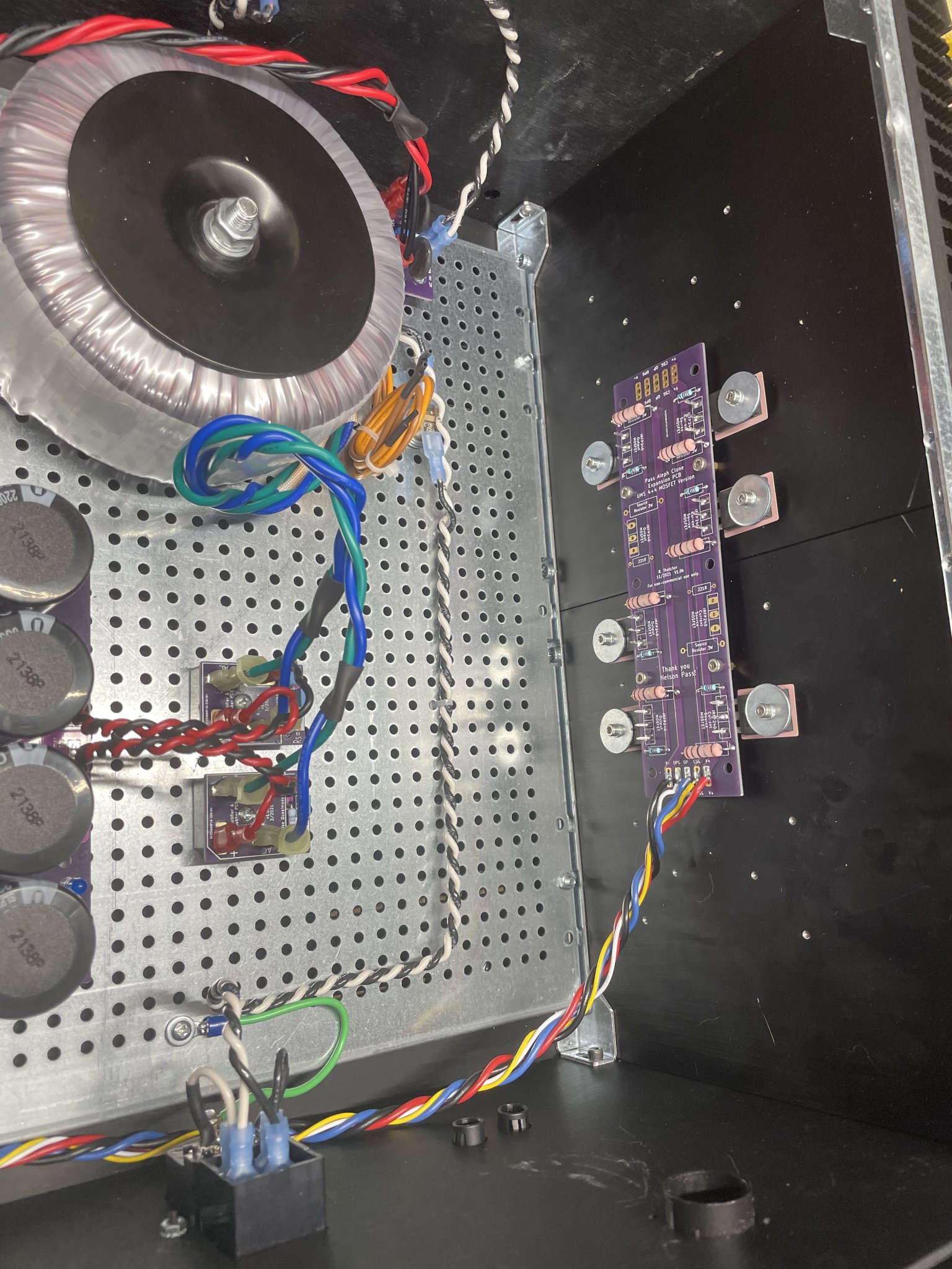

Aleph 2. 1 down, 1 to go.

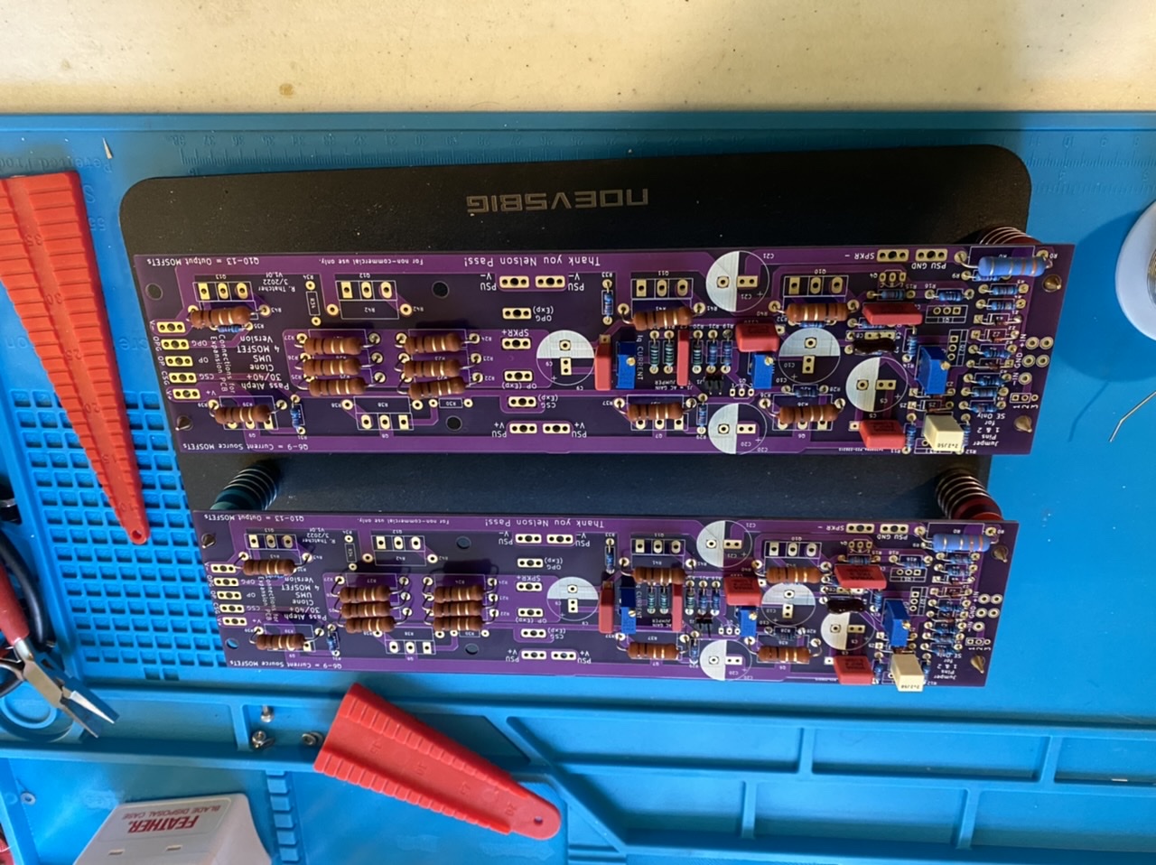

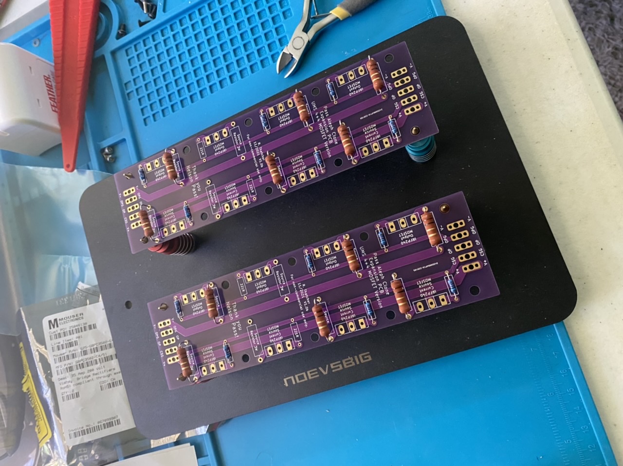

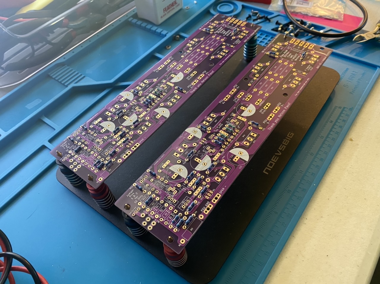

The twin cities of Alephopolis are populated and ready for moving in.
I put in C20, C21, and went to cross them off my schematic. Not there. Huh? Looked at the BOM, not there. Well then, they're on the PCB and you bought them for a reason, go look it up. Sure enough, a search of the thread for C20 and Randy had documented it. I really need to change my reference schematic and BOM to the latest revision, eh?
