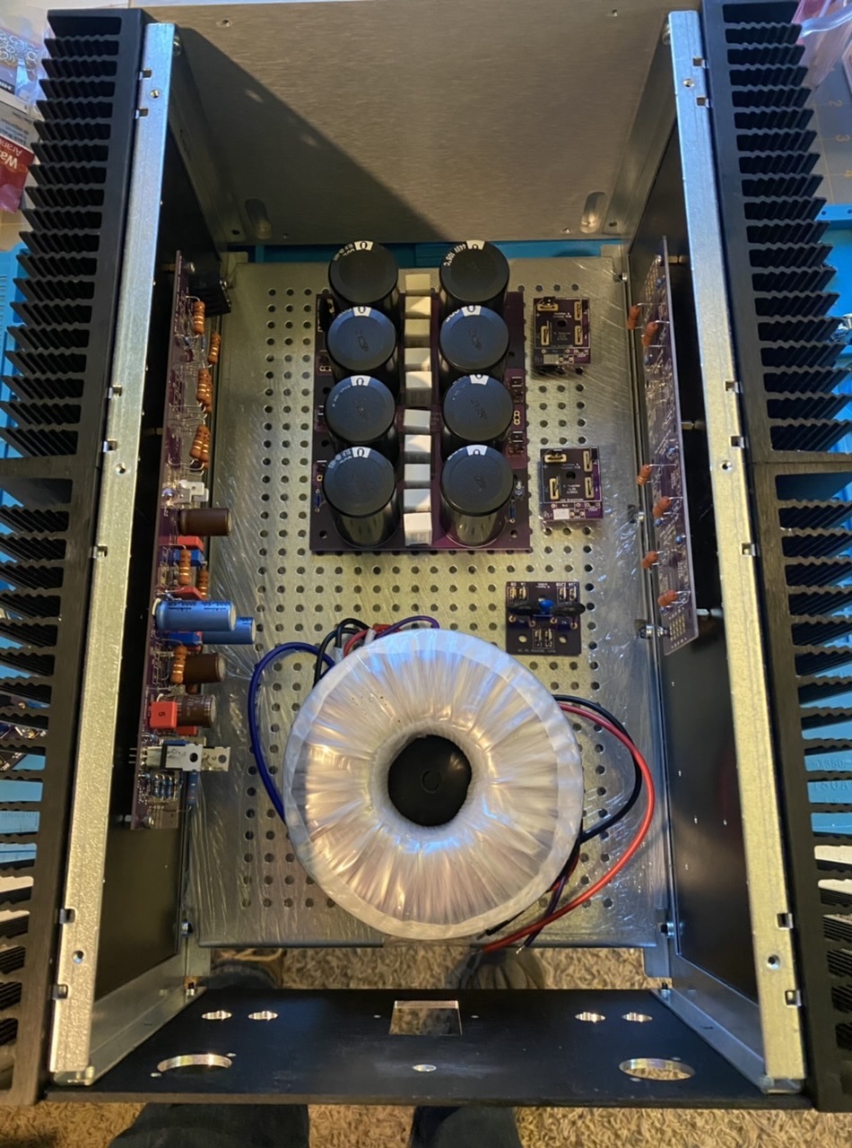

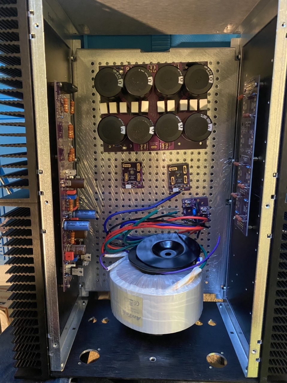

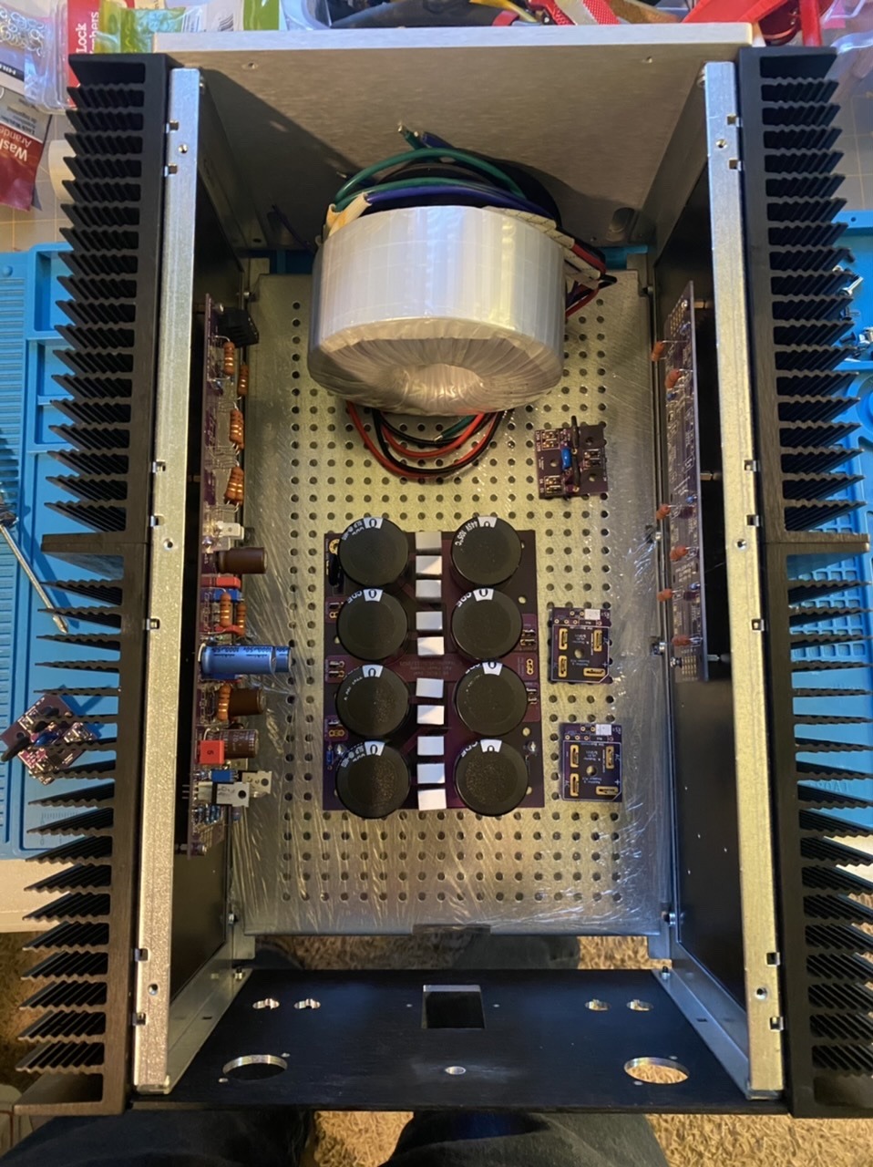

Time for some layout decisions.
I just hate drilling l-brackets for the transformers. I’m lousy even with a drill press.
Opinions on fundamental transformer placement? Umbilical between main and expansion boards will be routed along the front of the box.

Donut in front as ZM pointed out.
Consider the umbilical in the back. See the Aleph 2 and 60 pix I did in earlier posts. I’m quite happy with the results of this config. To keep that wires short maybe move the expansion board back a little.
You may consider leaving the donut loose for testing on the bench. Put it down on the chassis floor and see how it goes. Twist it for lowest noise. If you’re happy, bolt it in. If you need to put it on an L bracket you can test with it sitting on the side without a bracket first.
What donut size? 400va? I got the Antek donut cover for the 400va I put into the A60 monos I built. That’s also a possibility of needed.

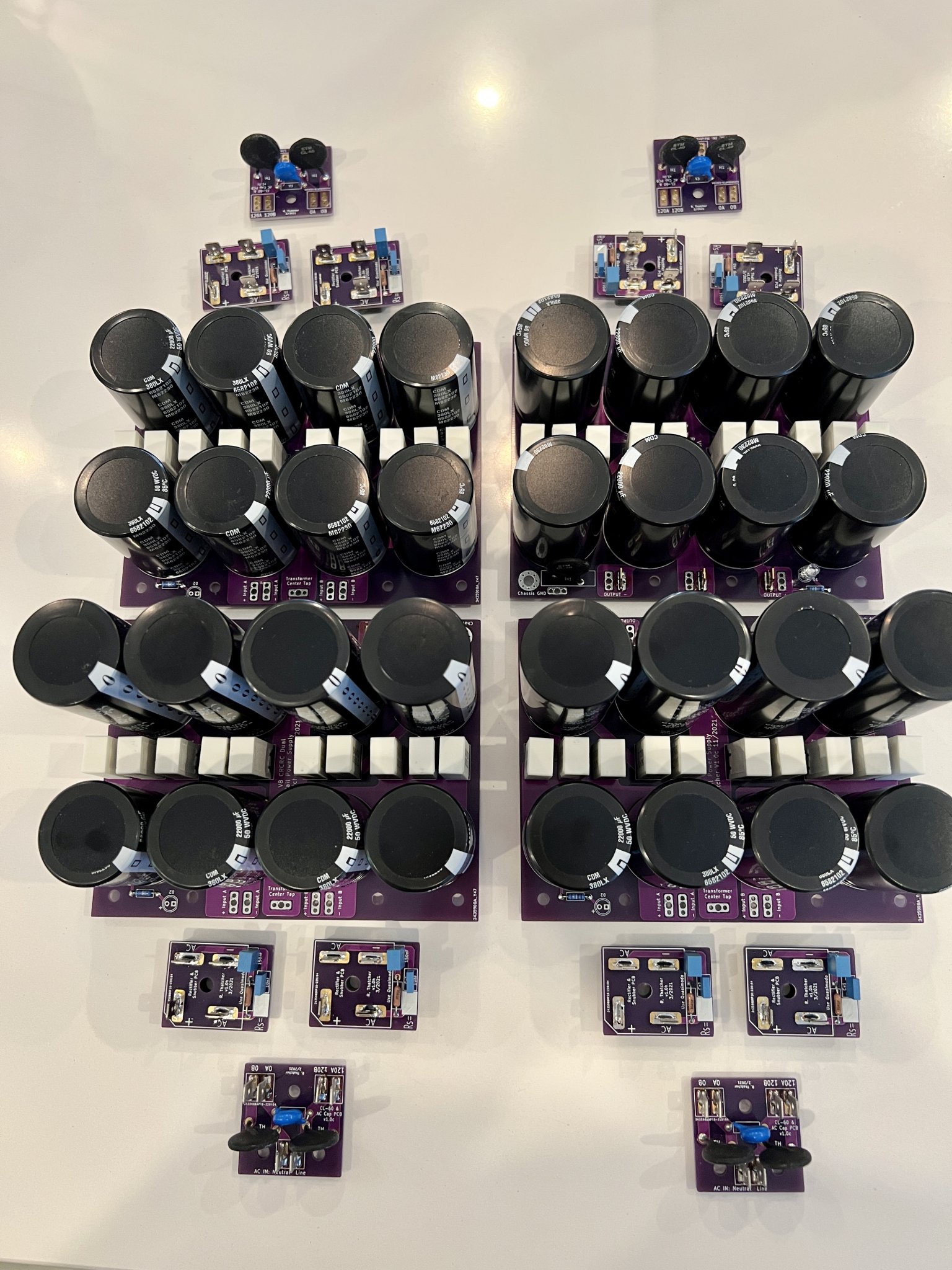

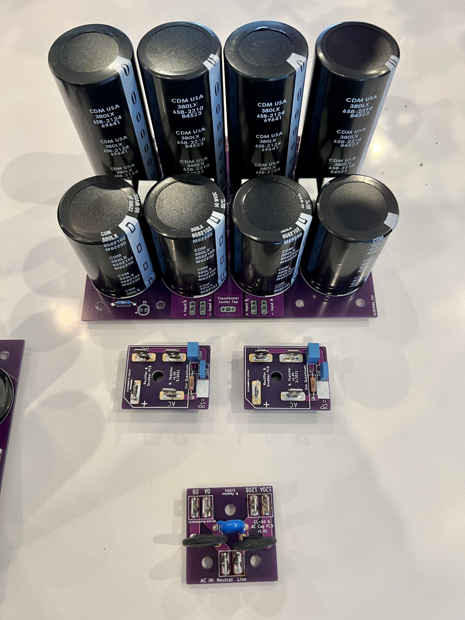

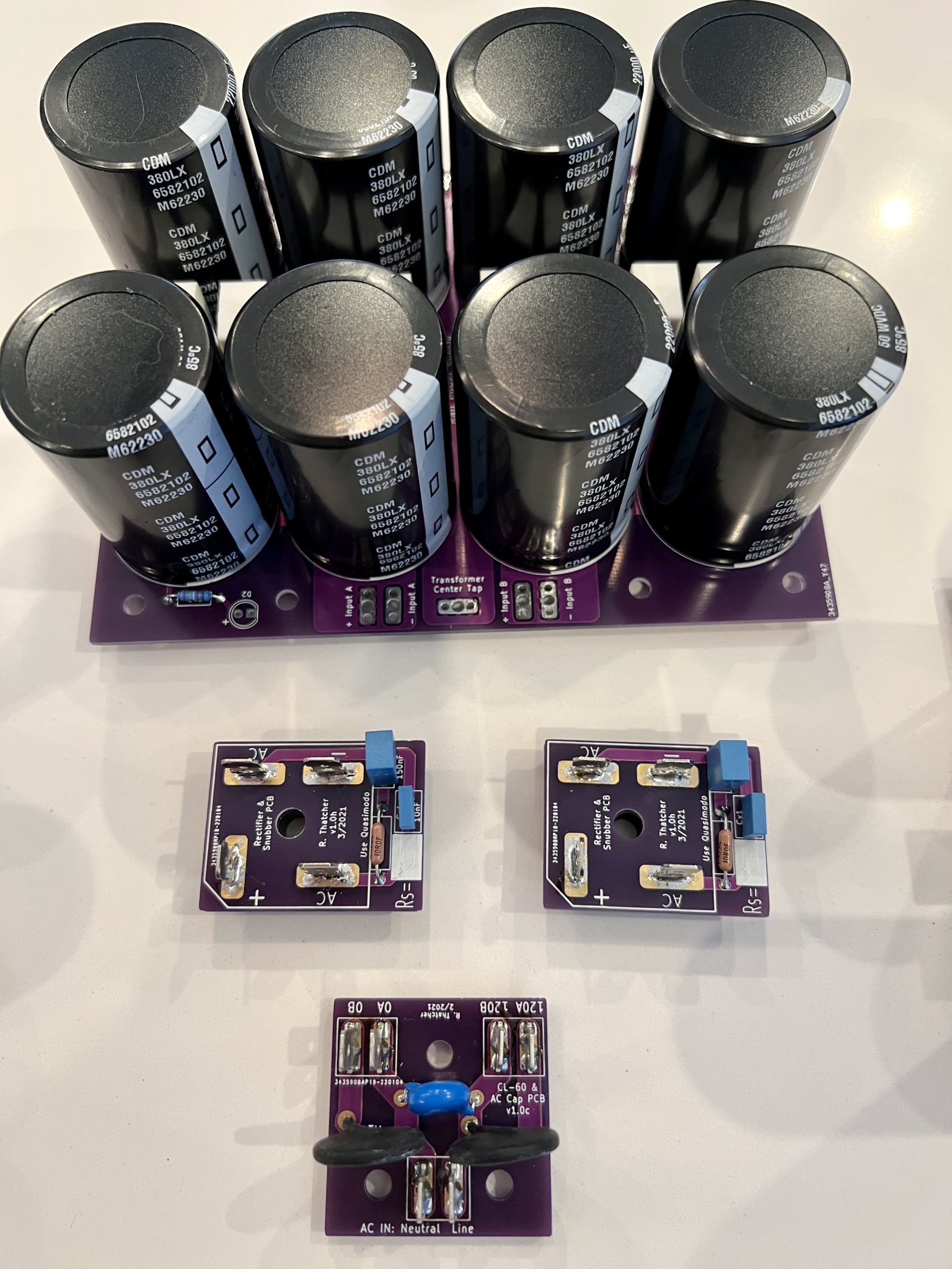

Soldered up Randy‘s CL60, snubber, and V8 CRCRC boards. This was my first PS boards and where super easy to do. Love the ceramic 3w resisters, drop them in, flip them over and away we go. Definitely took way more time to acquire, sort, run the parts through the Megatester then assemble/solder. Now if the store would just get those pesky Aleph J amp boards in so I can order up my chassis and build up an Aleph J and Aleph 30 (Aleph 30 gets the bigger caps, it’s only a matter a time before it becomes Aleph 60s).

I have one Aleph 2 mono built and I fired it up tonight.
3.0A bias
<10mV DC Offset
44.6V rails using antek 35+35 600VA Donut.
It’s in a 5U deluxe chassis which was running at ~52c after about 30 mins of playing music on the bench and testing / making adjustments. I need to do a final bit of wire dressing and do the final donut spin and tightening. Then I’ll put the covers on and let it cook a while to get a temp measurement at equilibrium. It will be a hot one.
I’ll publish the build doc tomorrow and post pix.
I also plan to post pix of doing P2 AC gain setup, too.
