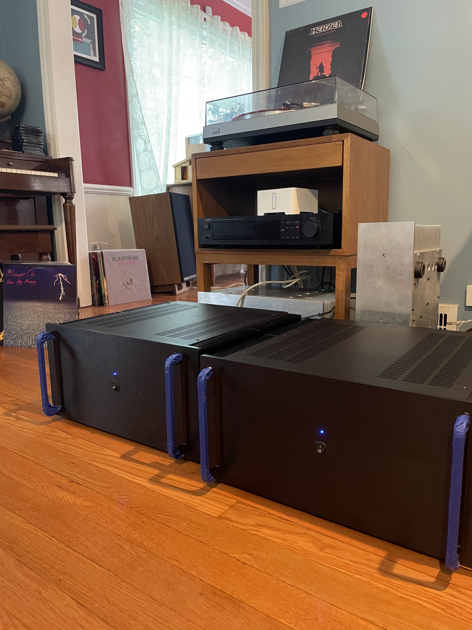

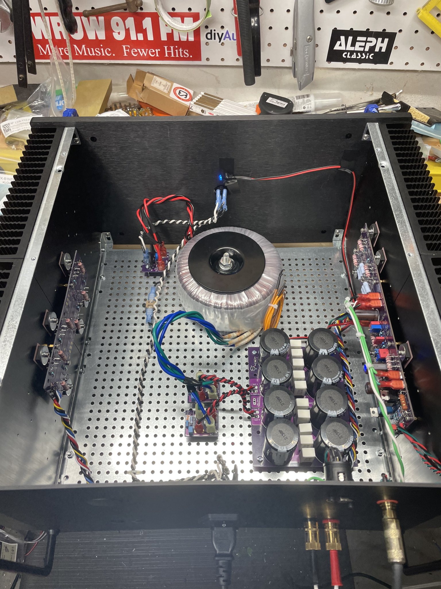

Aleph 2 monos are off the bench and playing music! These are using 5U deluxe chassis and the internals match the build doc in post #1. I know a few of you fearless builders have Aleph 2’s in your plans, go forth with confidence.
These run at 44-45v rails and 3A bias. Fantastic sound.
Note: blue tape is to prevent scratches on the bench, not a secret mod...

This is probably a question for Randy or Ben. What type of wires do you use to allow you to twist them so tightly together?
mains: 14 ga THHN
DC, umbilical, speaker: 16 ga stranded hookup wire
Input: 22 ga stranded or Ethernet cat6
I put one end of the 14/16 ga wire in my bench vise and the other end in a drill. Then spin it to make a nice twist. For the signal wire I use the drill and hold the other end in my hand.
