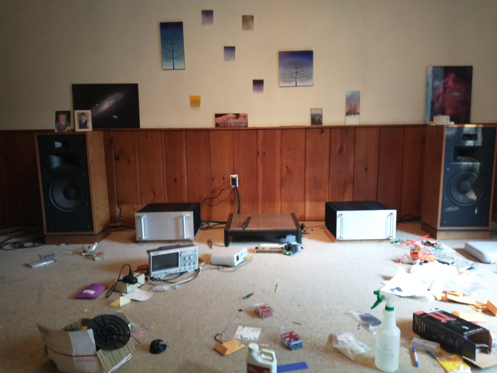

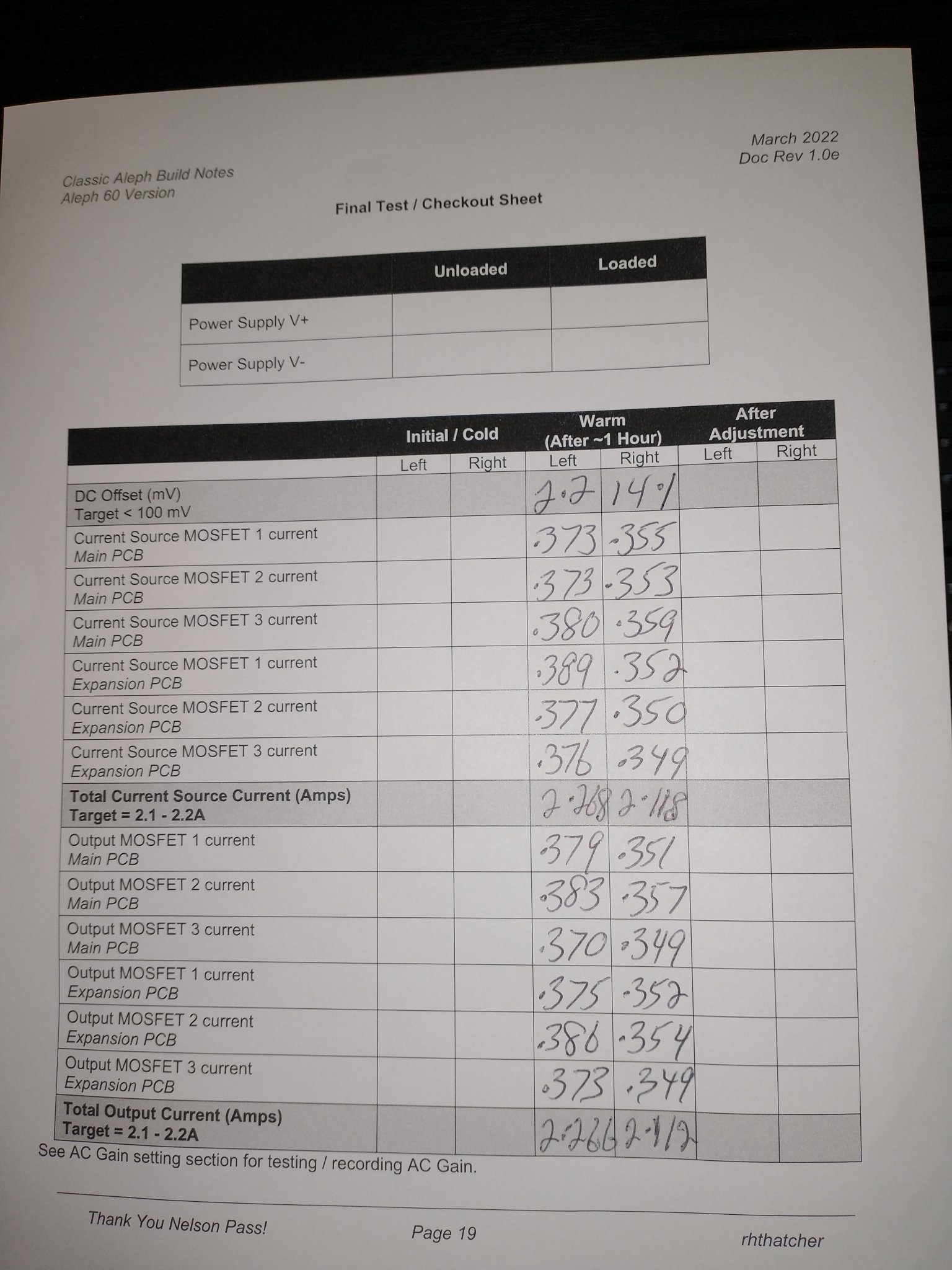

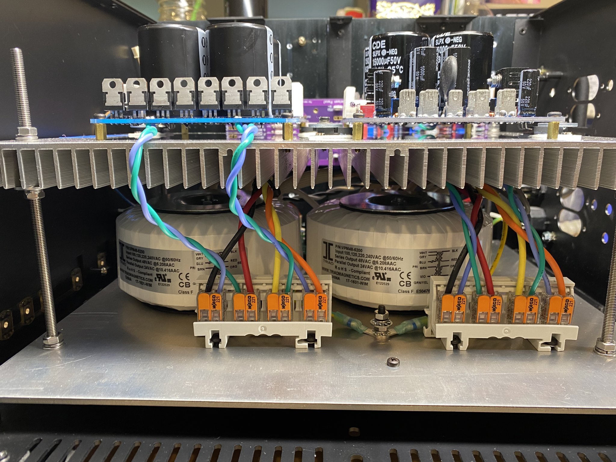

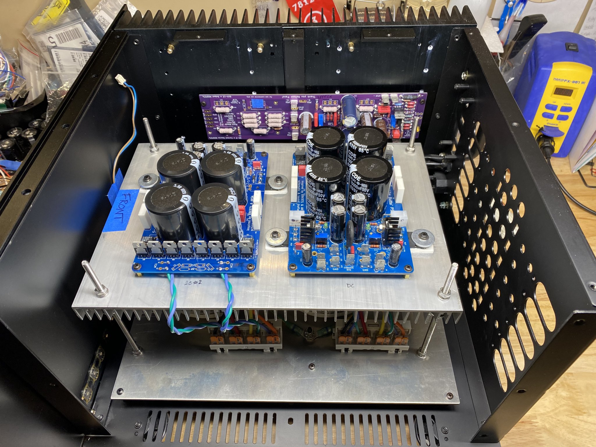

I finished my Aleph 60s mono amps today. I took these numbers after the amp was on for an hour, but haven't adjusted any pots yet, nor done anything with the AC gain. Do these numbers look ok?

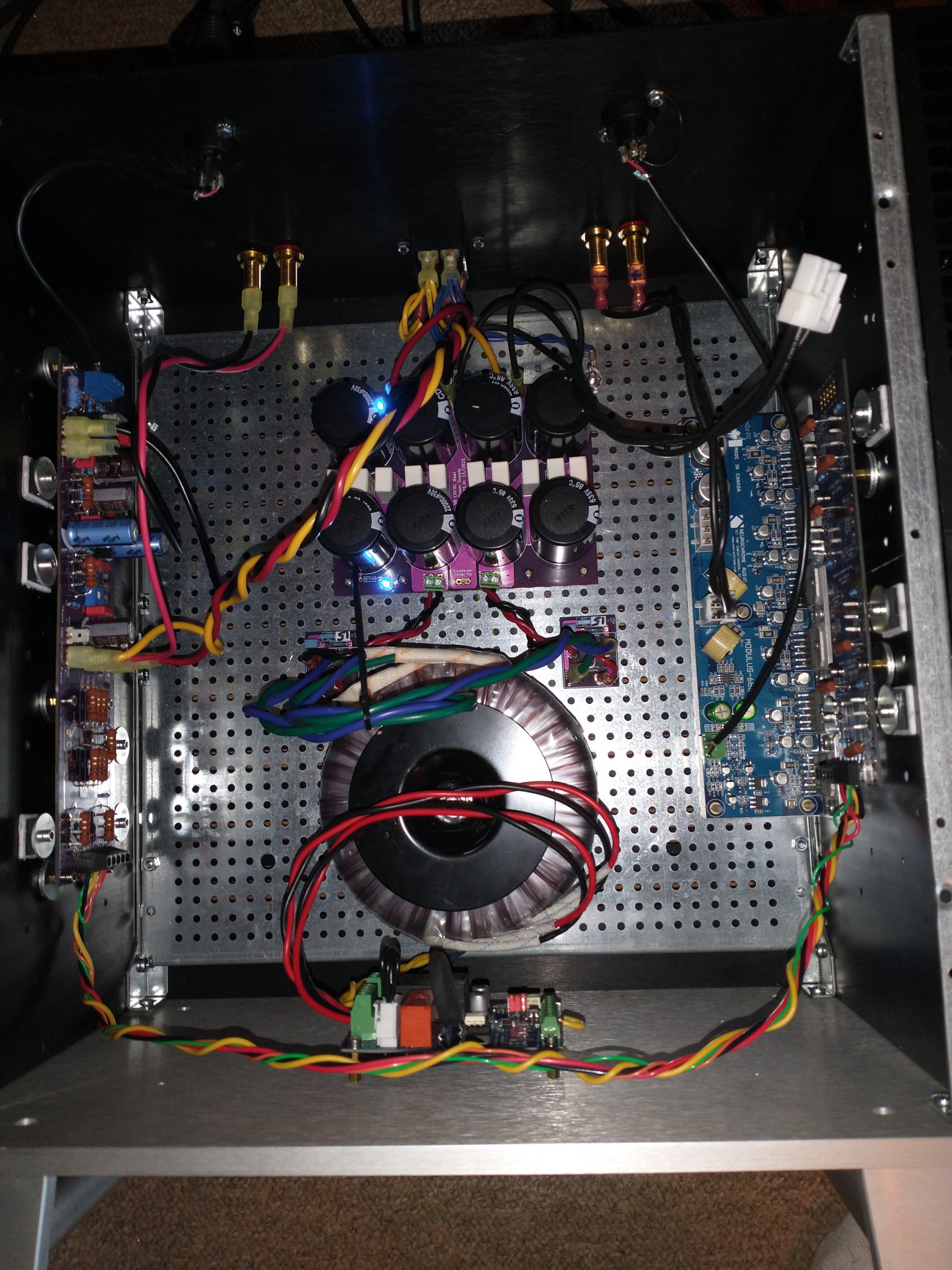

Each mono-block actually contains two different amps. On one heatsink is the main Aleph board, and on the other side is the expansion board and a Modulus 686 class AB amp. I used Deluxe 5U stereo chassis' and combined the boards because they both take the same PS rail voltage. Each amp board has its own line input and speaker output on the back, and for now I manually switch the power supply outputs from one board or another, until I get a beefy switch for the back that will do it instead. I used soft-start boards that I had for the class AB amp, so I didn't install the little CL60 AC cap boards. I am planning on using the Aleph 60s with Klipsch Forte II speakers, and the 686 with my Avalon speakers (I swap between the speakers every six months or so), but maybe the Aleph 60 will also drive the Avalon's.
I have been listening to the Aleph 60's while writing this post. They are sounding very, very good, even though they have only been powered up for a couple of hours total. I would like to express my appreciation to rhthatcher and others who contributed to the project, and of course to Nelson for all the great designs we've been able to build and listen to. The outstanding build guides and BOMs and other documentation for this project allowed me to keep my stupid questions to a minimum.
Now I have to clean up the mess before my spouse comes down to the basement.

Gulp, I'm not anal retentive, but that room would bring out the Monk on me.... MONK, MONK, MONK....
Aljordan,
Your numbers look good. Offset is spot on. MOSFETs share the load evenly. Bias is good.
Did you set AC gain to 50%?
How’s the heat after a few hours? I imagine it’s not too bad since you’re running in a 5U. You might be able to crank up current if you like. If you have clamp type meter you can measure current on the positive or negative rail PSU wire in seconds as you set it.
Your 2-in-1 build is very clever! Well done!
I have not yet set AC gain to 50%. I will try to do so today, but I am a little worried about it. Back when I made the BOM orders, there were no 50k multi-turn trim pots available from any of the usual places, so instead I used some extra 50k single turn trimpots I had left over from a biamp 6-24 crossover build. I was able to get the initial setting correct prior to soldering them in, but they are very touchy. I am worried that they may be too touchy to set accurately.
I felt the heatsinks after five hours of listing last night. They were hot compared to my other amps, but I could leave my hands on them indefinately without feeling discomfort. What current level would be a good target?
At some point (in the winter when the extra heat will be welcomed), I will probably remove the 686 boards and convert the amps to dedicated Aleph 2 monoblocks to see what the extra oomph gives me.
P.S. tonyEE, the room is much better looking today. A magical transformation.

Alan,
Aleph 2 runs higher rails at 3A. So you're in the 2.2 range now... Try 2.5, 2.75, 3.0. See what difference it makes to the sound. The 5U can take 3.0A at the higher rails in Aleph 2 mono configuration, so you're good to go for cranking it up a bit.
You can measure the AC Gain without touching that single turn pot. See what you have. I know those single turns take very delicate handling to do minor adjustments...
So it turns out that my single turn pot is the current adjustment pot, not the AC gain pot. I did the "set current gain" procedure, and both amps were quite bit off. The left amp was at 66 mV where it needed to be at 102. The right amp was at 84 mV where it needed to be at 105.5. I was able to set them at 102 and 105 respectively. My multimeter wasn't giving me mV decimals on the AC reading, so hopefully accuracy down to the mV is ok. I rechecked DC offset after and it was fine. Do I need to recheck the current at the source and output mosfets, or should they still be relatively proper?

Alan, you should be good to go. Do you notice a sonic difference with the AC gain pot adjusted?
Enjoy the music!!!
Thanks,
Yes I do notice a difference. It is firmer in the bass and more dynamic (snappy) sounding on some music, yet still retains good smoothness after it warms up. Very 3D. (Though I hadn't had the amp for a day yet, so I didn't have a great feel for how it sounded before.)
The Aleph 60 is a little sizzly sounding when I first turn it on, but sounds very good after it heats up a while. Out of the many amps I've built, my favorite into the Klipsch Forte has been the Aleph J. There is a subtle beauty to the combo which seems like the Aleph J's are gently asking the speakers to play beautiful music for them, and the speakers say, "but of course we will, we love you". The Aleph 60 seems like it is telling the drivers - in no uncertain terms - what they damn well better do. Lots of grip in the bass, and an exciting and lively 3D presentation. Spooky good at times.
One more question: if I start playing with the current setting, should I readjust the AC current gain after? What does increasing the current tend to do to the sound?

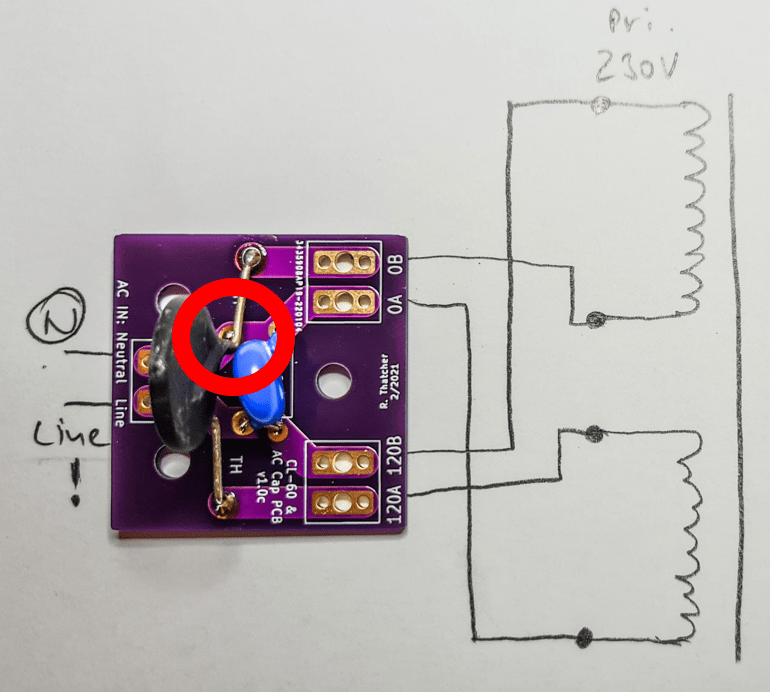

The use of the CL-60 board is different with 230v line (when using two 115v primaries), I made a sketch.
For this version only one CL-60 is needed per board, between 0B and 120A (in the original soldering points of the CLs, just bend the legs of the CL).
I think the value of the cap is unchanged.
Please correct me if I'm wrong 🤔 🙂

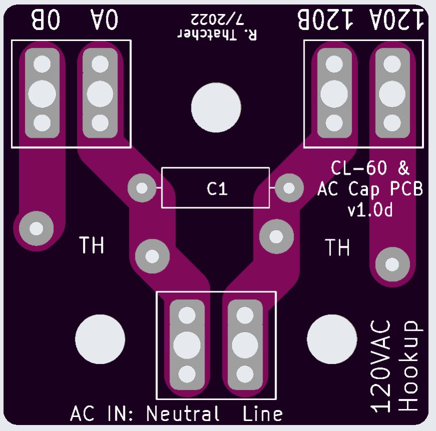

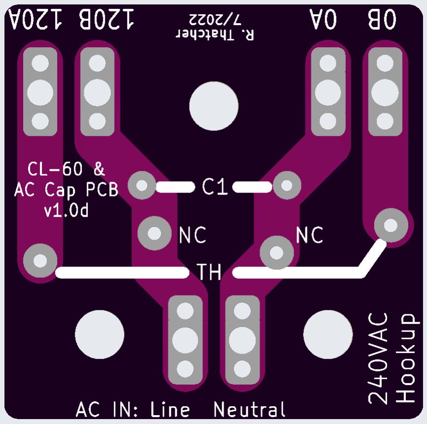

I am down to 1 of these boards in my box of boards, so it's time to order more. I have made a few changes and want to get input from @Plott and any others in 220/240VAC regions. See Post 273 and the following few posts for more detail.
Changes:
  • rounded corners
  • added "120VAC Hookup" label on one side
  • added silkscreens on other side to reflect 220/240VAC hookup with only 1 CL-60. Based on Plott's drawing above.
See Pix. Any feedback?
