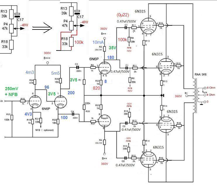

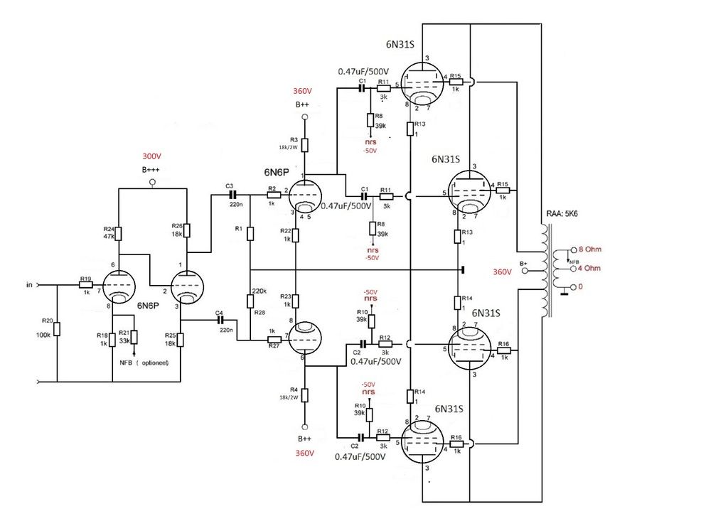

Ignoramus schematic
Ok .... here's my bastardization of the MonoBill . I haven't learnt to use spice , so I re-drew it using MS paint .
Please take a look and let me know what you think , and if it could work . I've halved G1 capacitor values , and doubled resistor values , have reduced B++ from 400V to 360V and reduced B++ resistors from 47k to 18k .
OPT is 5K , not 5k6 , can also be configured for 2k5 . Cathode bias to be adjusted to 50ma .

Sorry about late reply
Sorry for only posting now , for some reason I stopped getting notifications of replies and only noticed all the replies now . Gotta catch up !
I got some parts yesterday and have decided to build a voltage multiplier circuit with the 400VA toroidals I have , instead of using the transformer I posted earlier ( the 6P31S's can't handle the high voltage anyway ) .
The exercise of building this amp is more educational than anything else , thus my not wanting to mod any of the existing amps . I think it's a good challenge to try and design a valve amp that has the ability to drive different loads ( on a domestic level and within reason ) with relative ease .

Some points to consider:
- how much AC voltage needed to drive the output tubes to full power?
- what input sensitivity are you aiming for (separate preamp)?
- how much gain is the input/driver stage providing?
When you want application of gNFB to be optional the circuit is not so well designed IMO.

Like Pieter said, GNF is mandatory to prevent oscillation of the circuit with proper bandwidth limiters. Don't consider this design without GNF , remember you have a lot of gain in this amp and you want to use it to control a low impedance load by using a good amount of feedback, you will have to do this by ear tuning, unless your a mathematician and can calculate the gain and phase degrees of each stage.

maybe you already know this , but just a reminder for your parts to buy: the 39K grid bias will be 50K trim-pot of around 1 watt.
The 6n31s cathode resistors are 10R and have each a bias tap point to adjust the amp bias.
One very important thing: the Voltage to 6n6p is 350 V, 6n6p is different from a good quality 6sn7 or 6sl7,
My experience is that 120 to 240 V is the best voltage for that tube, over 260 V and you will get a surprise like noise or premature failure.
Perhaps the B+ is still a little high and In should bring it down to 300V or perhaps even 250V ?
I'm thinking of just using passive pre ATM .
I'm going to have to learn how to calculate that ! 😕
The reasoning here is to hear what difference it would make . I can also try the various types of feedback suggested in this thread at a later stage and also hear the difference . This circuit is for me to play with , and learn from .
I used to be pretty good at maths , but don't have sufficient electronics knowledge to even know what calculations to use .
In this case , I'll take the GNFB as a given , and tune by ear trying different value resistors .

Maybe you already know this , but just a reminder for your parts to buy: the 39K grid bias will be 50K trim-pot of around 1 watt.
Those are exactly what I bought , those little blue trimpots , thanks for the heads-up ! My knowledge is pretty lacking , to say the least .
So maybe increase the 18k to 33k ?
Also , do you think I should go for a lower B+ , and lower B++ ? All 300V ?

That's not correct: there are anode and cathode resistors with voltage drop because of DC current.
When supplying the driver stage with the same 300V as the input stage both 6N6 tubes will feel fine and work within their limits.
When supplying the driver stage with the same 300V as the input stage both 6N6 tubes will feel fine.

I would say it's best to design your circuit to be as linear as possible open loop and then add the negative feedback to make it more linear and lower the output impedance (increase damping factor to the speaker). It's not good practice to design an easily distorted audio circuit and then lean on the NFB crutch to make it perform acceptably.
Do you mean Ebb (B++) or Vp (voltage at the plate/anode)? Since 6N6P is often run at a plate voltage of about 160V with a plate load resistor of about 10k to 15k ohms, it will often see a B+ feed of >300V. I don't see what's wrong with that. I have a single-ended line preamp using 6N6P with B+ of over 400V and a 15k plate load resistor, running each 6N6P triode at nearly 20mA Ip. It just goes and goes, no issues for years.
The thing about 6N6P is that it's less similar to a 6SN7 type of tube (and nothing at all like a 6SL7), but very similar to a 5687. It likes high current/low voltage. It has much lower internal plate resistance than a 6SN7 (6N6P will be around 2.5k, while 6SN7 will be around 9k) and higher transconductance, for similar gain (mu or amplification factor).
From working with this tube long-term, a 350V supply is fine for 6N6P, but it will work best if the plate current through each of its triodes is in the vicinity of 15mA. The way the proposed design is set up, you're using the 6N6P tubes like 6SN7 tubes were used in the original Williamson amp -- that is, with high value plate load resistors and low plate currents. This maximizes gain, but is not so great for linearity.
What if you used your 6N6P tubes with more like 10mA plate current each? R24 would be 15k ohms, aiming for 150V on the first stage plate, and about 7V on its cathode ('center-biased'). The second stage cathodyne (concertina) phase splitter would need plate and cathode load resistors of about 7.5k. You would try to adjust the value of R18 to get equal plate current through both triodes of the first 6N6P (input stage and cathodyne phase splitter stage). My initial guess from looking at the plate curves is that R18 would be about 700 ohms (680 would be the closest standard value).
The differential (push pull) driver stage is already pretty close to where I'd put it. For Ebb (B++) of 360V, center-biasing the tube with Rp = 18k would give you Ip = 10mA, Vp = 180V, and Vg = 9V. R22 and R23 would be about 910 ohms each, which is pretty close to the 1k that's in there now. You could join the cathodes of the two 6N6P sections and run a single 470R to ground (shared cathode resistor), which would increase the gain of the driver stage (not needed, but it's there if you want it).
The gain of those first two stages would be around 10X or thereabouts. The gain of the differential driver stage would be only about 10X (the lowish gain is due to unbypassed cathode resistors). So to get your 50V peak input to the output 6P31S's, an input signal of about 500mV peak should get you to full power output. if you want to make it so that a 2V peak signal drives the amp to full power, you could apply 4X global negative feedback (12dB).
As you go to larger value plate resistors, you start to operate the 6N6P tubes in a more 'starved' condition, where they'll give you more gain (which you don't need in this circuit) and more harmonic distortion.
-50V bias does not seem to be correct for 6P31S; left from the other circuit?
Good catch!! Yes, from looking at its data sheet (http://tubedata.milbert.com/sheets/113/6/6P31S.pdf) 6P31S with 360V on its plate would normally have about -25V grid-cathode bias.
So, even less reason to design the phase splitter and driver stages for maximum gain. Design for best linearity/least distortion, and it looks like you'll have plenty of gain for NFB no matter what you do.
BTW, that's a Williamson-style phase splitter/driver circuit in this design. Because of the multiple gain stages, it will have quite a lot of gain. The original Williamson design was made that way so that 20dB NFB could be applied around the whole amp, from speaker terminal to input stage cathode. Because the NFB loop went around both the output transformer and four vacuum tube stages, it required a specially designed output transformer, yet was still prone to instability (oscillations, 'motorboating') when that much NFB was applied.
The proposed circuit should be fine if used with lesser output transformers and 10dB or less of NFB, in which case you need less gain than was used in the original circuit. Of course, if you use less NFB, you need to make sure the driver stages are more linear. Also, you'll wind up with a higher output impedance from your amplifier (lower damping factor) which will give you that 'tube-y' bass response (looser, less tight, possibly a slight bass boost).
Every part of a circuit you 'improve' exacts a penalty on another part of the circuit's performance. The challenge of designing a good circuit is to strike a pleasing balance between all the various compromises. That makes it all too easy to fall into 'analysis paralysis.' (Ask me how I know...)
Those 6P31 data are for Vg2=170V ! Here, with UL, it's much higher and -50V is possibly even to little.

Your state ment here seems to re-inforce my previous statement re 85-95V .
Again the lower B++ ( 300V instead of 360V driver tubes ) seems wise then .
I'm starting to think I should draw up another version of the circuit using your suggestions , alternatively I have some turret boards where I could drop in resistors without soldering them , to see what difference the changes would make . So build an experimental amp , and a type of bench PSU to easily change voltage .
Hmmm .... interesting option - and would automatically balance the cathodes .
Is that what it would be with the GNFB resistor as it is ? ( 33K )
Noted - perhaps then your advice re R24 and R26 should be heeded then . R24 = 15k ; R26 = 7k5 .

Don't be sorry , I appreciate the input . It's amazing to me that you know at a glance what the effects will be .
