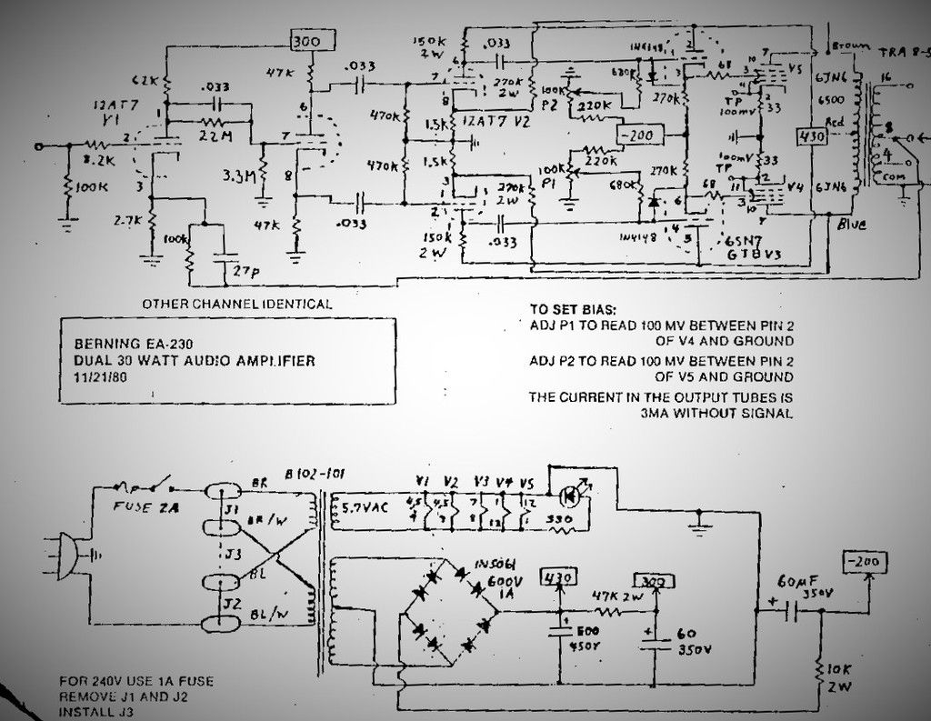

The Berning EA230 appears to make use of Schade feedback , not as extreme as the RCA example .

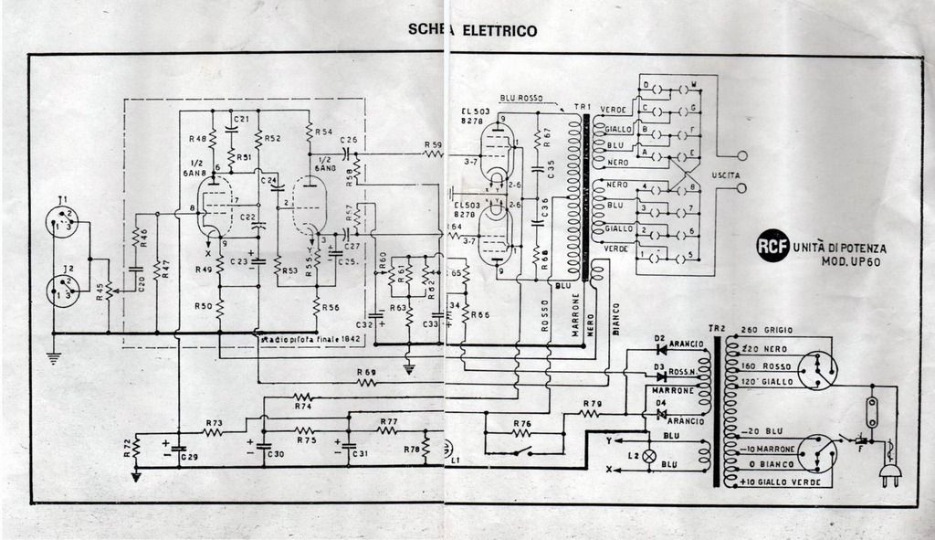

What do you think of the anode-anode de-coupling ( or is it coupling? ) in the RCF UP60 ? Also note the extra secondary winding on OPT for GNFB , quite interesting .

There's another wrinkle with that Berning design -- screen drive. The signal from the 6SN7 cathode follower goes to the 6JN6 screen grid, while the 6JN6 suppressor grid and control grid are tied to its cathode.
Another wrinkle is that the plates of both the 6SN7 cathode follower and the 12AT7 LTP (V2) are connected to the main B+, not to the plates of the 6JN6 output tubes. So does that mean there's no 'plate to grid' feedback going on, just the plate to cathode feedback in place from the 6JN6 plates to the 12AT7 (V2) cathodes?

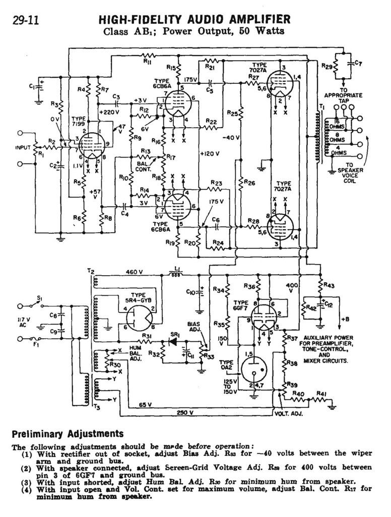

Looks like the Berning design is only using plate to driver cathode local Fdbks. (plus global Fdbk) That really is the most tube friendly approach. NO low Z summing point to drive, as occurs in resistive Fdbk to the driver plate (ie,"Schade") mode. Tubes will like the high Z load and voltage gain mode for linearity. [ the Berning design could be converted to a "Crazy Drive" scheme easily ]

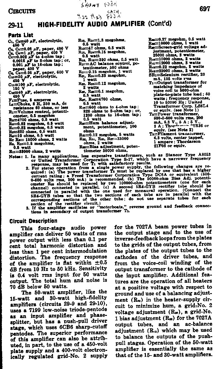

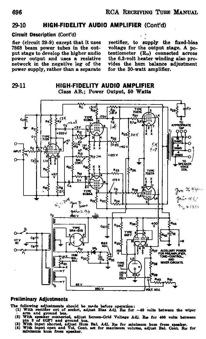

The RCA 50 Watter is really the odd-ball amp. Using BOTH type of local Fdbks to the driver cathodes and driver plates. (plus global) The Fdbk to the driver cathodes makes the driver cathode degeneration R look much higher in value, without disturbing DC conditions. That in turn makes the driver pentode look like a clean (linear) current source for the "Schade" Fdbk up top at the plates. It's a cleverly optimised Schade type Fdbk design, although there is real driver cathode Fdbk as well (greater grid drive to driver tube required, could call it a nested Fdbk design). It is a little mysterious however as to why they would not just use the driver cathode Fdbk paths alone, since the loop gain could be greatly increased without the low Z summing at the driver plates. Maybe someone has an opinion on this? Stability? HF response?
The RCF amp with output plate to plate RC networks uses them for snubber duty, to eliminate HF resonances in the OT. The separate OT Fdbk winding is typically used so that the Fdbk pickoff does not need changing with different output Z taps being used for various speakers (notice the movable global Fdbk required in the RCA without the extra winding), and may allow for paralleling amplifiers.

I mailed David Berning , and except for the obvious fumbling on G1/2/3 of OT's , the schematic is correct . This is quite a well regarded design , and can probably also be regarded as classic .
I found some more legible copies of the RCA 50 watter and description .

What is the extra bit of circuit coming from the shield of the OPT on the RCF amp ? First time I've seen that . I have a pair of these transformers too , maybe worth trying a little later on in my learning curve .

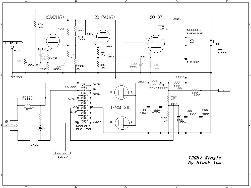

Here's my take on a local-feedback amp with a Hammond 1650R: http://www.diyaudio.com/forums/tubes-valves/248376-amp-kt88-push-pull-shunt-feedback-output-via-p-channel-fet.html
Wow ! Beautiful work . Lucky brother indeed - what a Xmas present .
"What is the extra bit of circuit coming from the shield of the OPT on the RCF amp ? "
Probably just showing that the magnetic core is grounded to the chassis (via mounting bolts typically).

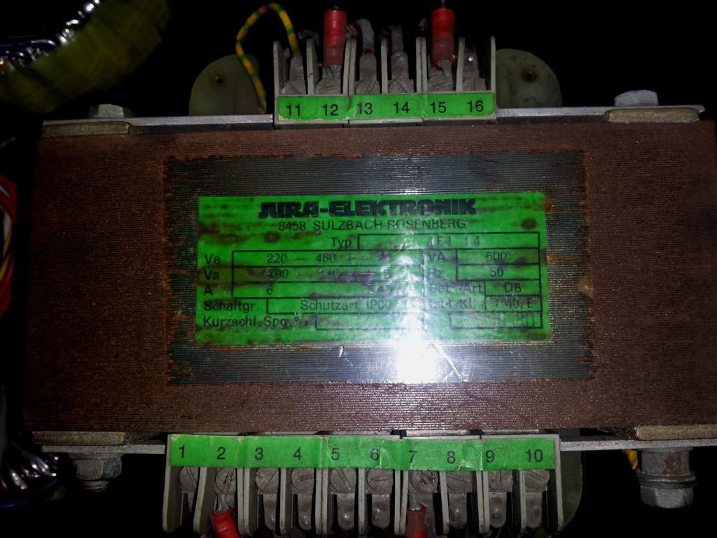

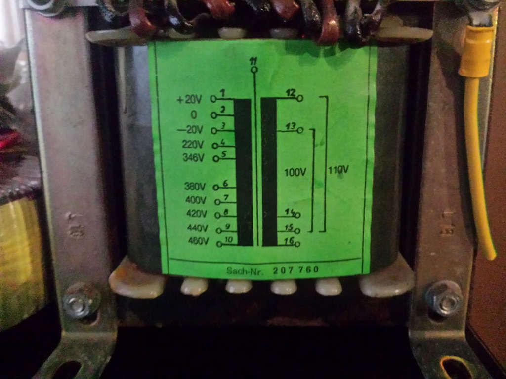

Hey smoking-amp
Do you think that 600VA power transformer will work with the 100W stepdown ? ( that I posted a few posts back )
