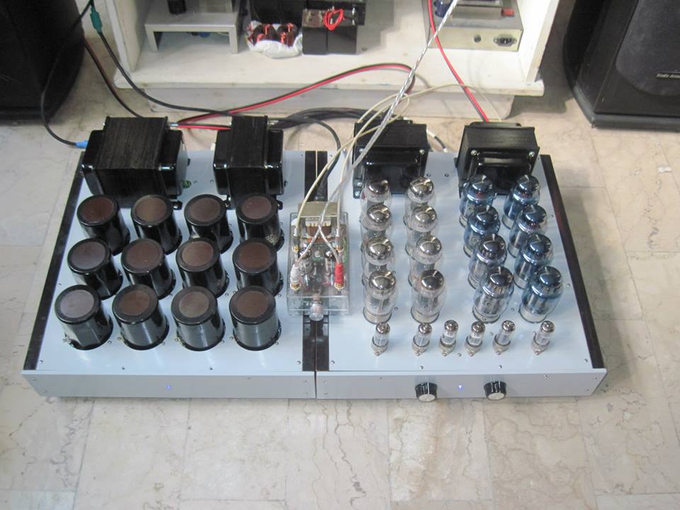

yes. i built a ppp amp using 16 KT88's wired in triode mode,
using topology by Bob Carver, although i made provisions for gnfb,
i found that i can do without it...
Impressive! But I wonder how you deal with the fact you already live in a hot climate.😀
oh, the amp was sent to the states, and i think is somewhere in california...😀
btw, i have a 300 watt tube power amp design using just a pair of output tubes, not very high B+, around 650 volts.....
