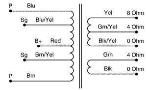

Hammond Output Transformer 1650R
Designed for push-pull tube output circuits. Enclosed (shielded), 4 slot, above chassis Type "X" mounting. Frequency response 30 Hz. to 30 Khz. at full rated power (+/- 1 db max. - ref. 1 Khz) minimum. Insulated flexible leads 8" min. Typical applications - Push-Pull: triode, Ultra-Linear pentode, pentode and tetrode connected audio output. Due to the unique interleaving of the windings both secondary windings must be engaged to meet specifications.
1650R Audio Watts RMS 100, Primary Impedance 5,000 ct, Max. DC Per Side 318 ma., Secondary Impedance 4-8-16
So - not the " easy to wire " 1650RA " new improved " version .
I guess it's a pity that bandwidth only starts at 30Hz , but this is what I have .
Question : Can I halve impedances and use 5K primary as 2.5k primary ; and 8 and 16 secondaries as 4 and 8 ?
And .... Any thoughts on above mentioned OPT's ?

Yes, you can halve impedances.
With parallel output tubes your OPT will have better LF bandwidth; don't bother with that 30 Hz, it will be lower.

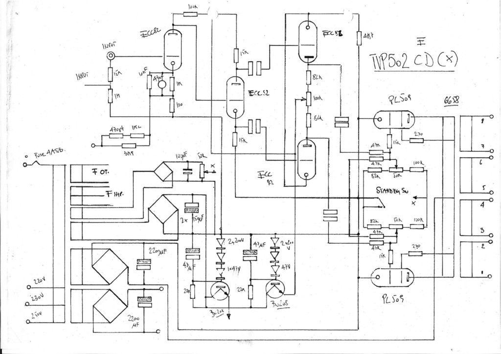

I see the Gunter Steinhart TVP502 E amp is running psuedo-triode outputs, which may be running in class A mode with only +200V B+. That would severely restrict the peak current available from the tubes. (idle current restricted, due to tube power diss. limits)
I think the PL519 ( 40KG6 ) was designed to work at high mains voltage ~230V . Steinhart did make a TVP502 A . This one is the TVP502 E , I think it may be Class AB , unless the E indicates use of some silicon used in the design for current regulation .
Here is the right schematic , I think .
Oh, I guess it is running in UL mode. The other schematic I saw looked like it had +200V B+ marked, that would make sense for keeping the screen voltage low enough for these low screen V tubes.
Any idea what OT primary Z it is using? At only 50 Watts out for such big tubes, it must be running with a higher Z primary than normal for such low B+. UL mode is known for losing its current drive capability too. (low screen V when the most current is needed, similar to triode)
You might want to experiment with some modifications to the amplifier. Change to pentode mode. Add some "local" N Fdbk around the output tubes in place of the UL Fdbk. (some resistors from PL519 plates back to driver tube plates, or to driver tube cathodes.) That would increase bass slam with increased current drive capability.

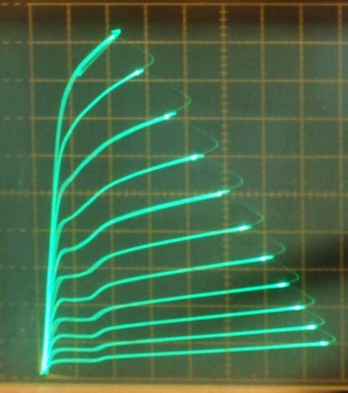

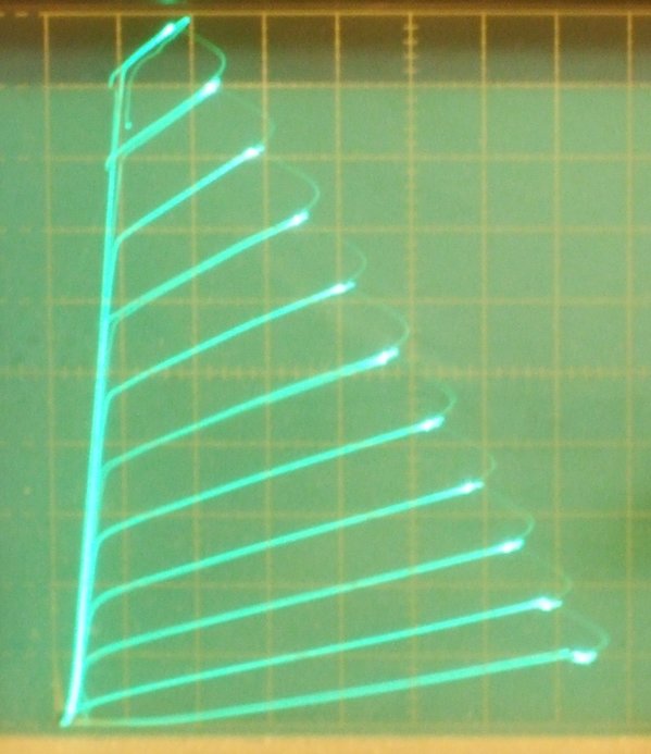

Going really wild, there is the new hybrid g2/g1 drive, or Crazy Drive, which linearizes the output tubes (in pentode mode) before any N Fdbk. You still want some local/global N Fdbk however to lower the output Z. Requires about 3X the drive voltage swing of normal grid 1 drive however (for the output tubes).
Pics:
1) 36LW6 in normal grid 1 drive
2) 36LW6 using new Crazy Drive
