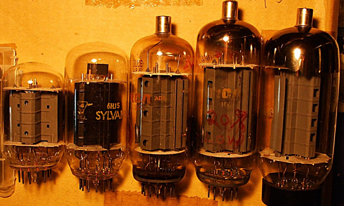

To drive a difficult load, why parallel a bunch of wimpy expensive tubes that will need matching? Just use a tube that can do the job:
26DQ5 $3
6HJ5 $4
21LG6 $4
6CB5A $5
36LW6 $11
26DQ5 $3
6HJ5 $4
21LG6 $4
6CB5A $5
36LW6 $11

You better use bigger bottles than let say 4 X el34.
You gain nothing in output impedance by parallel tubes, the only reason to parallel tubes is to boost the power of low impedance wimpy tubes.
If you need that much power use two x KT150, you will get better sound
26DQ5 $3
6HJ5 $4
21LG6 $4
6CB5A $5
36LW6 $11

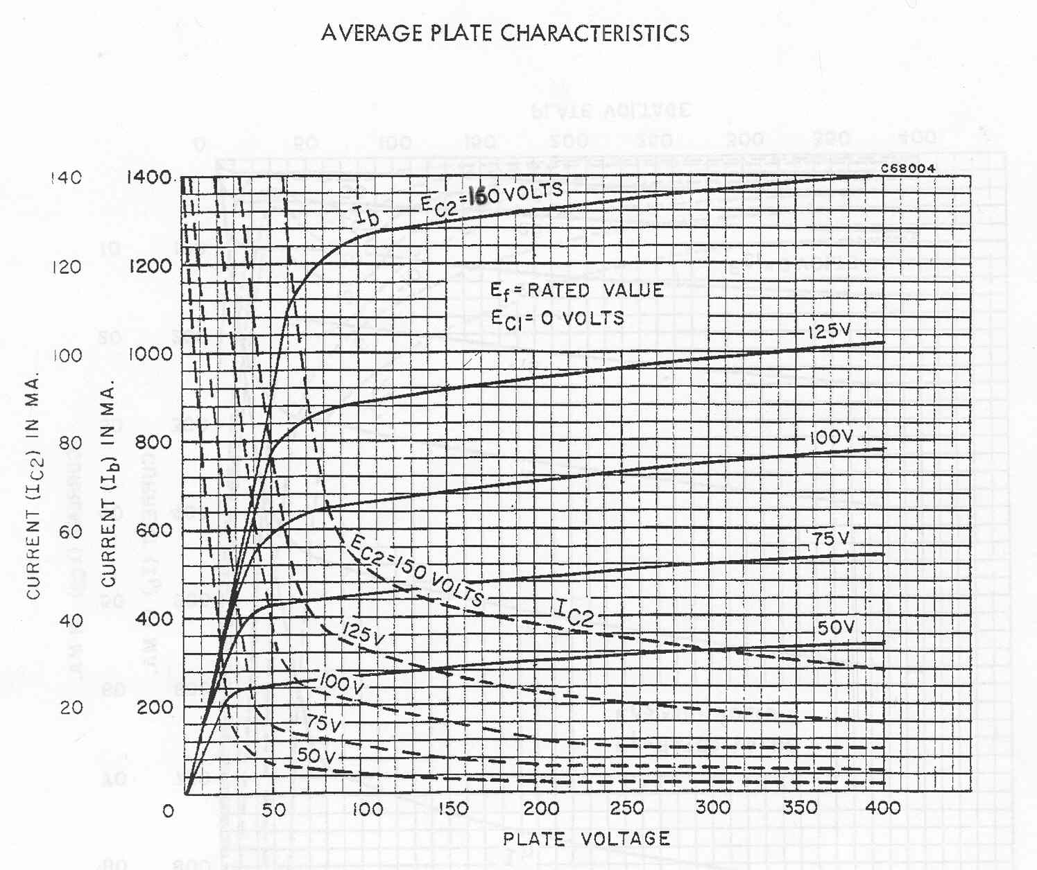

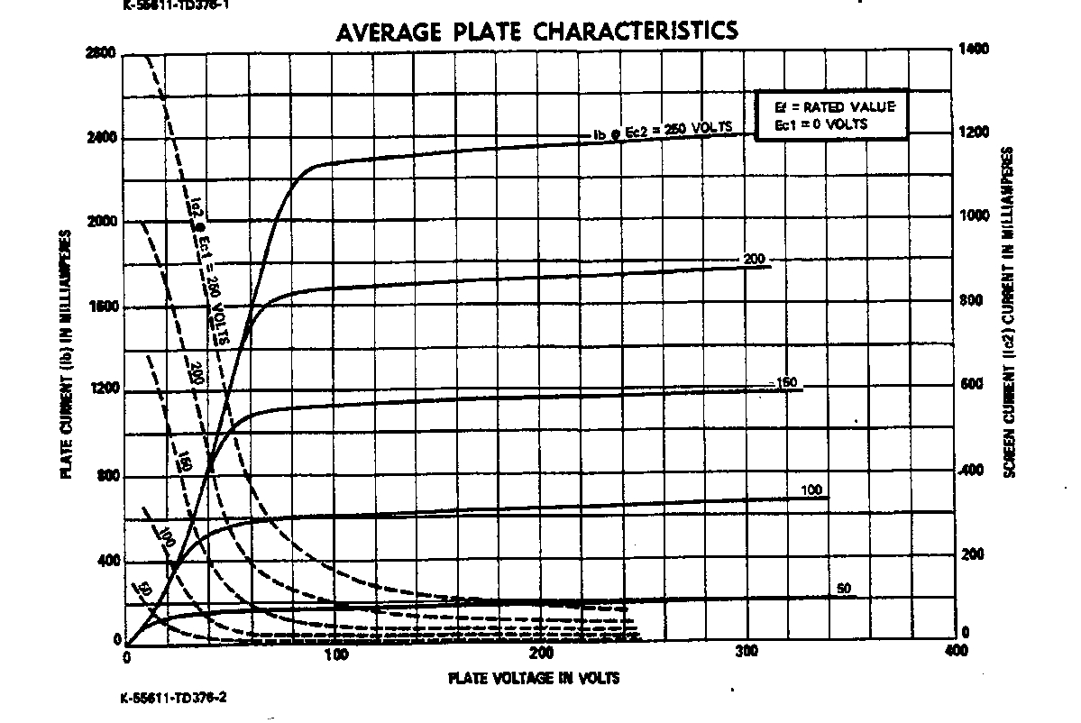

Some clarification maybe needed.
Pentode outputs (without N Fdbk) are high output impedance, so paralleling more will not help with final Rp alone. Adding a N Fdbk loop will lower the output impedance. However, the tubes/OT combo must be able to deliver the current commanded by the N Fdbk. So more tubes, or a bigger tube, CAN help meet the requirements.
I would take the lowest speaker impedance expected, at the highest power required (for bass boom say), and figure the peak speaker current required. Then work that backwards through the OT 1/turns ratio to get the peak current required from the tube(s). A higher primary Z OT will require less peak current from the tube(s), but may push you to a higher B+ voltage than desired, to meet the maximum (peak) power spec. (max. avg. power will be 1/2 that) I would stay below +450V B+ for reasonable economy of the power supply. (and also stay within the spec for the tube screen grid voltage for max knee current) A bigger tube or parallel tubes may solve any shortcoming on current. You have to play with the numbers for various tube and OT scenarios until a happy combo develops that meets the peak current requirement and the Watts output target.
Then you need to figure how much the native Rp of the tube(s) needs to be lowered to be less than the reflected Z of the speaker through the OT (determining speaker damping factor). That ratio will tell you how much N Fdbk loop gain is needed in the front end (the minimum). Could be global N Fdbk, or some form of "local" (non OT inclusive) N Fdbk.
6P36C looks to be rated 550 mA max peak for +170V on the screen grid.
6P45S/6KG6/EL509 1250 mA peak for +160V Vg2
36LW6 1400 mA peak for +180 Vg2
35LR6 1300 mA peak for +160 Vg2
21LG6 900 mA for +175 Vg2
26DQ5 870 mA peak for +175 Vg2
6HJ5 750 mA peak for +175 VG2
21HB5A 700 mA peak for +175 Vg2
6CB5A 540 mA peak for +175 Vg2
EL84 160 mA peak for +300 Vg2
EL34 350 mA peak for +350 Vg2
George (Tubelab) has found that around +150 Vg2 works well for low distortion with the TV sweep tubes (ie, for all of the above list, except EL84 and EL34). That would lower the peak current ratings above by Vg2'/Vg2 to the 1.5 power. (for example: 6P36C: 550mA x (150/170)^1.5 = 456 mA peak at +150 Vg2)
Have fun playing with the numbers! Something will work.

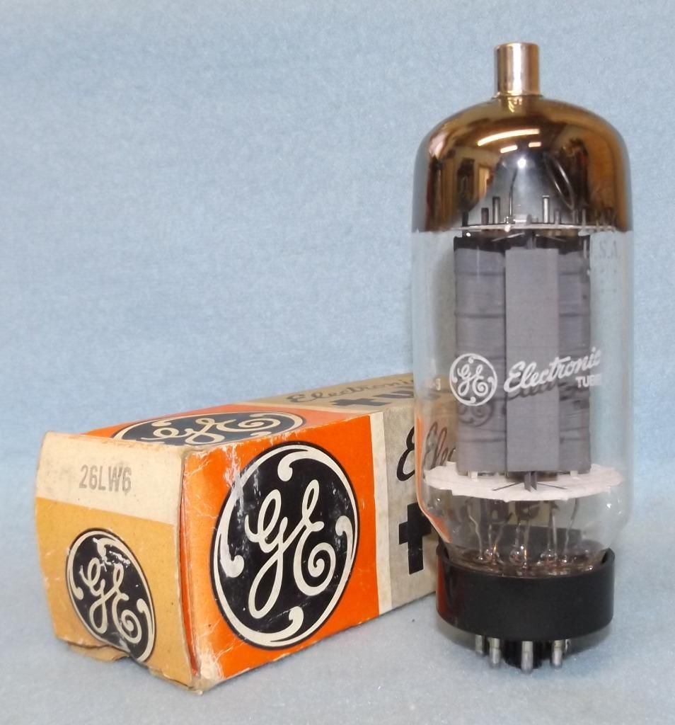

There is an article in Glass Audio 3/99 "The LW6-180 Amplifier"
The price of using such tube is that you'll need lower than plate-screen-voltage rating about 250V usually regulated source, but you can easy use solid state regulator (I have this schematic) to reduce the tube count. 6LW6, Class AB2, 2x90W, not sure about 8TU output transformer mentioned.
