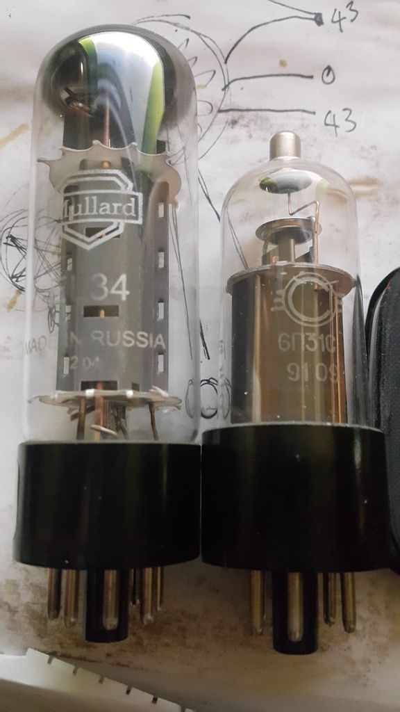

I'm not familiar with 6N31S. How similar is that to EL37?
http://tubedata.milbert.com/sheets/154/e/EL37.pdf
If similar, then it shows a push-pull arrangement for 350V plate-cathode and screen-cathode, with Vg at -31V.
6P31S ( or 6P31C ) is analogous to EL36 , not EL37 .
EL36 @ The Valve Museum
http://www.r-type.org/pdfs/el36.pdf

Is 6P31S more like an PL504 or more like an EL37? They look different enough that it will matter.

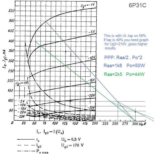

Yes , earlier I was saying that I would want to go over 300V on the plate - this does seem " saner " . Perhaps even 250V .
EL36 operating in Class B PP
Va =300V
Vg2 = 150V
Vg1 = -29V
Raa = ~3,5k
Wo = 44,5W
Dist. = 7%

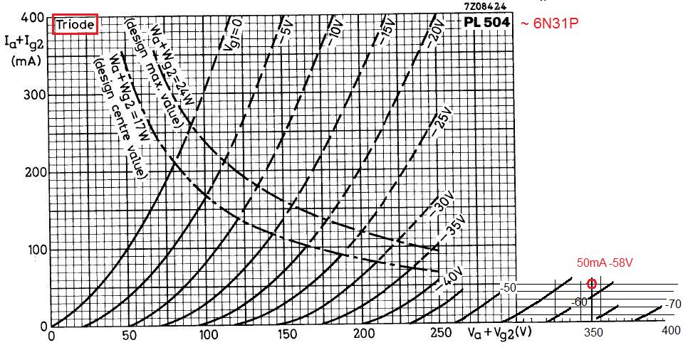

To start with, best use the first schematic values.R22, R25 can stay 1k but I prefer 820 ohm, more linear.
The 6N31 is allmost an EL504 (PL504).If you see the bias voltage needed you understand why I proposed to modify the circuit from T-Dick.

And accordingly make :
Va = 300V
Vg2 = 300V
-50V G1 bias for 55ma

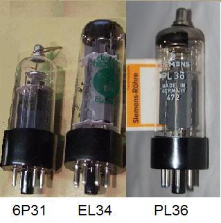

Aha, the Russian put the tube in a smaller bottle, I didn't now that.
The data, with exeption of the dissipation, are allmost the same with EL36/EL500/EL504.
Probably the anode extend down in the base and is bigger than it appears.
Look the PL36 is as big as the EL34.

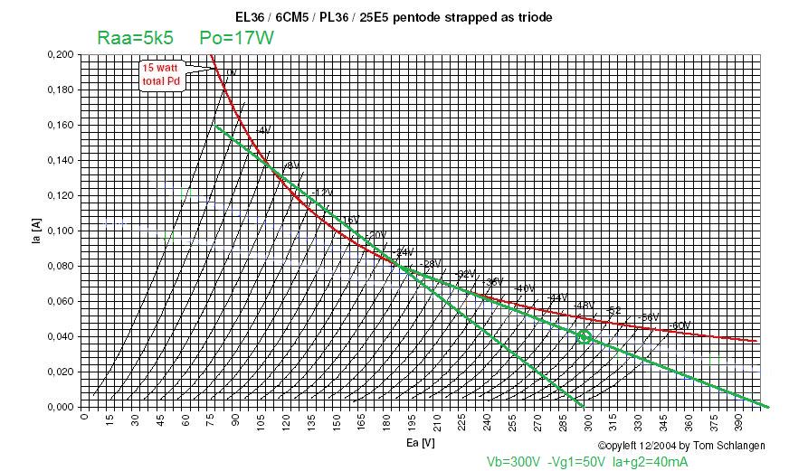

Good link ! Makes EL36 look rather promising ! I'll definitely also go UL . I'm posting Grant Wills's schematic here for interests sake .
Source : Grant Wills
Grant Wills -" I wanted to use them in ultralinear configuration and tying the screens at 1/2 supply did not permit this. The ratings indicate a maximum screen supply of +200V and so I hesitated to use the ultralinear mode. However, after trying several configurations which either oscillated, distorted or otherwise misbehaved, I tried them in ultralinear mode with a fairly high amount of bias (-50V), and they worked really well! They were by far the most linear of any valve I tried and worked well with a fairly low standing current (approx 25mA each) and put out the maximum power (17W)! This seemed to justify their rather high heater power requirement. So I don't know if it is okay to run these valves with such high screen voltages, but mine works really well.
(Max power of 17W was measured by applying a 1kHz sinewave to the amp and measuring the peak to peak voltage across an 8 Ohm dummy load at the point of clipping. The RMS volts = pp volts divided by 2.88 (twice the square root of 2). Power then = Vrms2/8 Ohm. Note that the max power will not be sustained at very low (30Hz) frequencies).
The power supply used an old Philips valve power transformer, which was up to the fairly high heater current load of (4 x 1.25A) + (3 x 0.3A) = 5.9A, and had a B+ winding of 110Vac which, when applied to a voltage doubler provided 300V B+. (The doubler generates twice 110 = 220Vac, which after full-wave rectification comes to roughly 220 x 1.414 which is a tad over 300Vdc).
I decided to use fixed-bias as it allows slightly higher anode-to-cathode voltage for the output valves than cathode bias. This requires a bias network with a negative voltage DC supply. But the technique you can see in the power supply section of the circuit, for also getting a negative voltage supply from a voltage doubler, is an old trick from guitar amplifier designs.
I added a 10 Ohm resistor in each 6CM5 cathode earth return to monitor cathode current (by Ohms Law the easily measured voltage across this resistor, divided by 10, yields the value of standing cathode current through the valve, this in turn being the sum of principally the anode current plus a lesser amount of screen current) and act as a fuse under overload conditions.
Note that the circuit doesn't have any provision for individual adjustment of output valve standing currents. This was because I used 4 Radiotron 6CM5's from the same batch with very similar characteristics. A couple of other 6CM5's that I tried varied a bit in standing current. It may be helpful to modify the bias supply with 4 x 50kOhm trimpots in parallel and then in series with an 82kOhm resistor to ground across the bias supply in place of the one 100kOhm trimpot. With each trimpot wiper independently feeding each output valve this arrangement could then provide individual bias control over each valve. If the bias voltage needs to be increased, the value of the 0.1µF capacitor feeding the bias rectifier can be increased.
The front end of the circuit is conventional. The Mullard 5-10 amplifier uses the same phase splitter as I have, and the text refers to it as "a cathode-coupled phase splitter". A footnote refers to an article in Wireless World May 1948 by W T Cocking entitled "Push Pull Input Circuits." It's a tried-and-true topology, recognised even in solid-state circuits as the "long-tailed-pair", and works well.

According to that I may go for : B+ 300V ; G1 -50V biased to 60mv
That is 18W for triode connected EL36 PP , so surely UL will provide more perhaps 40W with a little GNFB for 2 valves .

That Wills thing is no good.You never get the 50Vtop to drive the finals from that phase splitter.And one bias for both tubes, bad idea.
Oh, I forgot to say it, the loadline for Raa=5k5 is with one pair of tubes as triodes. PPP makes that 2k75 and dubble output power (~ 34W)
For UL on 300V , looks possible. The screen drops to around 170V at full power so we can use the 170V graphs.

Well the screen voltage doesn't drop to 170V with 300V powersup.For that the tap has to be at 58% and a normal traffo does about 40% tap giving 210V lowest Vg2.
Never the less the graph for 170V gives a good idea, only a little to low.
Next problem is, you have no longer 360V for the driver.Has to be adapted to get 50Vtop out (in two directions)with a supply of say 280V (300 minus an R-C ripple att.)
