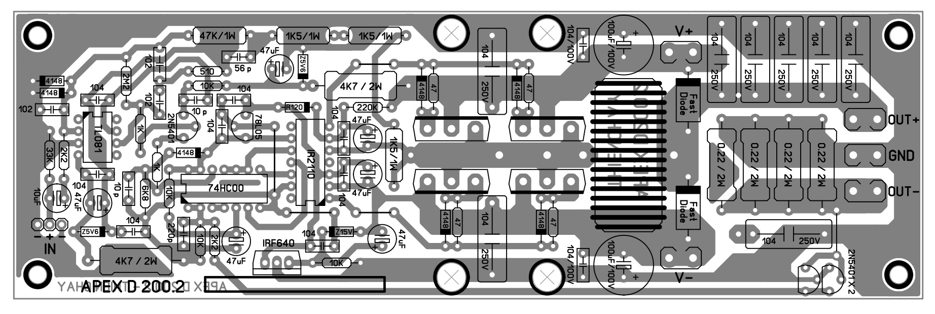

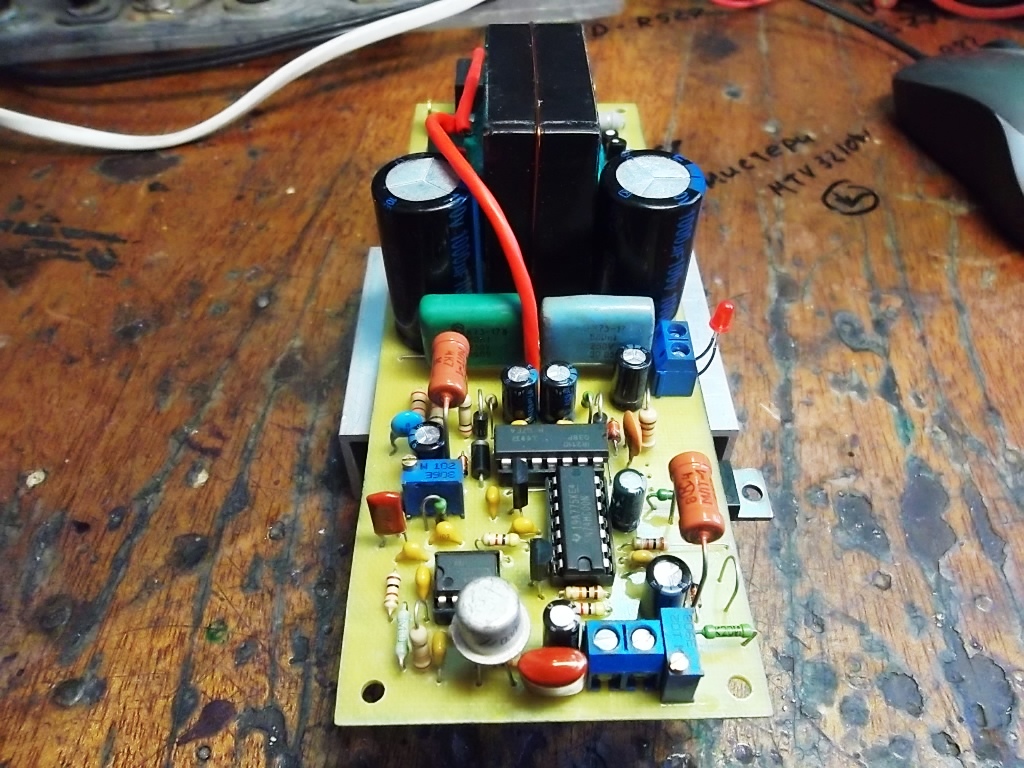

hello thienchay..
great job!! I would like to ask..
what the rail voltage for 2 Ohms, 4 Ohms & 8 ohms?
what mosfet use?
what value of filter inductors?
how many watt in 2ohms, 4ohms & 8ohms?
hope to hear you soon... thanks for the lay-out..
hihi , i'm not yet try it 🙂 the value of filter inductors is around 22uH -> 47uH for 2 ohm -> 8 ohm load .
you can rail around +/-55V -> 65V for 2 ohm load (i think it can work with +/-75V) , i have IRFP450, IRFP460 so i'll use it . You can use another MOSFET with the same datasheet .
Regards
Regards
thanks thienchay!!
nice to hear you.. I have IRFP460 on hands.. so then I will use those mosfet..

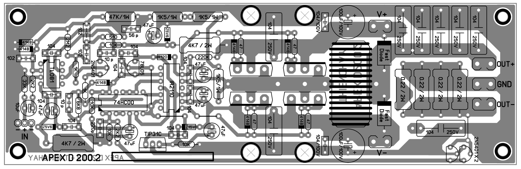

Hi thienchay,
Nice PCB, Thanks 😀😀
Is't IRFp460 Qg (210Nc) quite high for 2 pairs O/P, even for 200 - 250Khz.
Mr.Mile I still have the same problem, now I have 17.5v Dc on the O/P 😕,, will look at any other fault in the PCB.
I will make thienchay PCB and Build the amp.
regards
