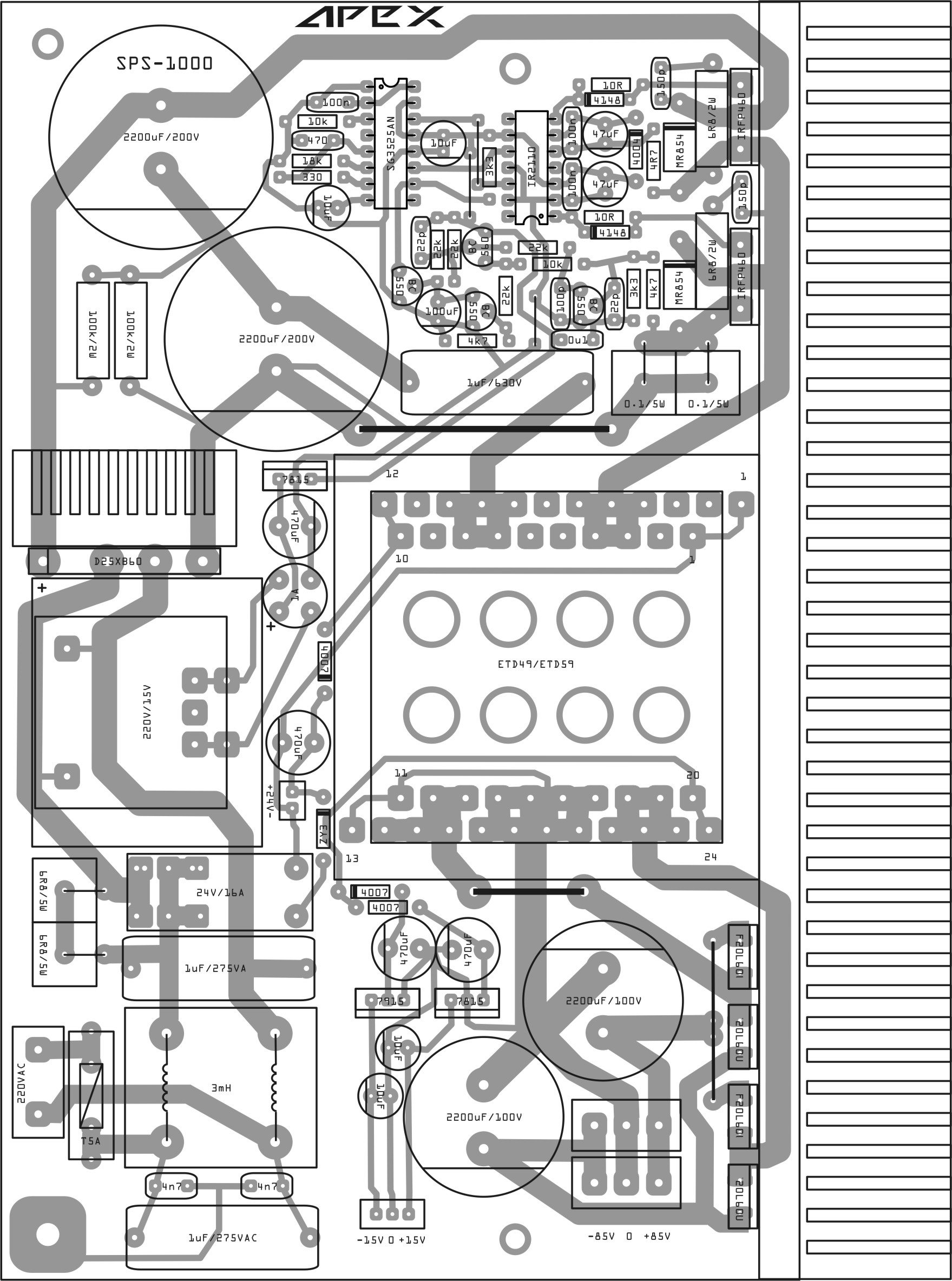

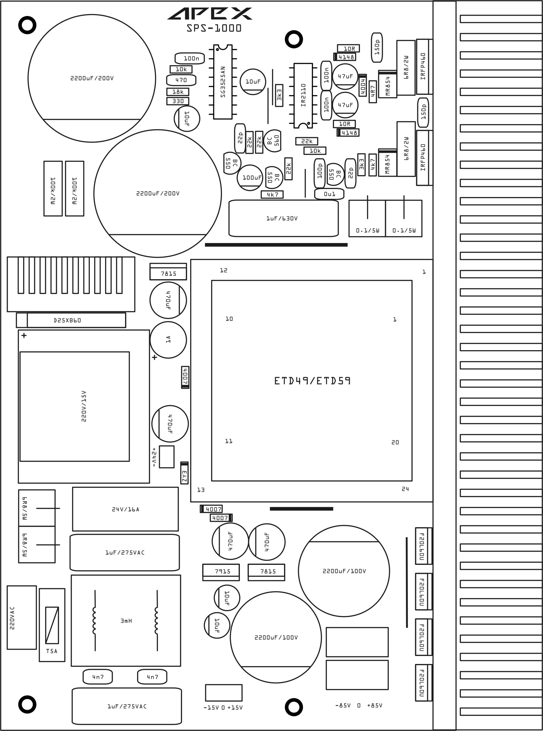

SMPS PSU for D200 stereo.
Will You provide in pdf?

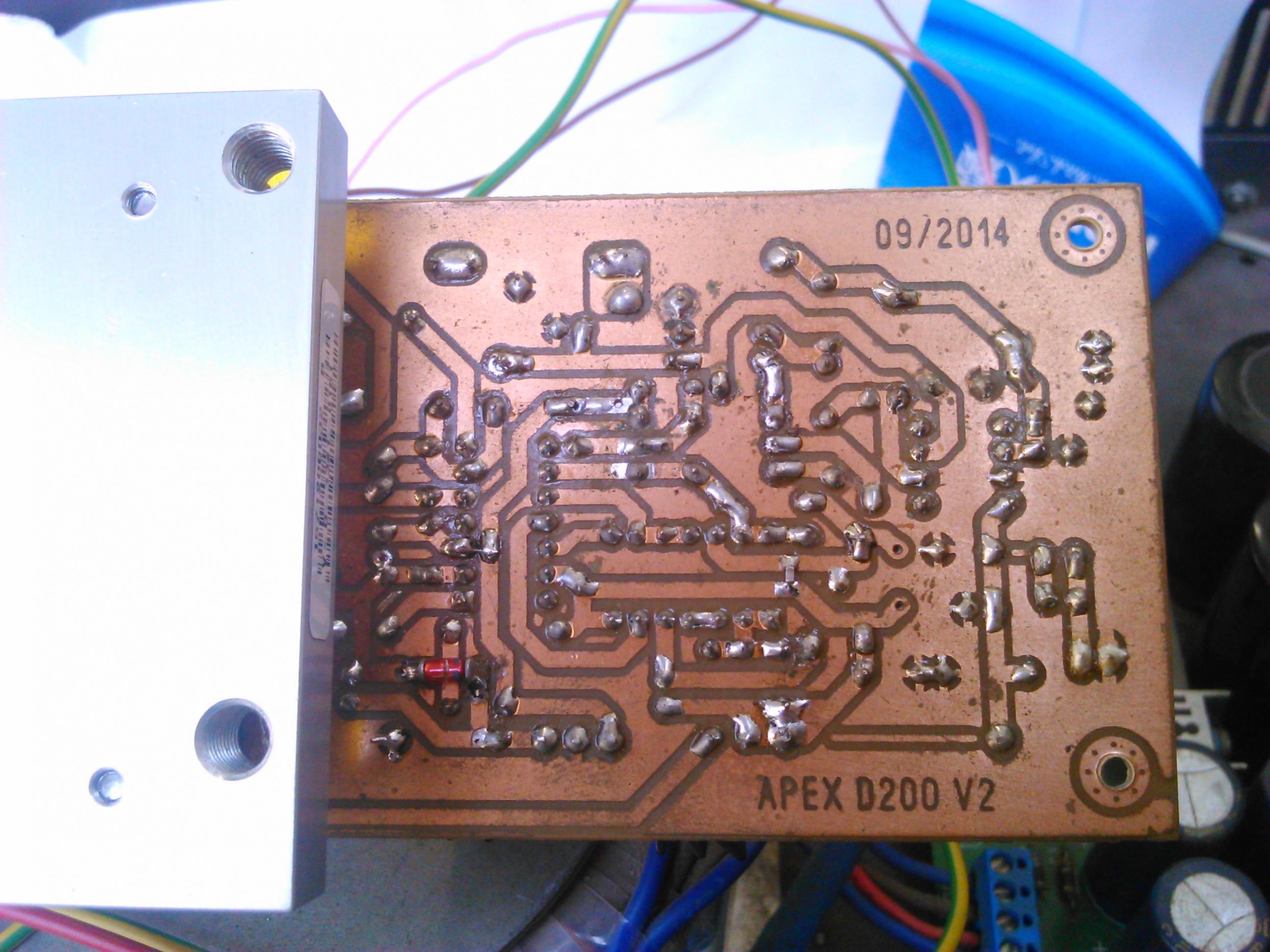

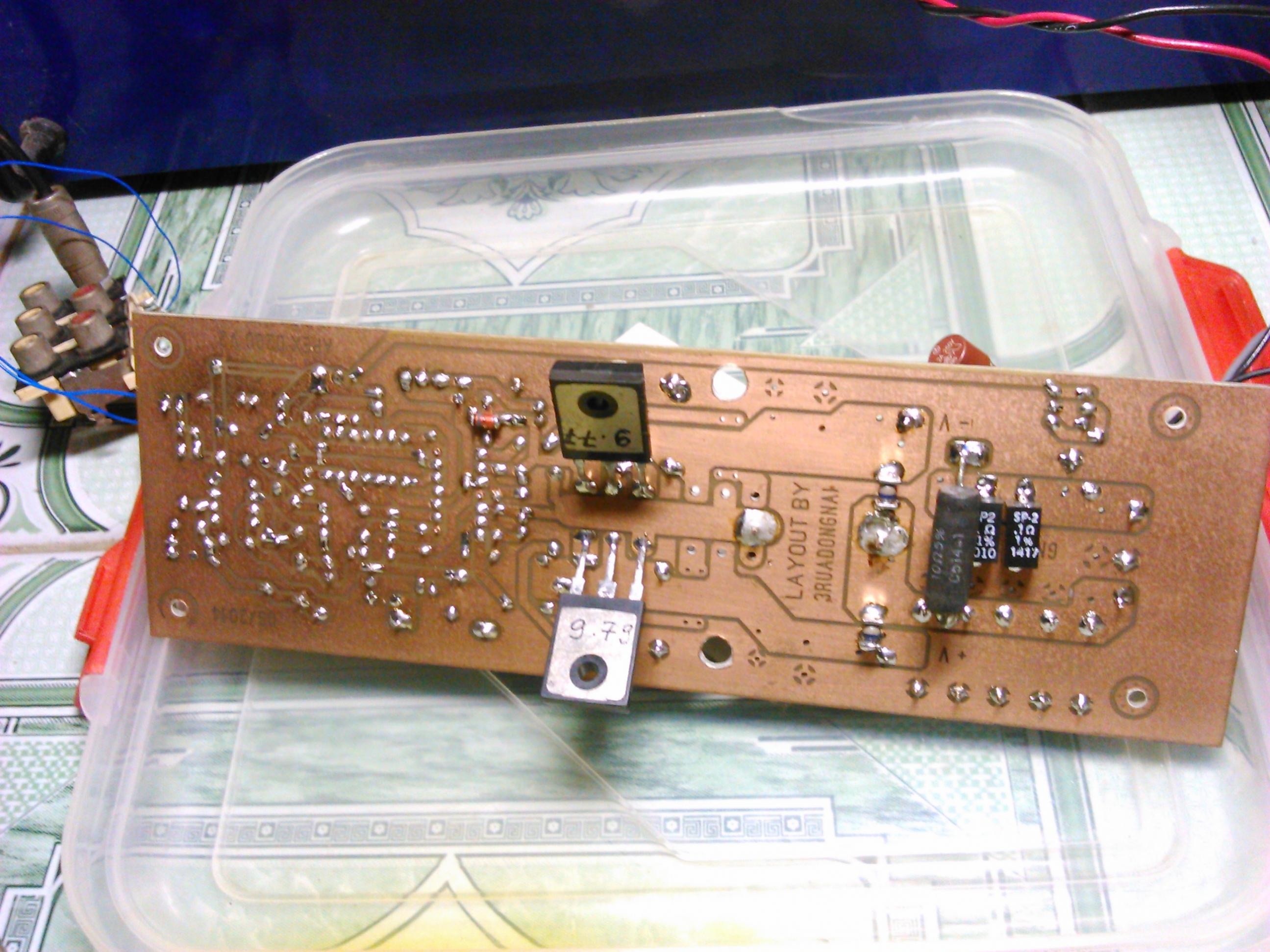

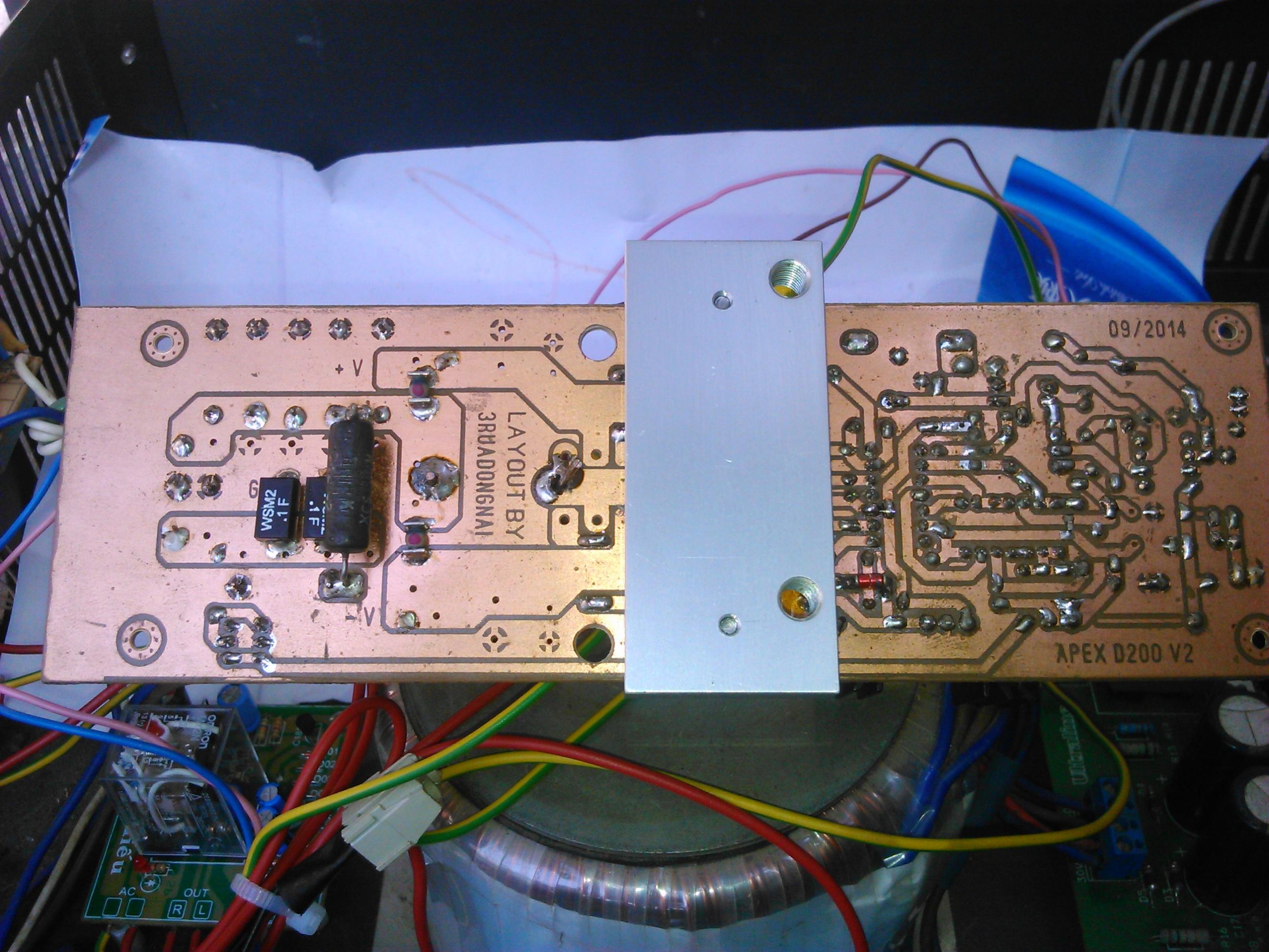

Apex D200 Sound very good but Zobel resistor 10 ohm 3W very hot. how to fix it ?
Thanks.
Post pictures,
Regards

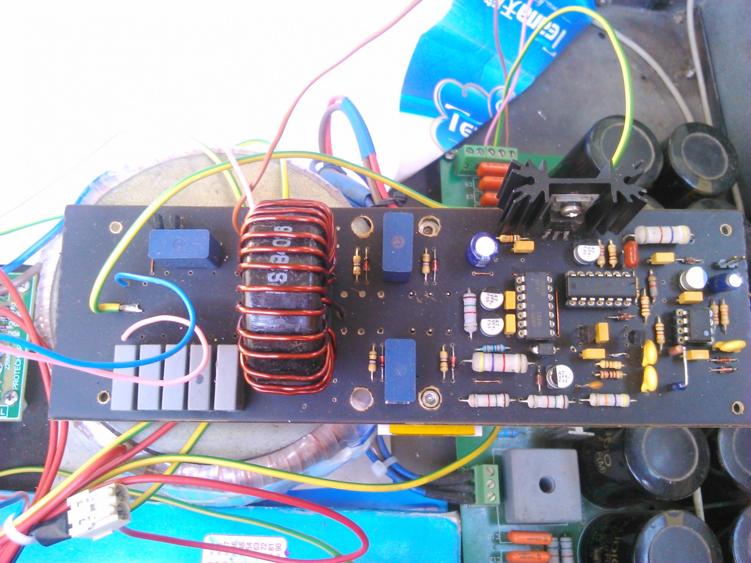

Hi Apex
Power suply +56,-56,0 V, Bias IR2110 11.4 V. Use FET IRFP260N. Coil is warm not hot.
Can you help me......
Many thanks.
Many thanks.

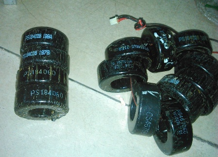

Hi Apex .
I use Sendust core PS184026 , AL = 26, Values we need is = 33uH.The formula for calculating it
n =SQRT(nH/Al) = =SQRT(33000/26) = 36 turn. Check again by Multi Meter OK. Can you recommend me a good MostFet ?

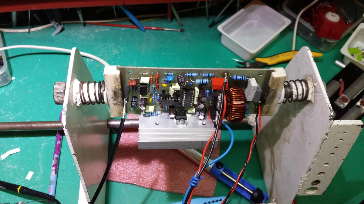

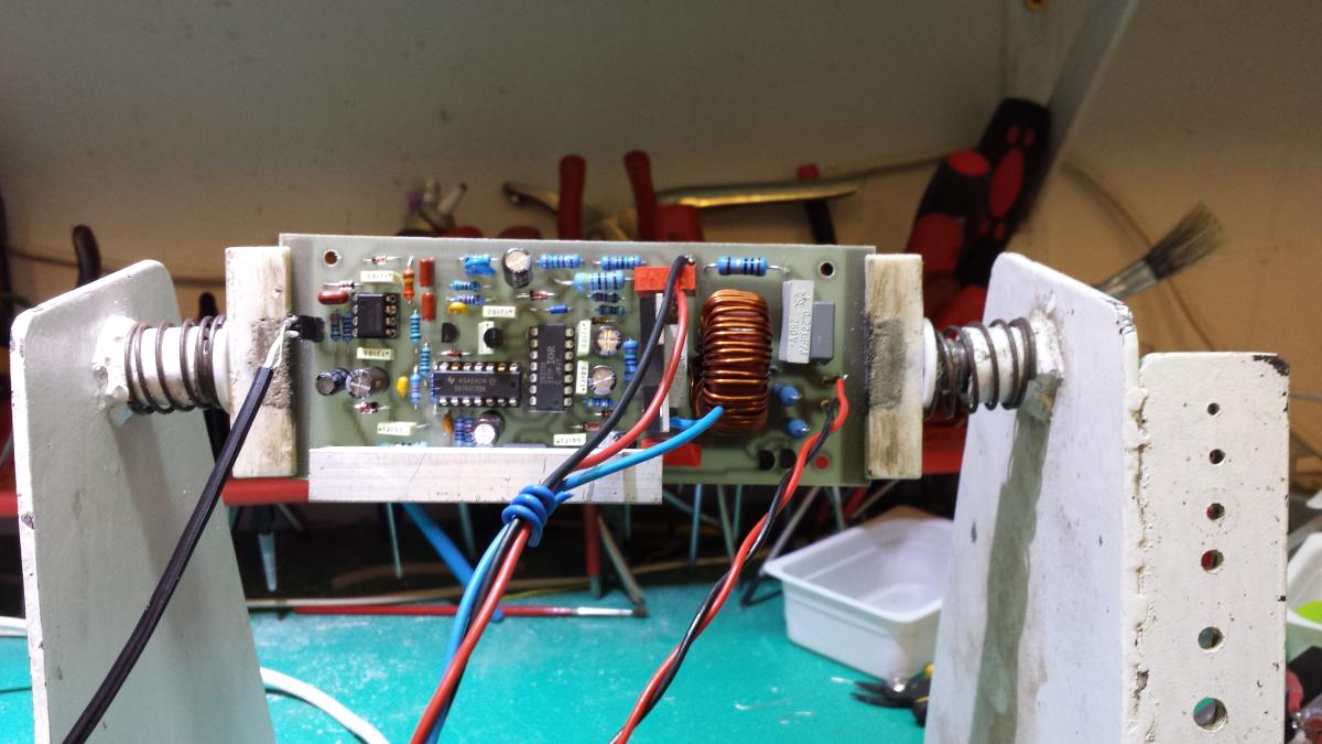

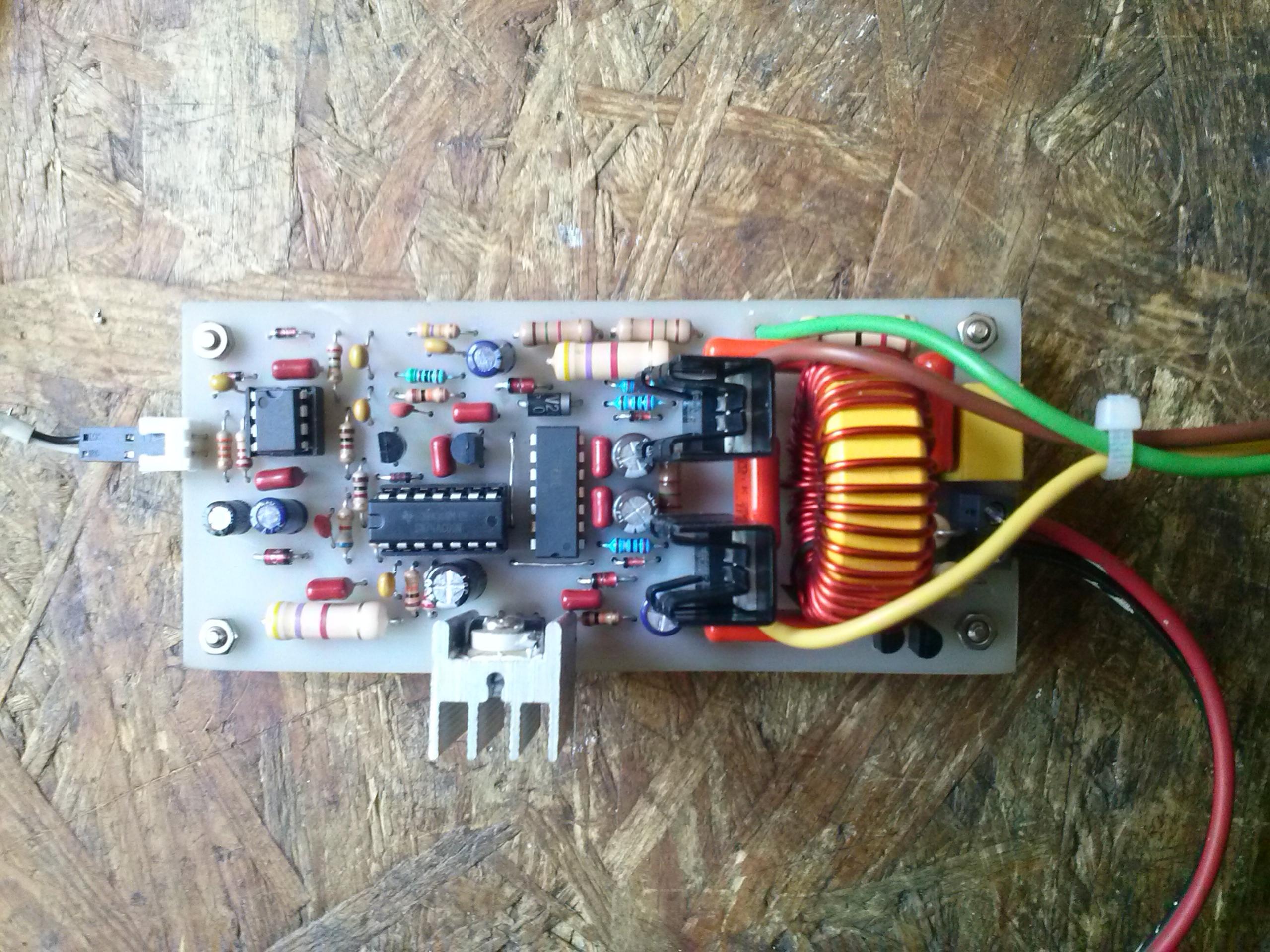

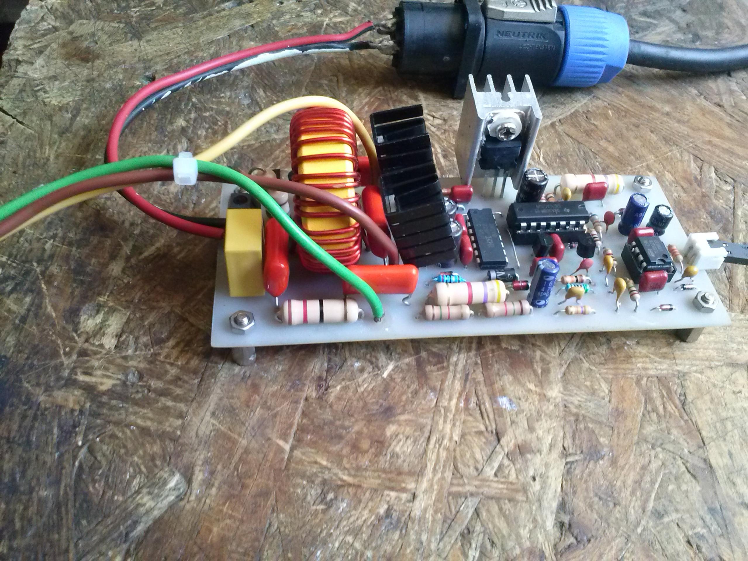

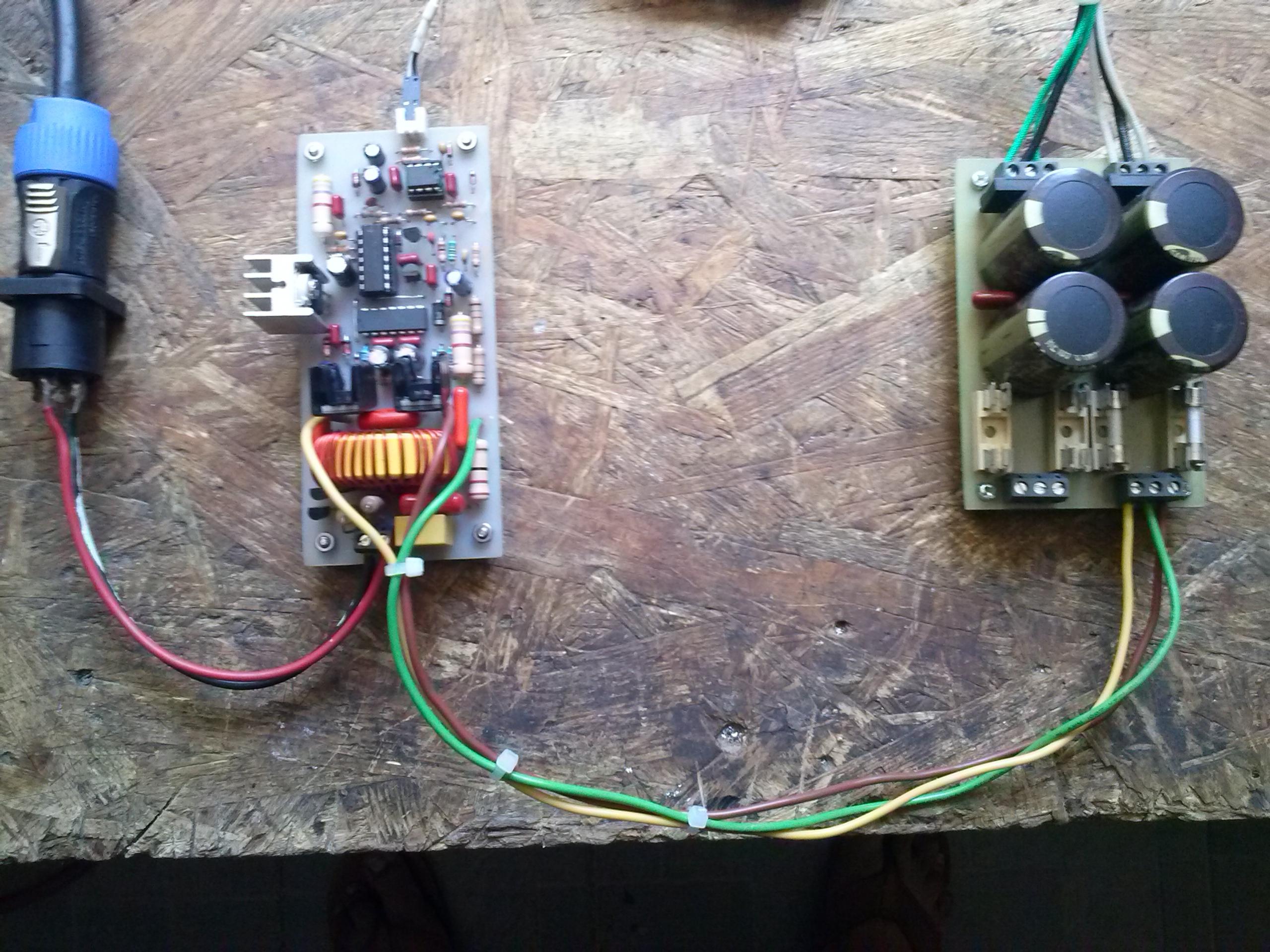

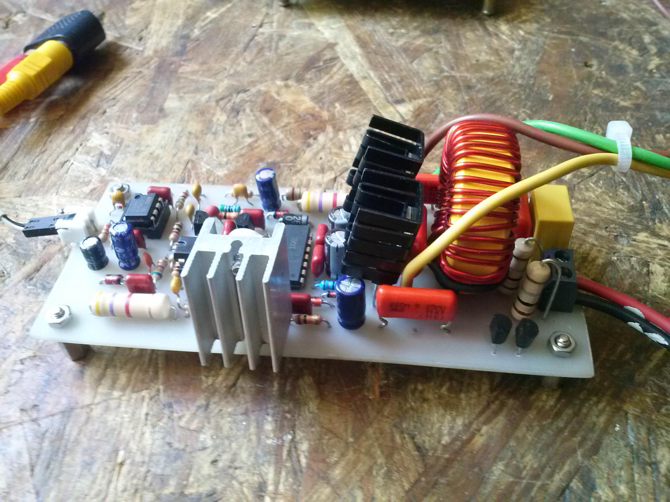

Some pictures of Apex D200. I am testing it with +- 35VDC an its play loud with stong bass. The high are a little too agresive for my taste ,but for the my first D class amp its OK.Fets are just a little warm the coil is at room temperature, all in all very good.
Regard
zoky2
Regard
zoky2
Regard
zoky2

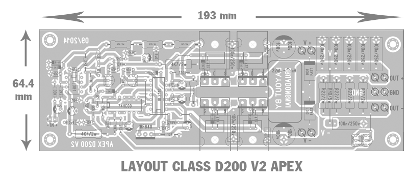

Hello Apex,
D200 rev. lay-out don't have 100nf/100v near the resistor 4.7k/5watt, while the lay-out of D200.2rev has and what the different in adding 100nf in D200.2?
