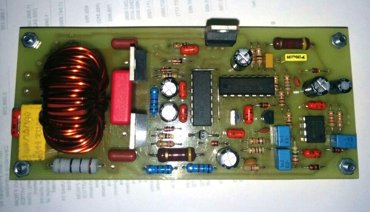

Your PCB is very nice and clean , nice work
the hole of mosfet ouput is ~5mm , be careful because it can break the line of PCB

hello theinchay,
thanks for the reminder.. this is very much noted..

Hello guys my D200 is not wavering, when I turn it just makes an intermittent noise (Tak tak tak) already checked the pcb but do not think what is wrong and am using IRFB4321 gate resistor 22R.
update of may D200, I'm waiting for some part to arrive..
i think you should change the capacitor (0.1 uF - nonpolar) , you should use the MKP or MKT capacitor (or any Metal Film capacitor you have) , if you using this capacitor , it can be damaged even if the rated voltage is not enough.
thanks... thienchay this is noted...
hi , the all nonpolar capacitor should use the Metal Film capacitor, not use ceramic capacitor, because the circuit work at high prequency, so the metal film will work ok , it's the best for class d 🙂 hihi
