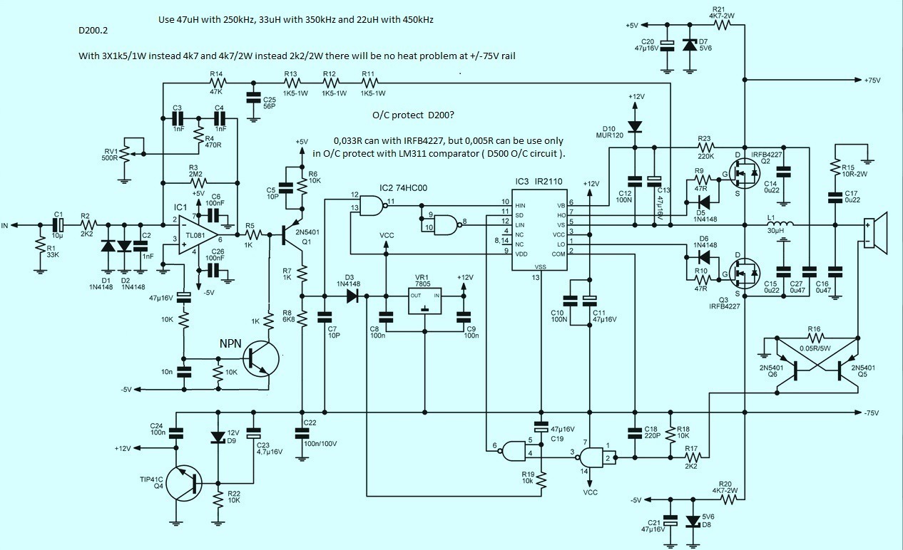

below the measurement of this topology but in russian vvvvvv
  • forum.cxem.net 100_2_.pdf

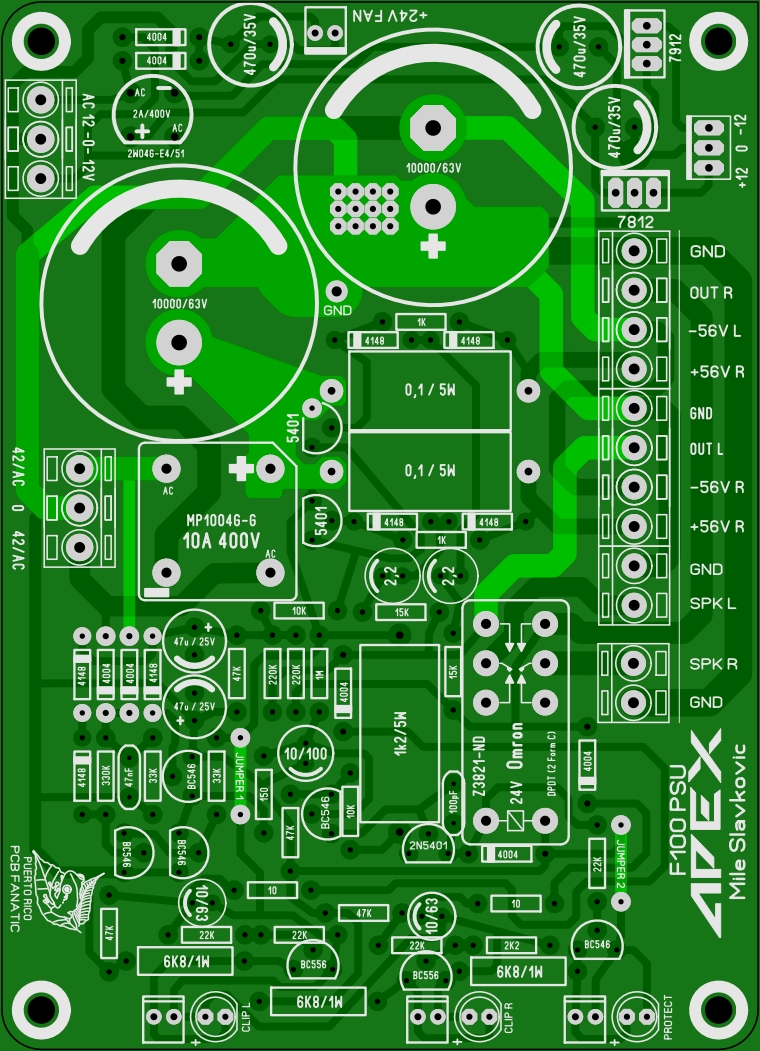

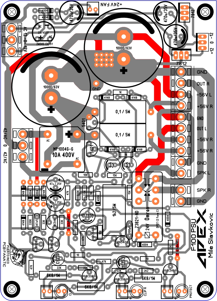

Chingy I know is been a long time, did the power supply works well? I'm doing some cosmetic fix to the layout let me know if the PSU did work well from post #771 :)

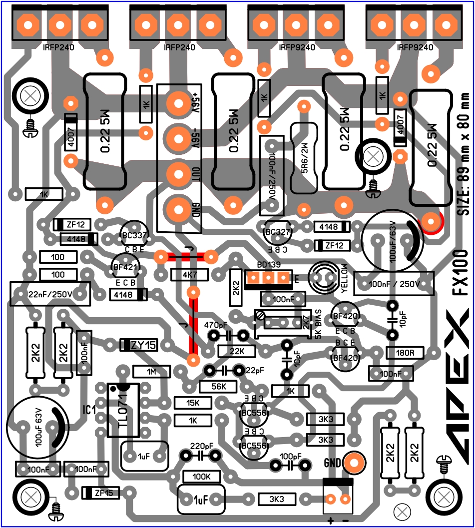

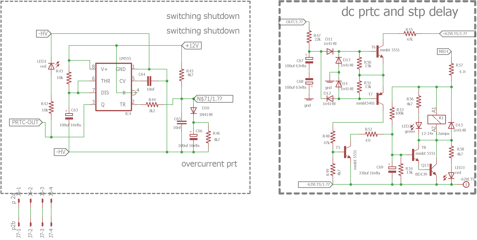

hi all , i am finishing my layout based on tl071 will post development and more pictures as i continue , .
comments and ideas are highly welcomed and appreciated

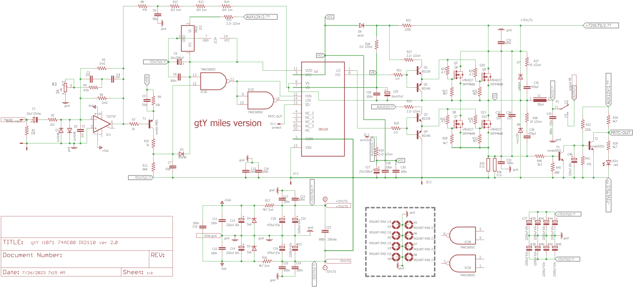

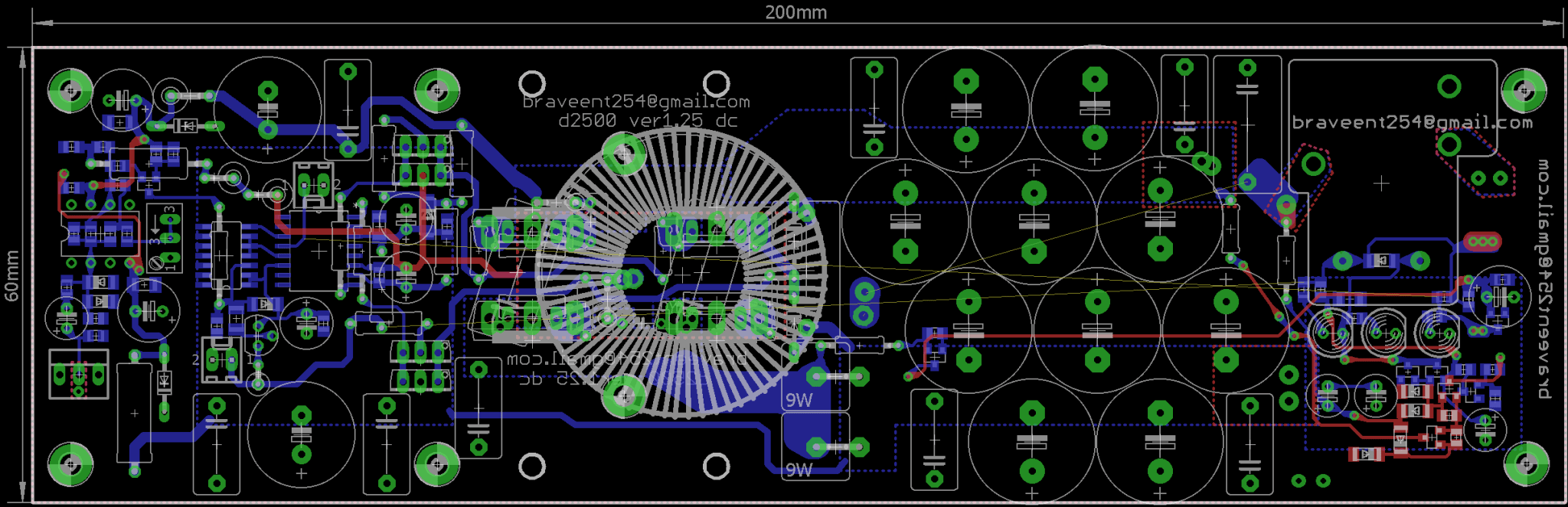

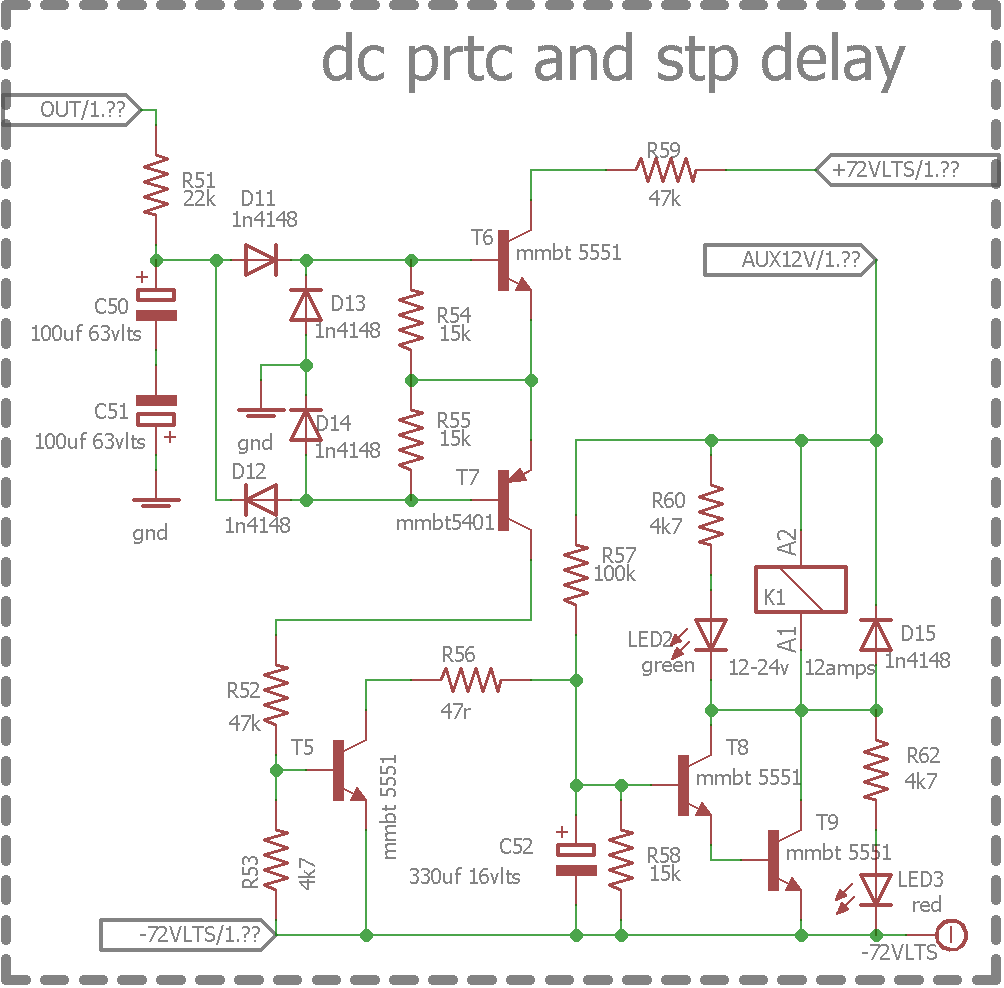

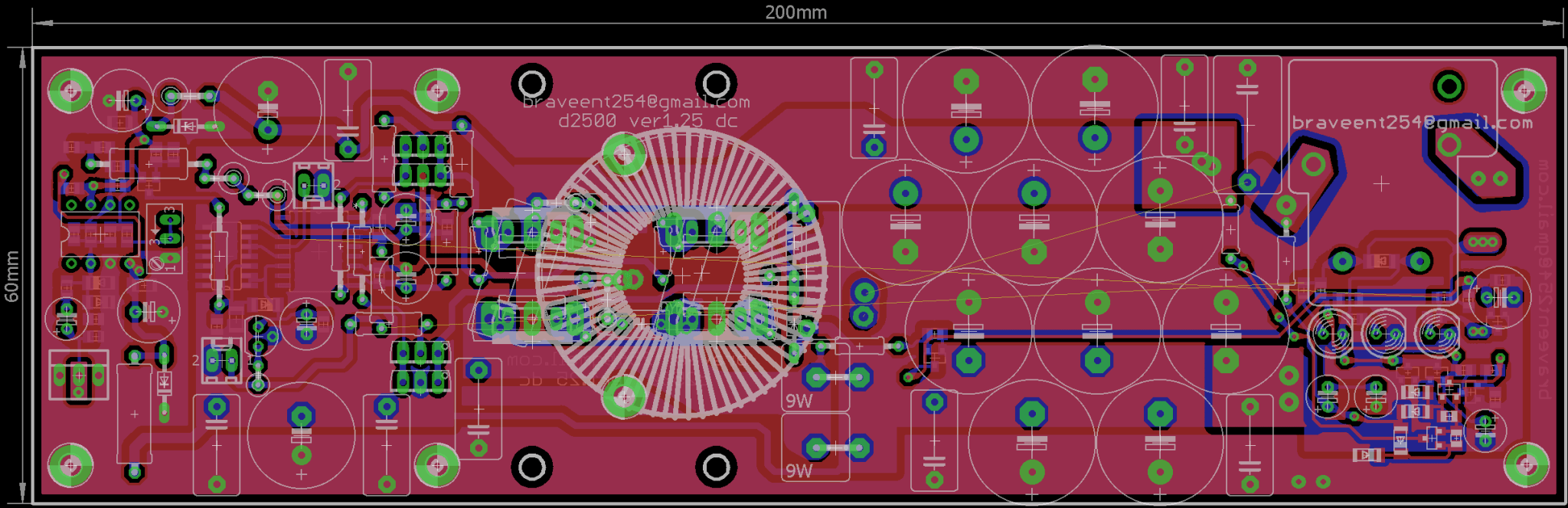

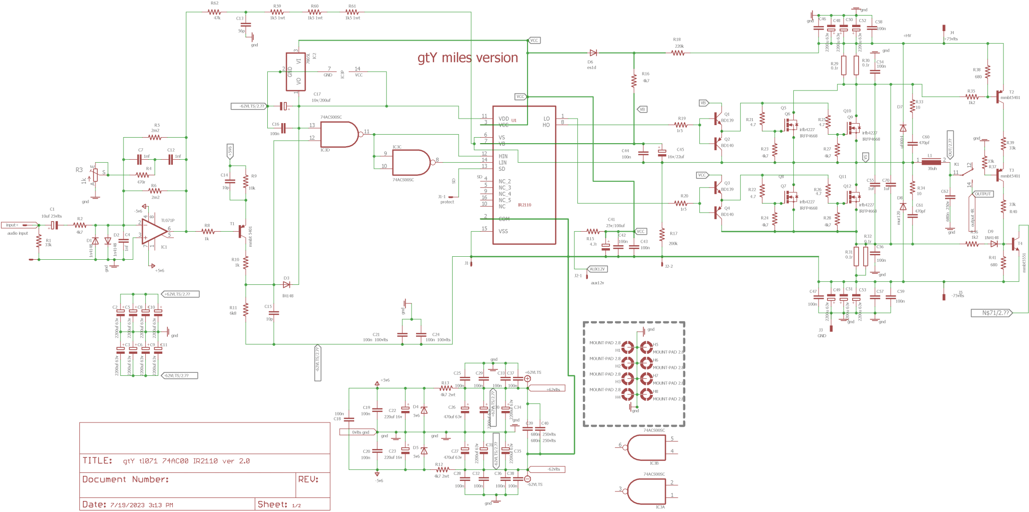

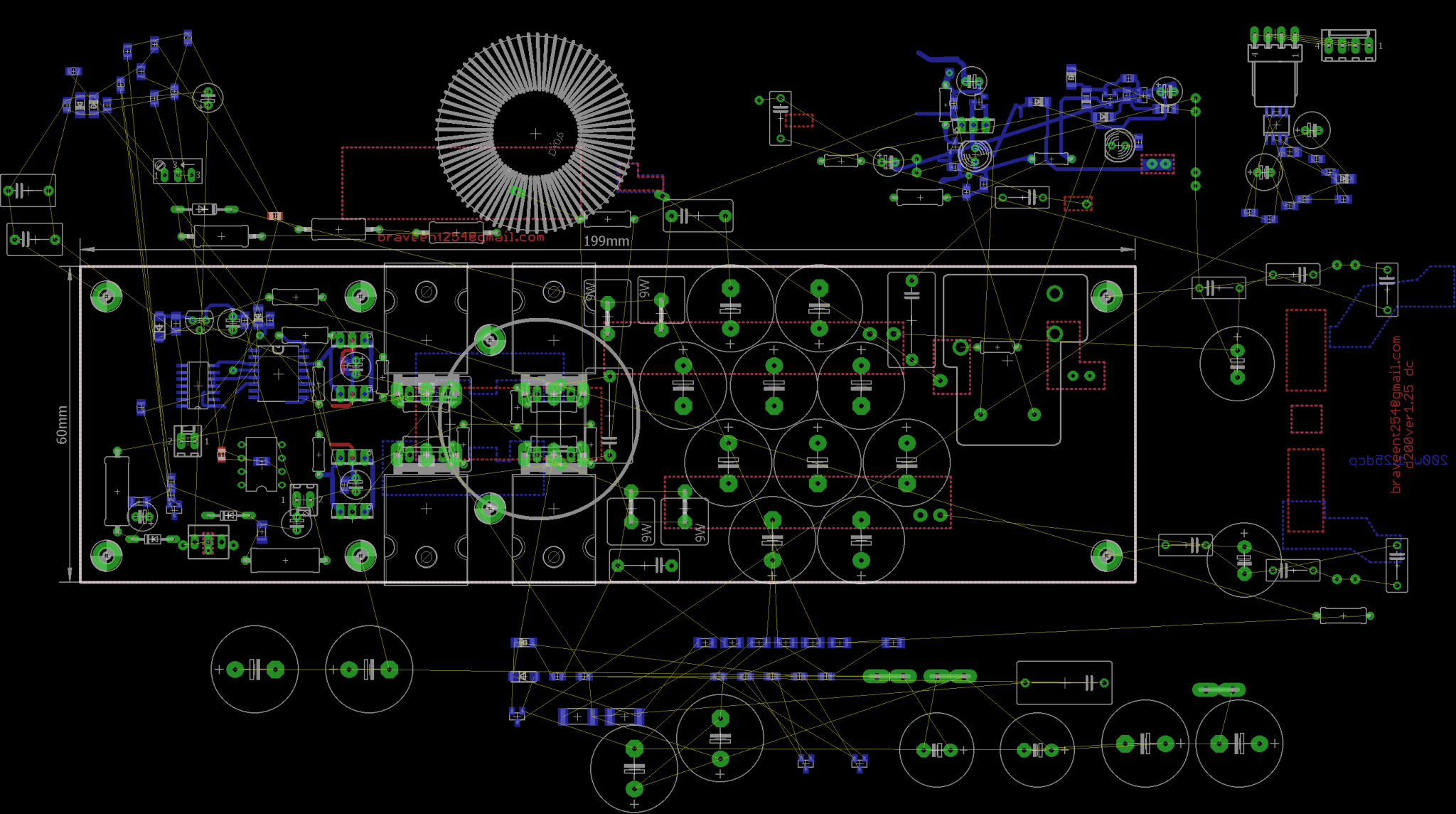

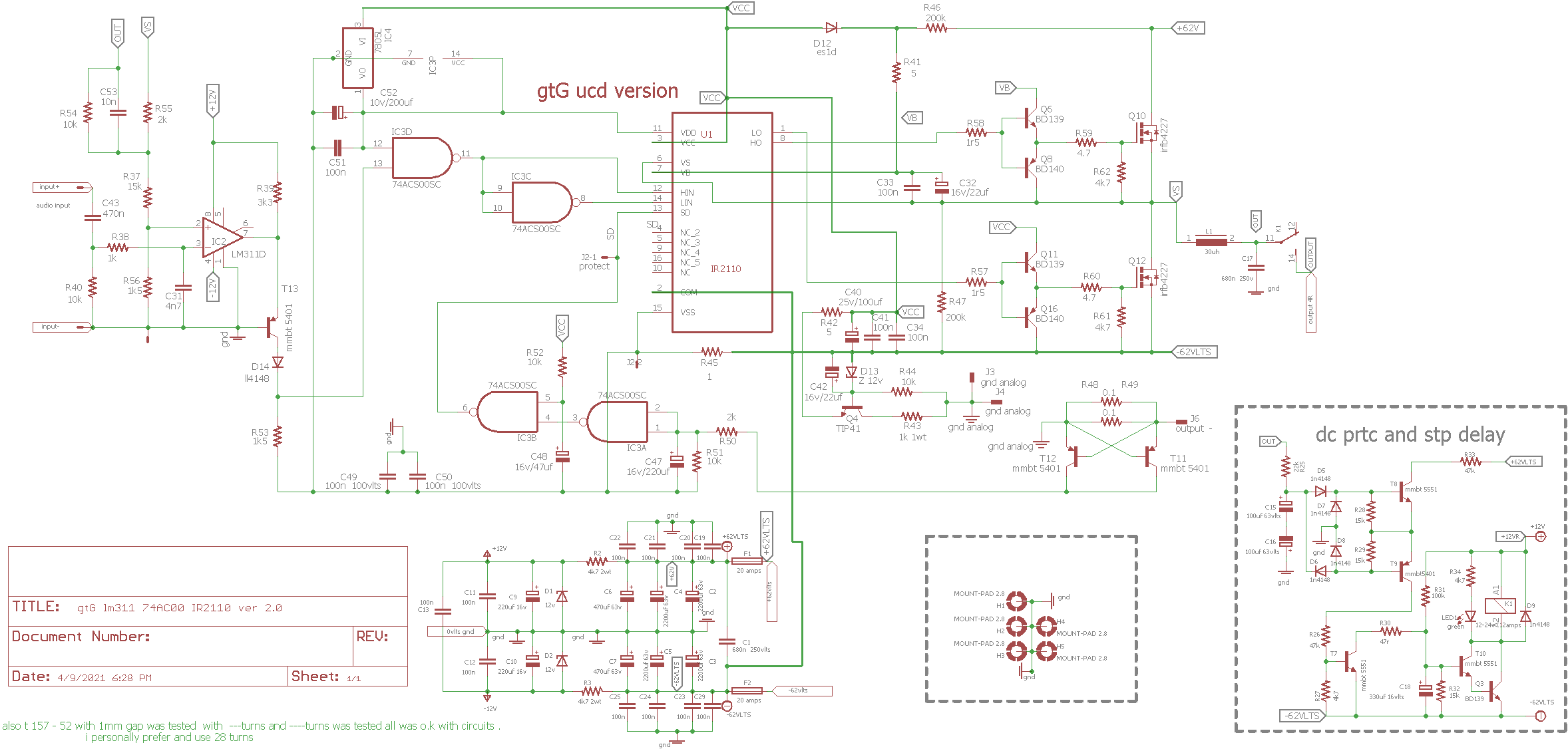

hi all just completed the layout , now its just developing the board :D:D
the files are below have fun all
