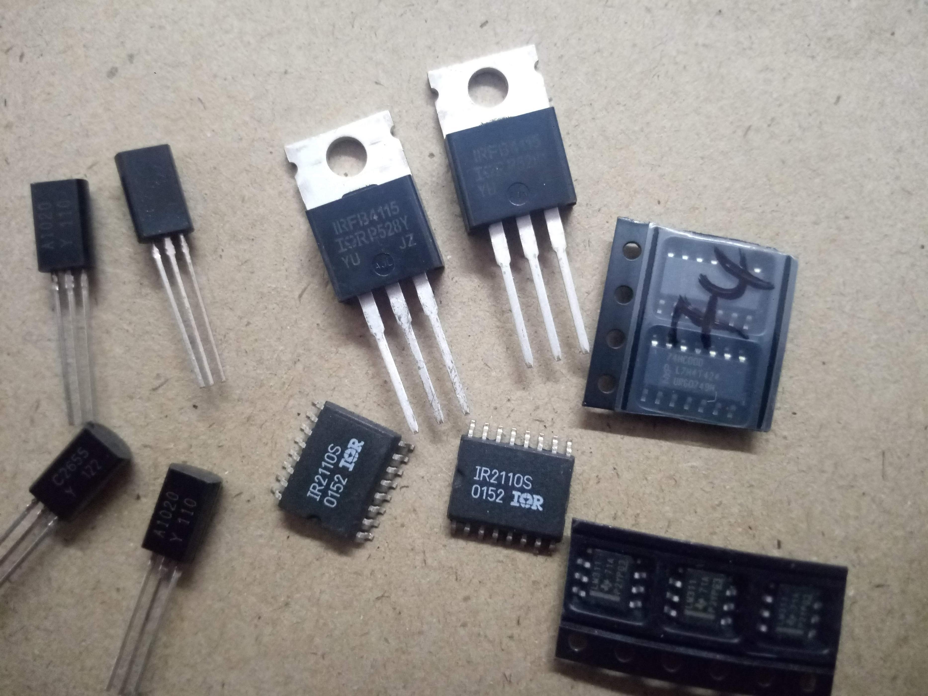

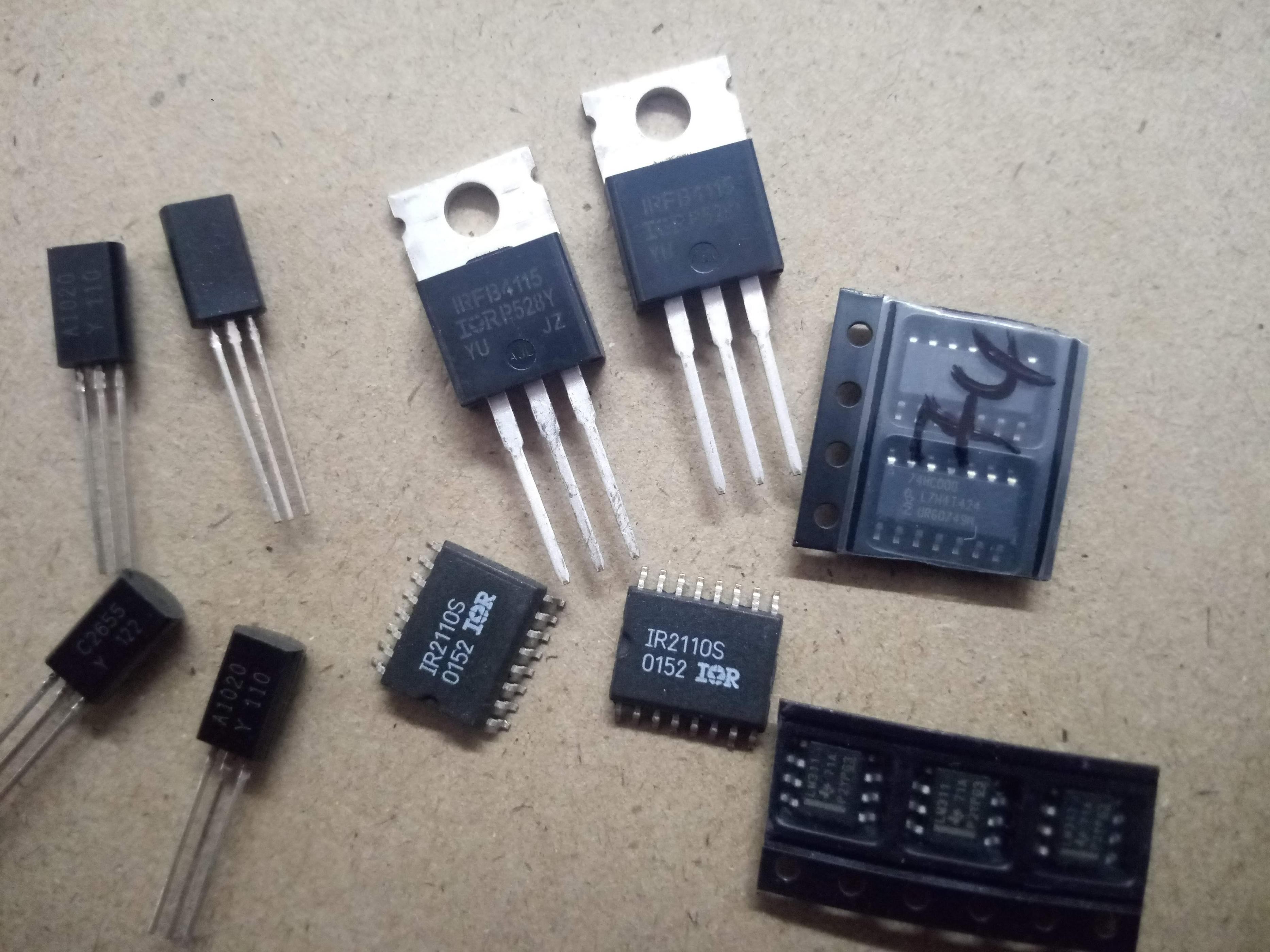

i have lots of iron powder cores t130-10(black core) , retrieved from old big power supply. how many turns do I need to turn to use them in this amp, also do I need to cut a gap in the core ?😕
I plan to use with irfb42227 +/-75vlts at 2ohms load

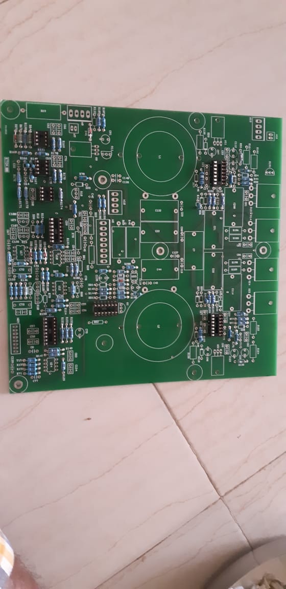

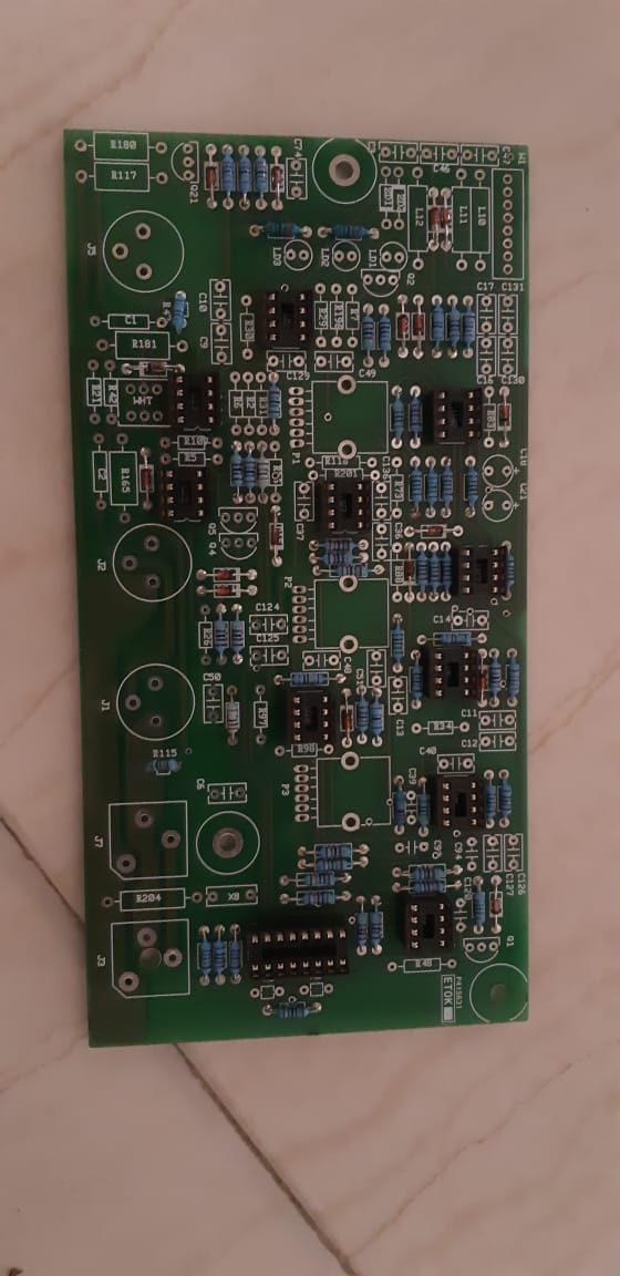

hi overpower
thanks so much for the reply . let me implement and i will post results and pics of my layout . i am going the smd way .i will not be using th components but smd
IGBT DCLASS
PCBs have come to try APEX AUDIO D2000
warm regards
Andrew😉😉😉

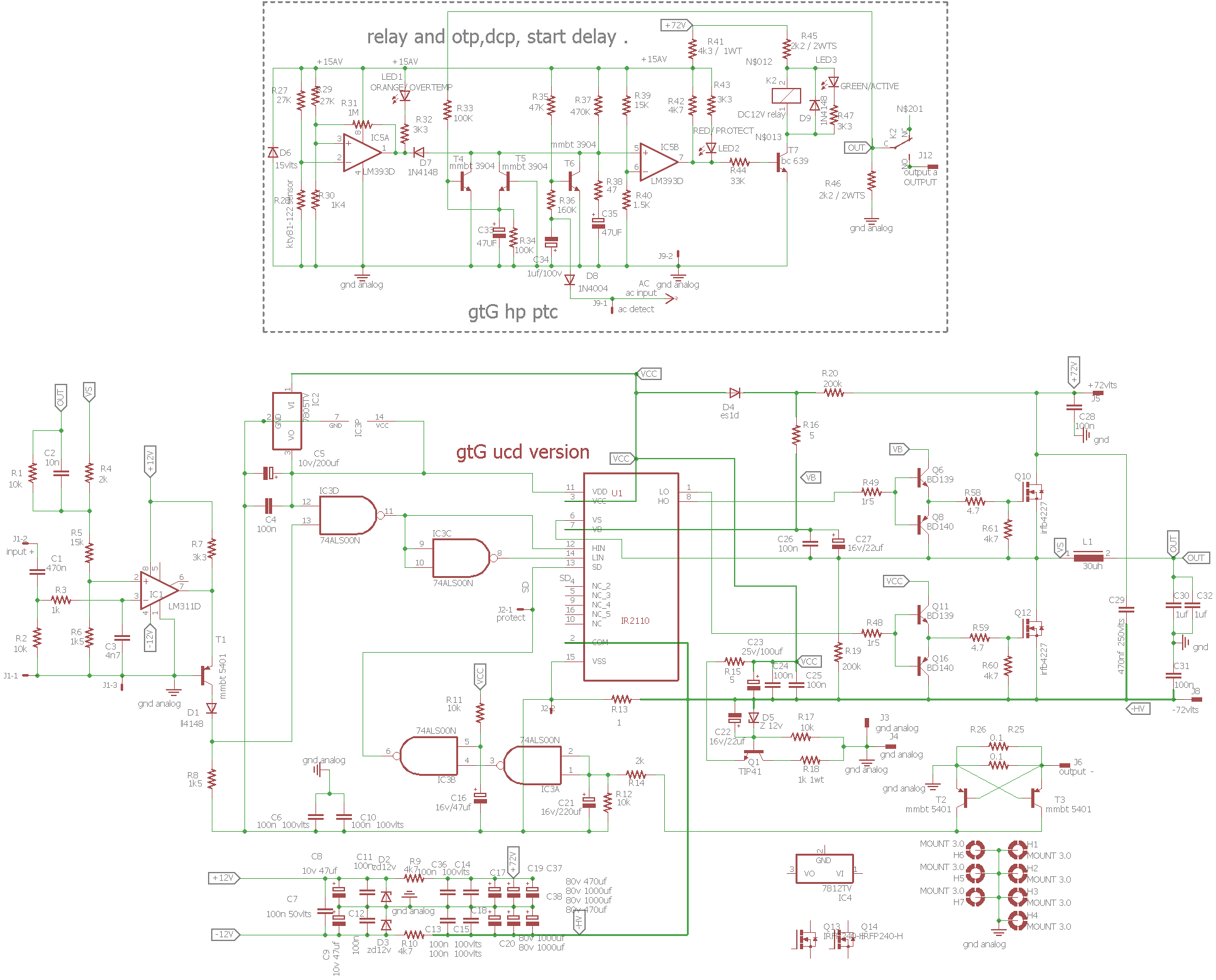

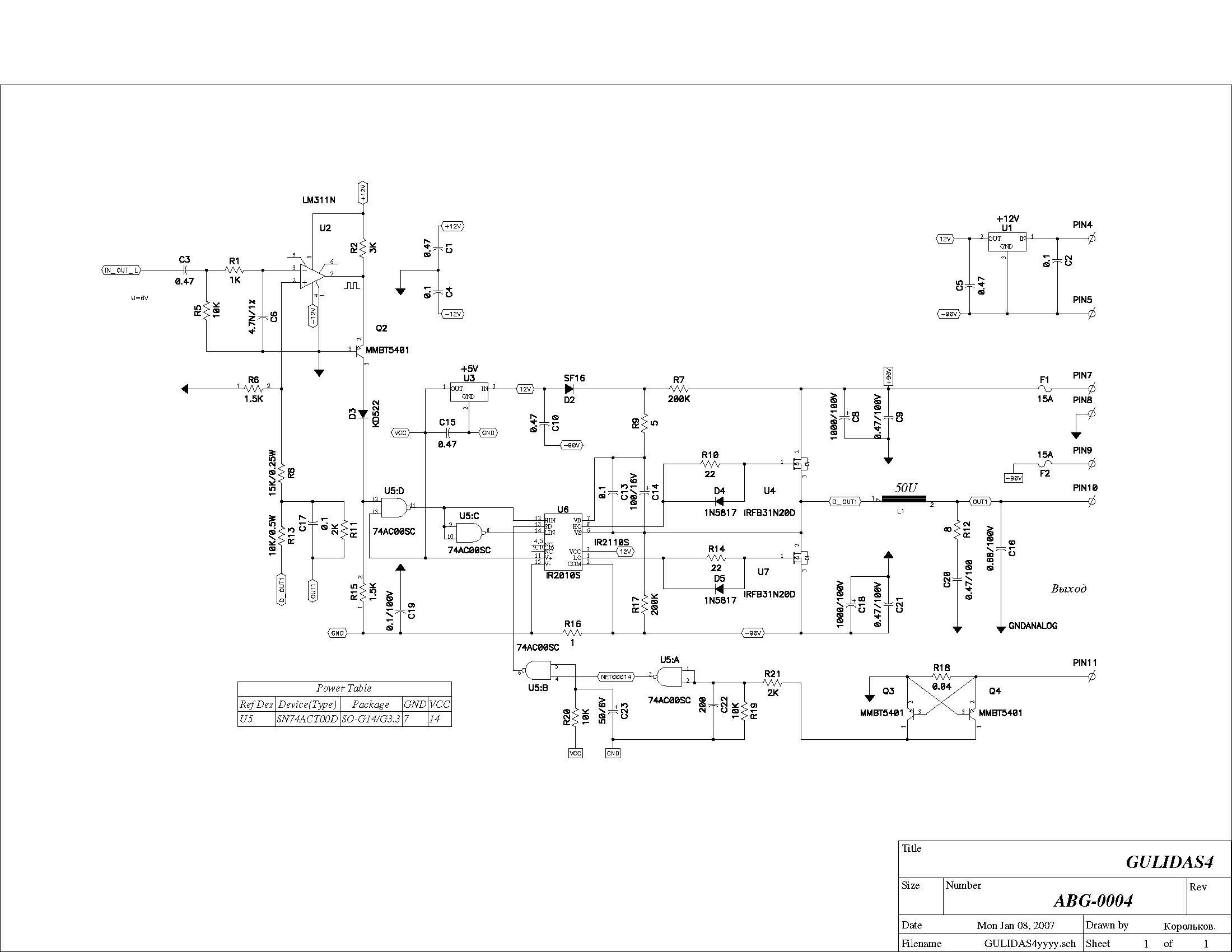

all smd parts ready , want to try out this amp but the lm311 version
i prefer lm311 over the tl071/081 . also i have added a buffer to drive the fets so as to ease the load on the ir2110chip
any opinions and ideas are highly appreciated
  • gtG lm311 74AC00 IR2110 ver 1.8 schematic.pdf
