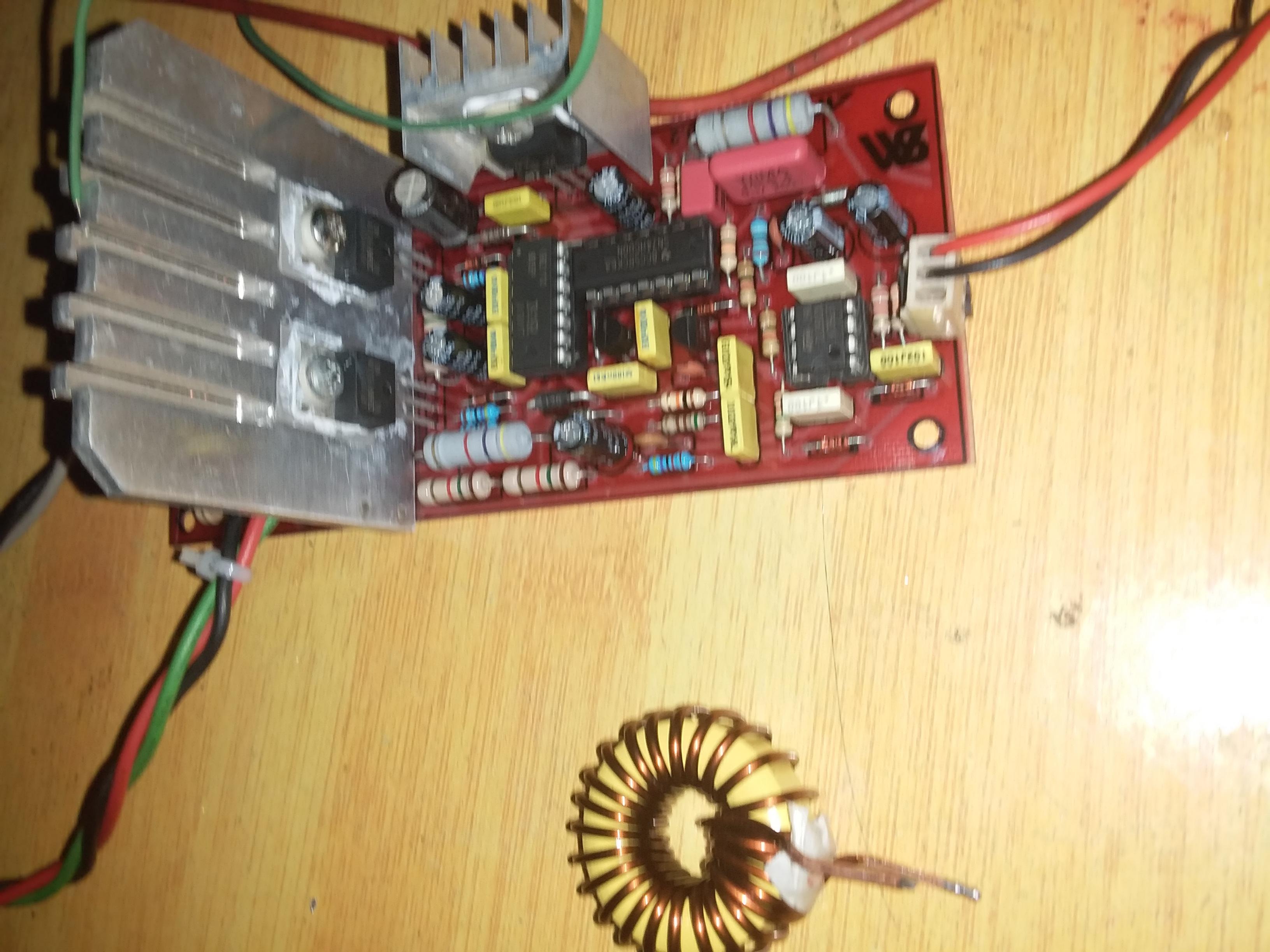

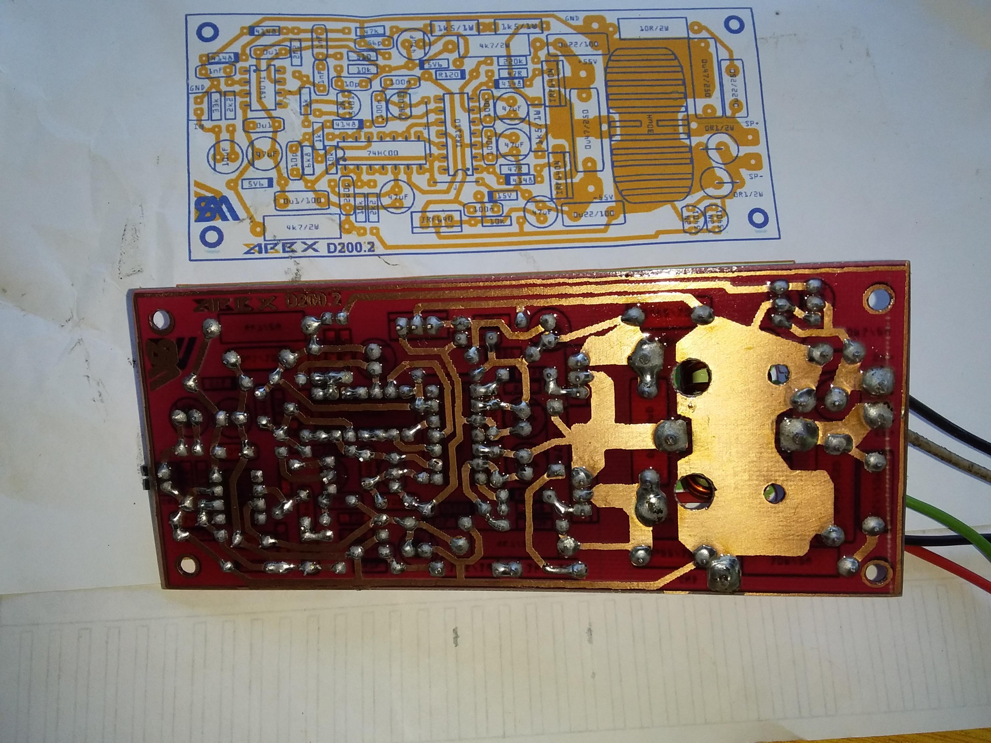

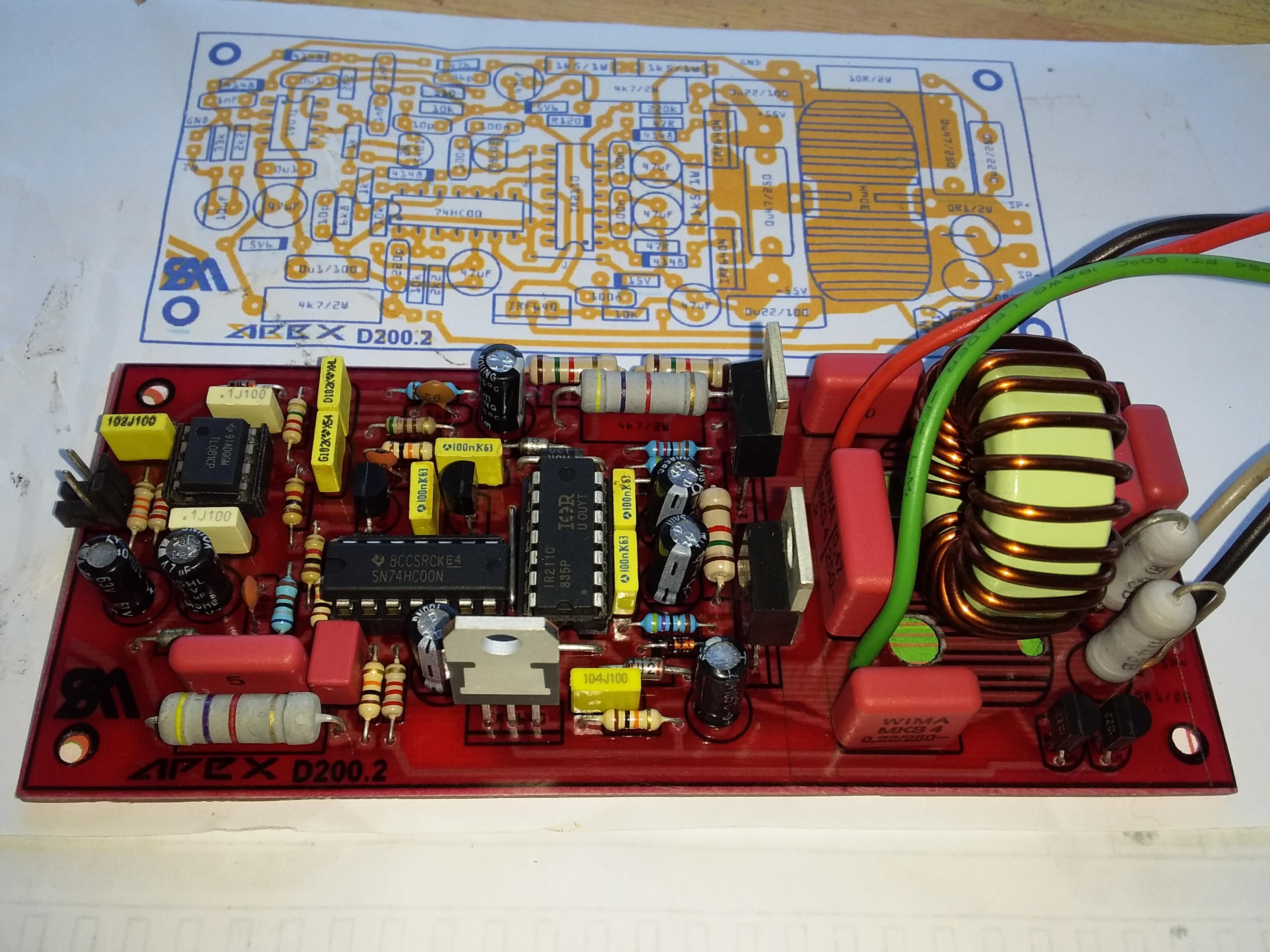

hi there i had my D200.2
it work after several tries... i had notice some problem when i turn the volume higher at about 25VAC on output it "ploops" a big DC voltage more likely about 2-3VDC. does anybody had the same problem or knew the root of such problem please help me out...thank you sir mile and others i've got my first class D amp.
regards
SAM

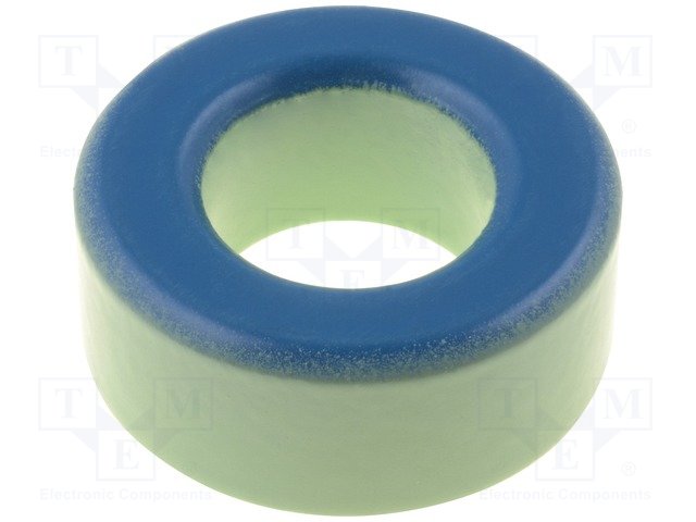

Core material?

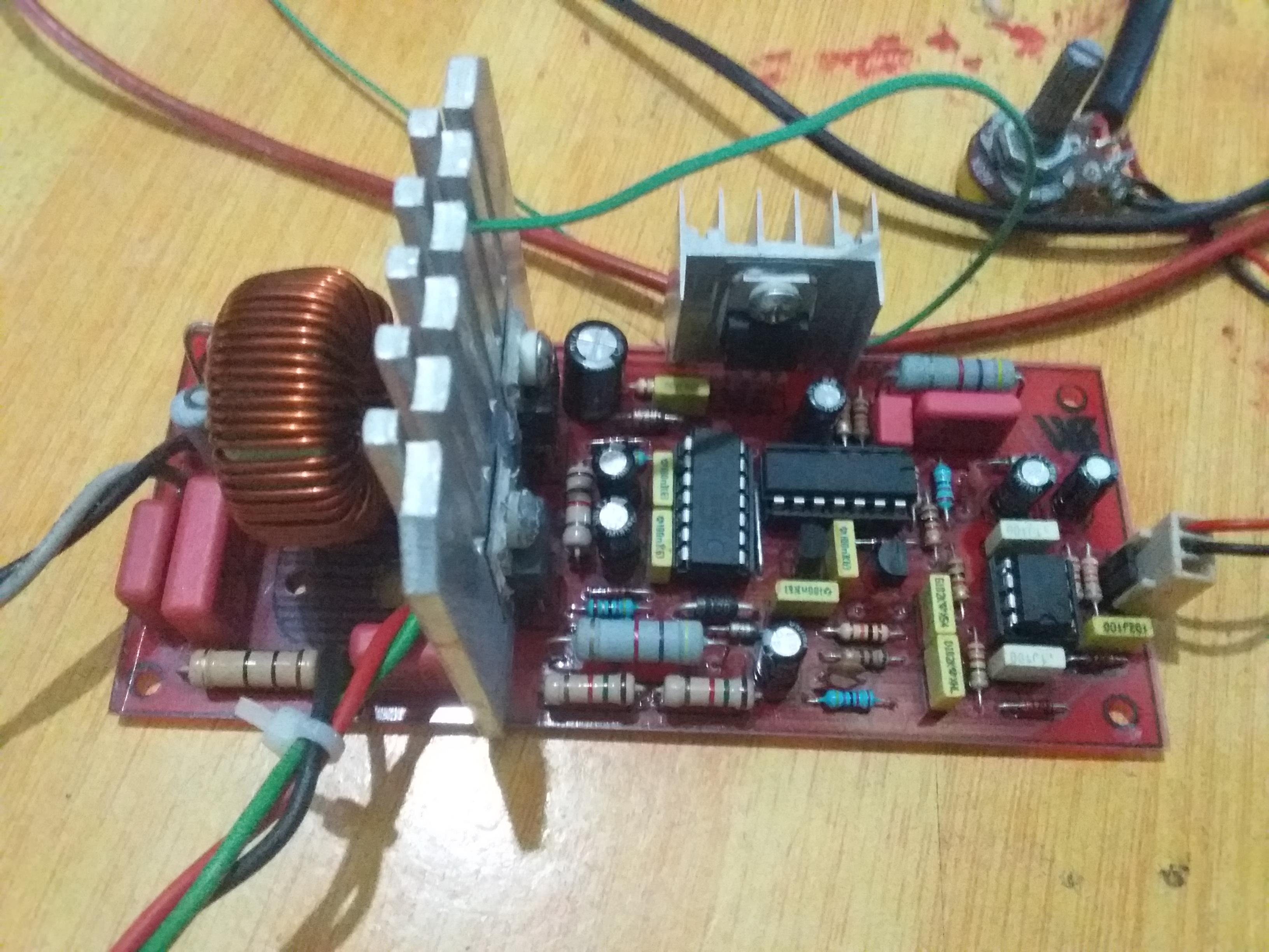

D200.2
i have tried several but most of them heated up...
the one that has tolerable temperature was same size as T106- i took it from salvaged HP ATX PSU color green/blue with 62turns of #18AWG magnet wire
thank you sir mile,
sam

Hi
i think this core is working in 350KHZ in original type

i tried to upload the file, in the video was SMPS. that problem at the end of the video exists even on torroid or other PSU tests...
on the pictures were sample of core i used.

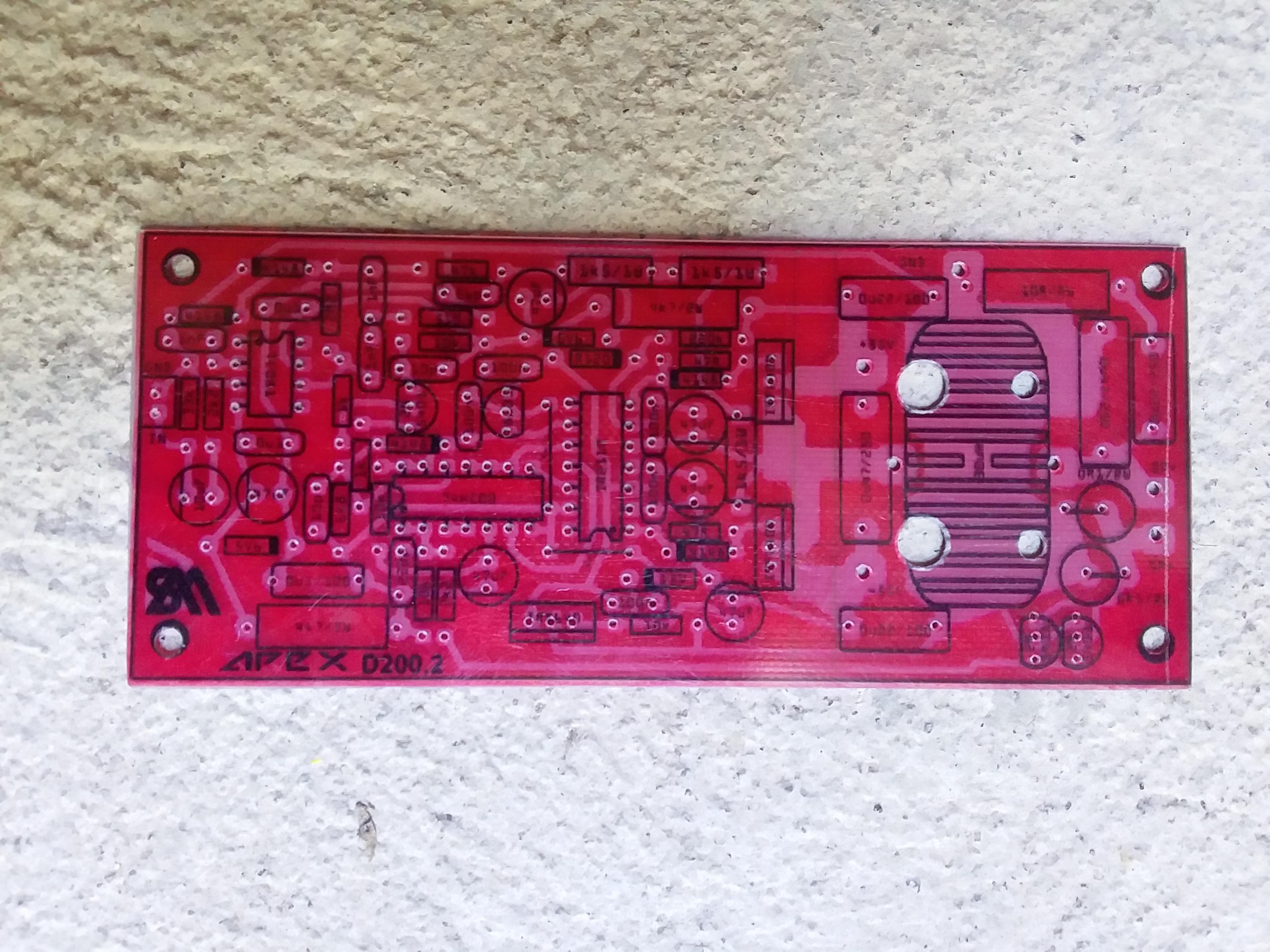

1. nobody share Gerber Files for order PCB online

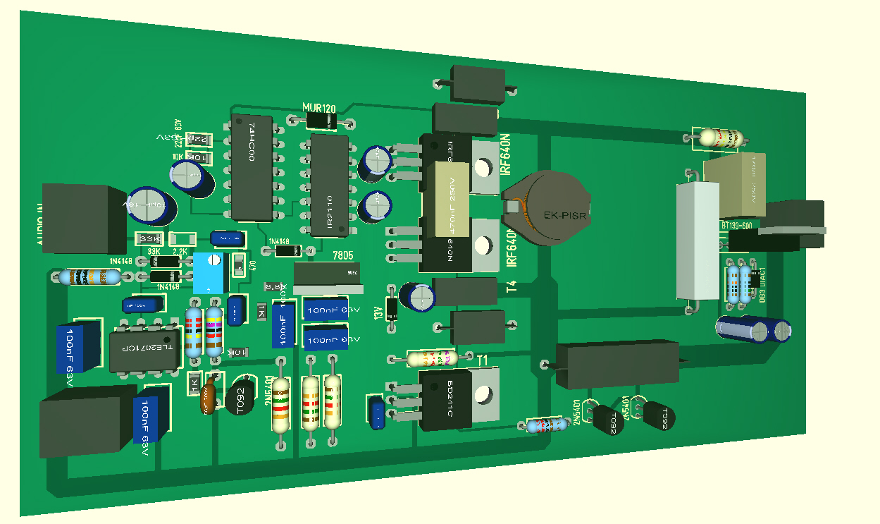

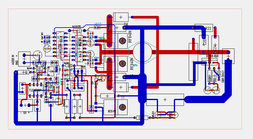

Last week I was off had much time,....this is the reason I have spend time to make new D200 PCB with much SMD components
have a look @ PCB before I will finished
have add Load resistor and flyback diodes MUR460 from output to + / - rail if the amp clips

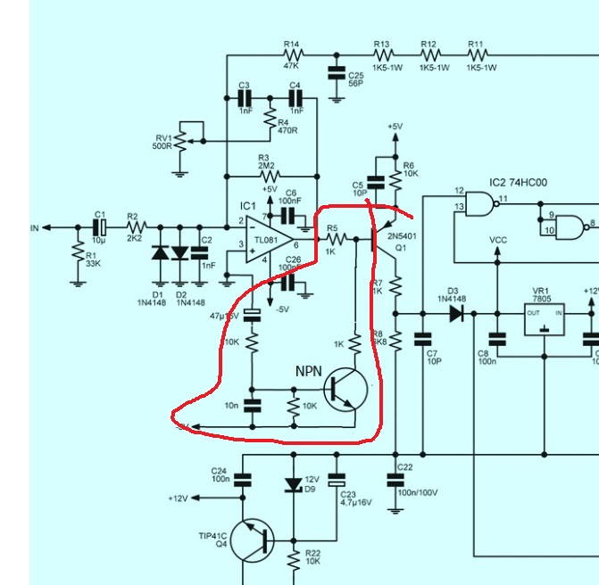

2. APEX add some extension in D200 schematic red marked,
additional NPN resistor, capacitor and negative - 5V
does somebody add and test it ?
I cant fine any DIY Members report, who have build D200 with this extension

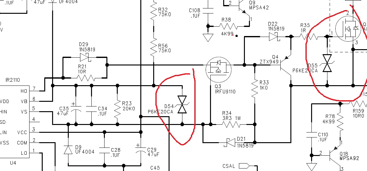

Crest Add at IR2110 between VB / VS and Mosfet Gate
Bi-directional P6KE20CA
Transient Voltage Suppression Diodes
"The P6KE Series is designed specifically to protect
sensitive electronic equipment from voltage transients "
Is it worth to add this ?
look red marked PIC at D200 ?

hello mr.
people here might be busy then we have to wait for some response.
yes w/o diode i observed 4VDC on output you need to put load to make it work.
neither am i was not an electronic too.
with +/- 45VDC i barely got 100watts 4R load before the relay on speaker protect activated
that 100watts was enough for home use though.
yes it does not solve the problem coz it will still spikes DC at high volume...
