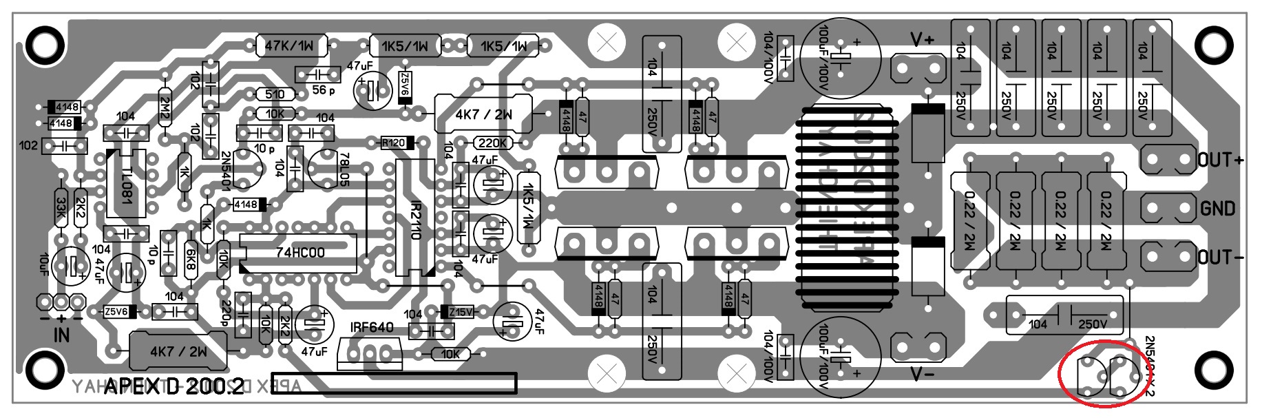

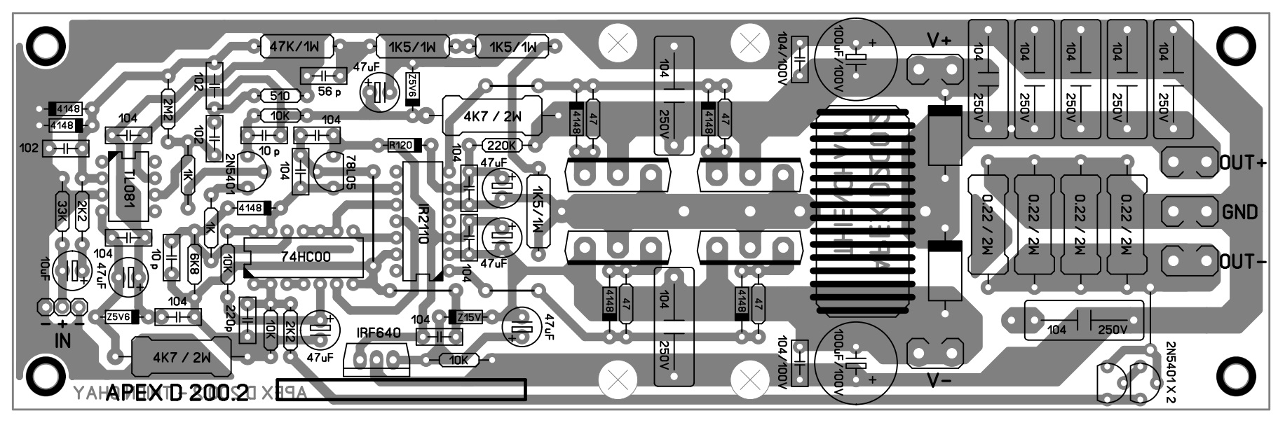

Apex D200 V2 ,,,
Hi QQ12e5k1,
Looks like the component side is not matching,, Pls check the PCB.

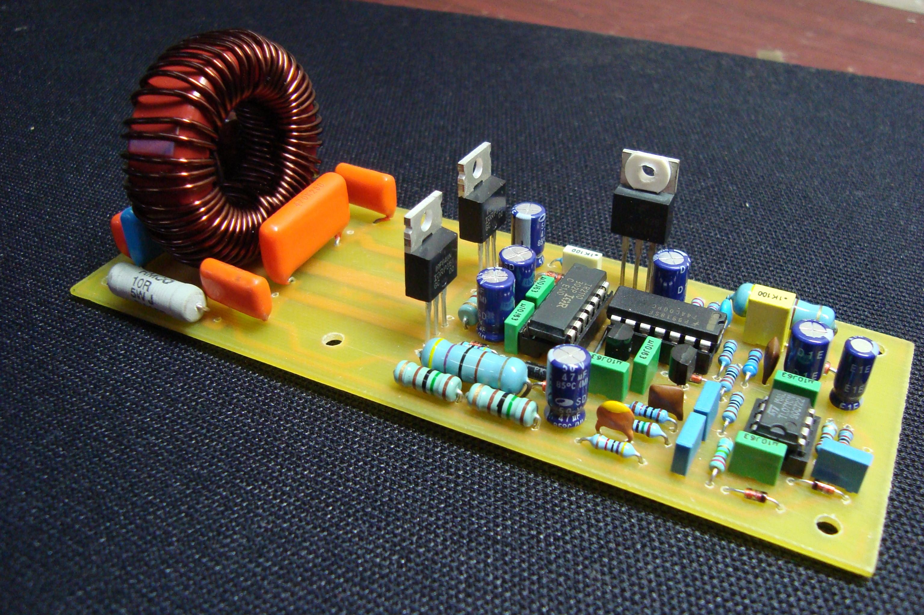

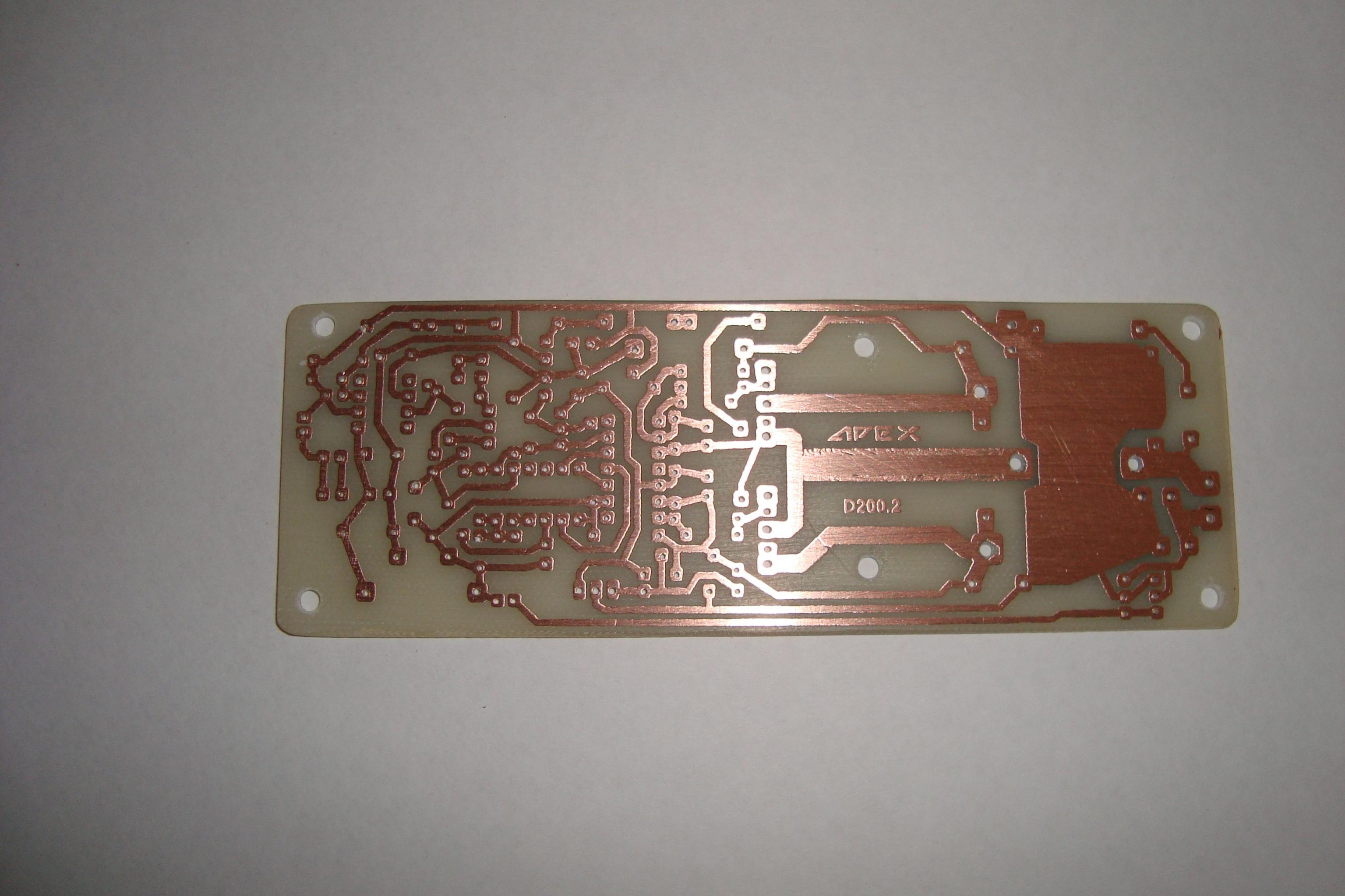

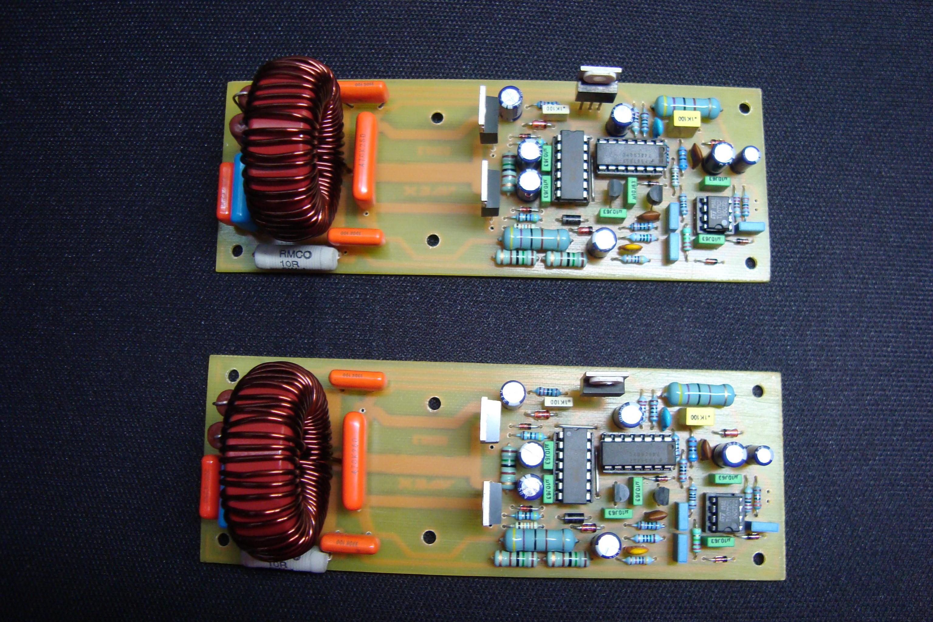

Apex D200.2 !!!
Mr.Mile,
Please find the amp assembled with Irf640n,Later will change with IRFB4227 ,,😉 will test initially with +/-45v ,
I would like to work this amp with +/-75v for subwoofer.😀
output is 30.5 uh with T157-2,

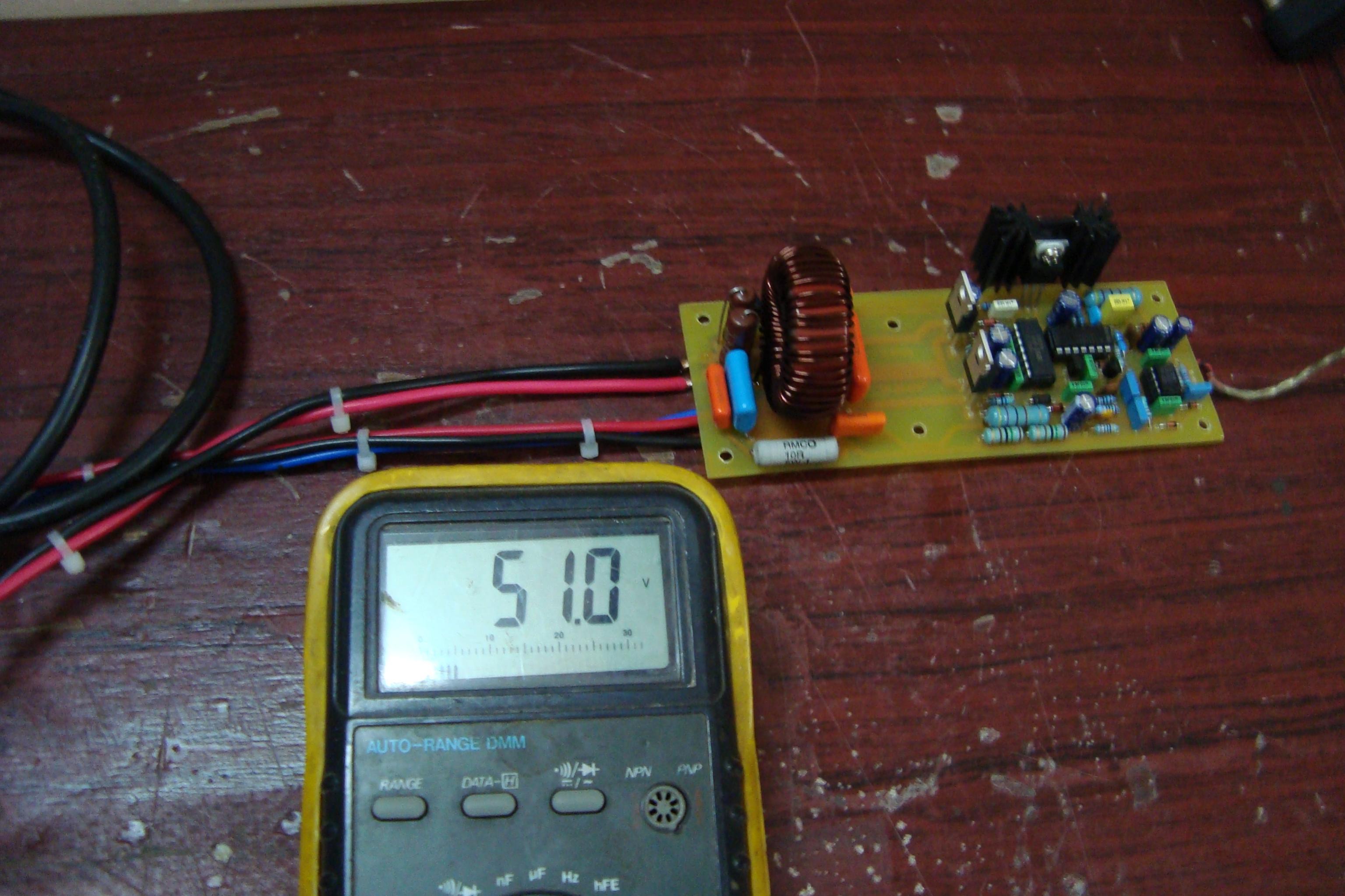

Mr.Mile,
No Offset voltage when connected to load, fed the music signal ,but no O/P was present,Absolutely silent..😕 no hiss or hum,
No smoke, none of the components got warm,
O/P dc Offset -- 1mv
power supply was +/-51v.

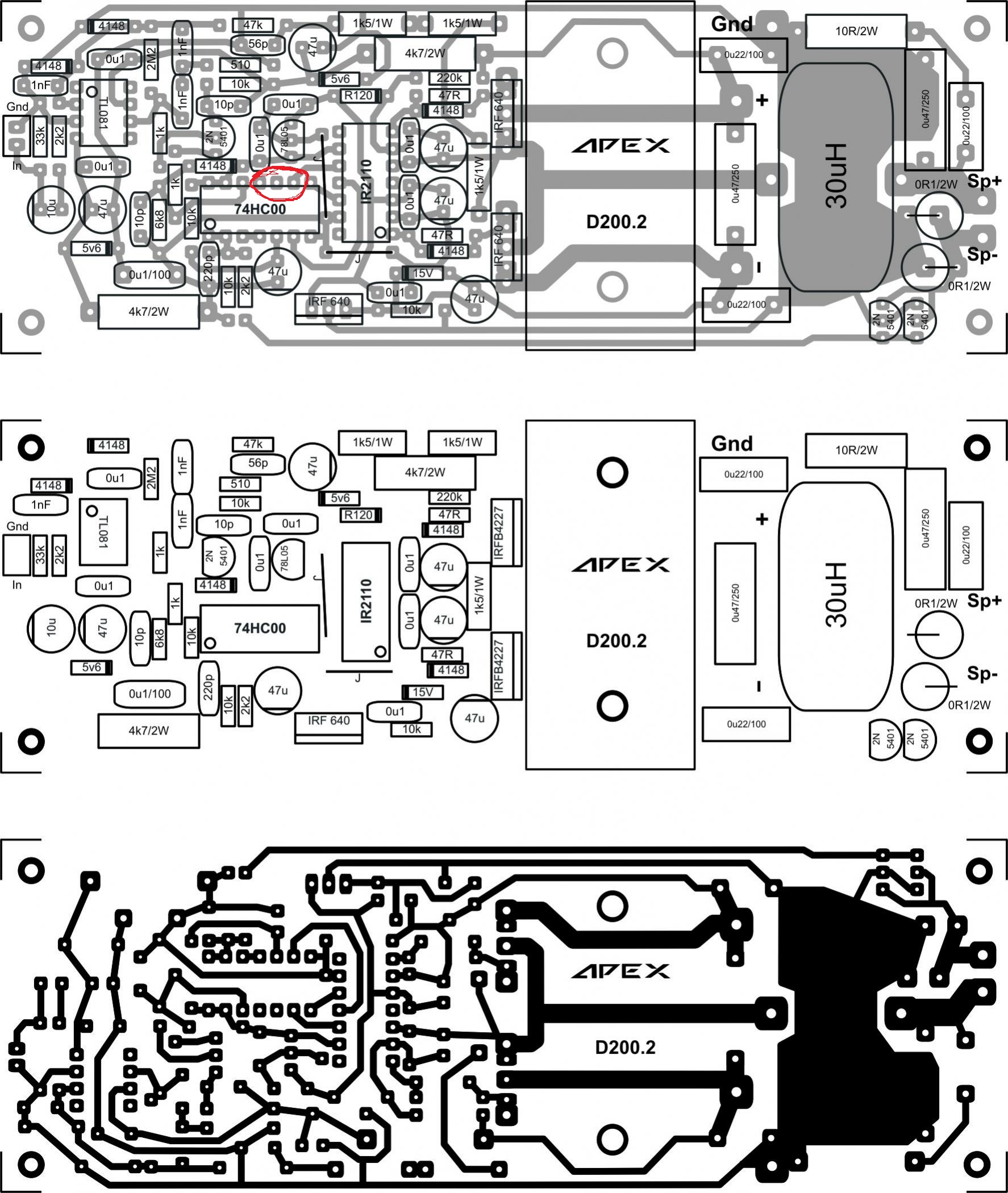

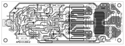

i've redraw the PCB for my heatsink and i thinks it not bad
But i don't have any Schematic of this , so may i had some mistake , please check for any problem on my PCB.
I still looking for the final schematic of this amp , please post this here , thanks so much .

Finally my amp worked,😀,, The problem was 74Hc00 pin 9,10,11 was not shorted in the PCB.
There was quite a Distorted O/P,,
Had replaced bias ckt with IRF640n and 15v zener, Then upon changing back to BD241 with 12v zener sound was clean without distortion.
Have replaced the mosfets with IRFB4227, the -ve side Mosfet warms up quite a bit, the other Mosfet is cooler,,,😕, is this normal,,
power supply checked with +/- 48v.

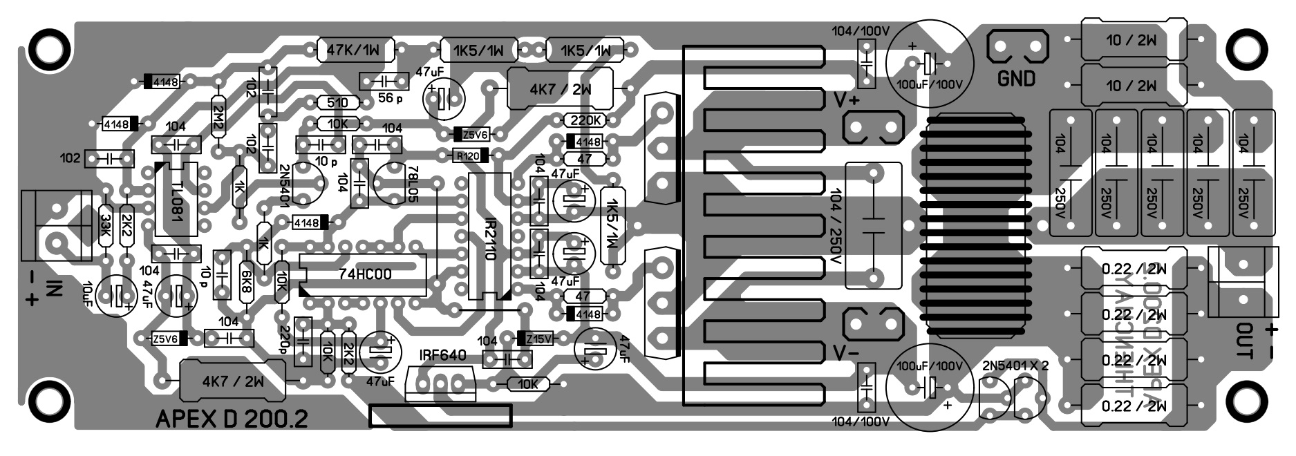

hi thienchay have you managed to test your design? pls post pcb files

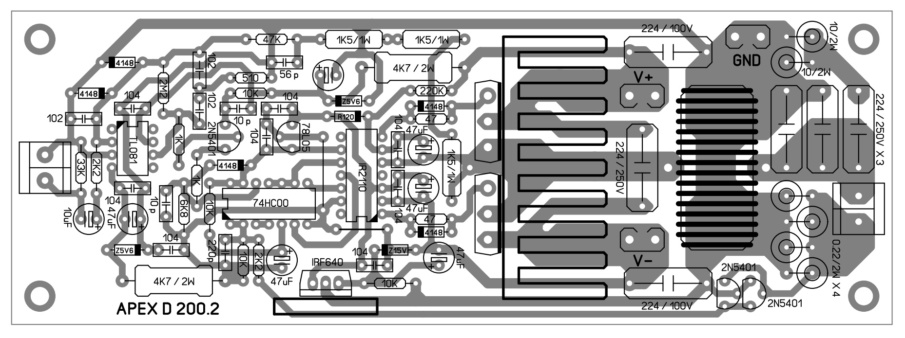

This my last version PCB , i've added some capacitor in power supply port, and more space for more capacitor in output , i think more capacitor parallel is better , and easy for find .
This my PDF file , print 100% in A4 .
Thanks .
